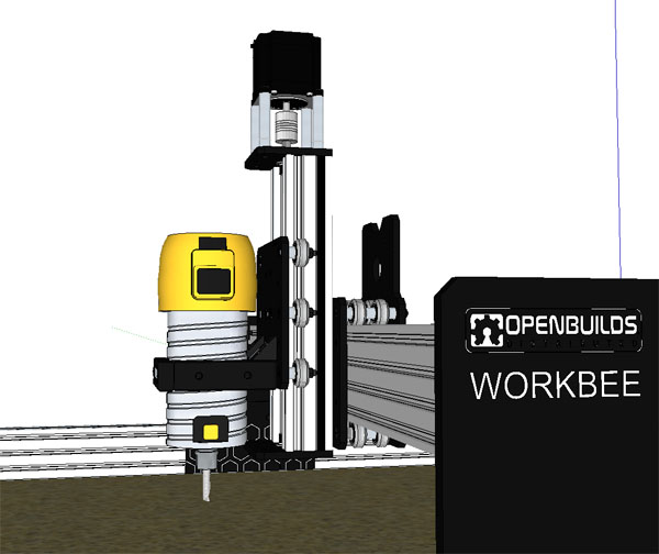

    Hi Community
    Based on the workbee kit ( from ozznest or openbuilds), I'm looking for ideas to increase the Z-axis cut depth and after reading some section of the forum I found two solutions.
    One is shared on a nice build done here: https://openbuilds.com/builds/workbee-cnc-build-my-honest-opinion-tips-and-help.6407
    Other options that I found is add a taller plates like this ones :
    WorkBee CNC 1" Taller Deluxe Y Side plates (seen at Openbuilds) | eBay
    "In addition to giving 1" / ( 25,4 mm) more Z travel " based on the description.
    So please in case someone have extra ideas will be great to see them.
    My objective is to reach the minimum of 6 to 8cm depth + the waste board. Im going to work with pieces longer then the machine, something like :
    However I want to keep the rigidity of the machine without changing so much the kit...adding the taller plates looks the more logic, however I'm open to suggestions.
    Thank you all

  2. Rick 2.0
    2,887
    1,543
    Based on using the US version of the Workbee 1010 which has about 86mm clearance in the stock build all you would really need to do is turn the Z-axis around, fixing the Z-axis C-beam to the X-axis gantry plate and mounting the router mount to the Z-axis plate which will now run up and down on the fixed Z-axis rail. You will probably also need to trim the bearing plate at the bottom of the axis to where the router will clear. Reference file attached.
    If you were wanting to go with the US version of the 1510, merely build the base low profile similar to the 1010 and go with the reversed Z-axis suggestion above.

  4. Rick 2.0
    2,887
    1,543
    Not yet but I'm considering modding my Ox to include it. The idea has been floating around the forum for quite some time regarding the best way to increase working depth. (One previous thread here.) While the method has its limitations it is a far better approach as it induces less leverage on the system than jacking the X-axis up and then having to reach back down to the work piece. Less leverage means less overall flex in the system and more accurate cuts.
    The only other suggestion I would offer would be to add a second spindle mounting ring just below the plastic spindle top to help stabilize the router. I'm not really a big fan of extending the router that far down in the mount but in your case it is necessary to achieve the depth required.

  7. Metalguru
    Metalguru Veteran
    Dec 29, 2015
    752
    547
    Rick:
    It's easy to add a second router mount to the Z axis to stiffen things up, particularly when you have a router with a long body like the Dewalt or the Makita. You may not be able to put all 4 angle brackets on the second mount because of space limitations, but the router body ties them together pretty well.
    I took a second look at your modification for the Z axis, and I'm not sure how that would give any significant increase in travel? The router mount plate still only moves the same amount either way... About the length of the C-beam - the length of the plate. How is this any different from the original? I do see where you could adjust the Z axis position by moving the c-beam up and down, but you'd have to disassemble the whole X axis to make this adjustment...
    MG
  8. Rick 2.0
    2,887
    1,543
    MG,
    The issue is the extension of the bit below the bottom axis plate. With a fixed spindle on a moving axis, if you have say 3" clear beneath the bottom axis plate but the extension of the bit is fixed 1 1/2" below the plate you really only have 1 1/2" of working depth (motion) remaining. On a fixed axis/moving spindle system, the bit can be fully retracted above the bottom of the lower axis plate to where you can effectively use the full 3". Obviously there are limitations to this, mainly that you can't cut any deeper than the length of the bit. But if you're cutting 3" foam with a 3" bit you can get away with having only a 3" throat on a moving spindle system. On a moving axis system this jumps to 6" due to the loss from the fixed bit extending into the throat.
  9. Metalguru
    Metalguru Veteran
    Dec 29, 2015
    752
    547
    I'm still not getting how this improves anything. Since, in either case, your cutting depth is limited to the length of the bit, that's as deep as you can go, period. Reversing the Axis to the "moving spindle" configuration gains you some height for the work underneath the Z axis but you still only get the length of the bit for effective travel.
    The way you have it shown in the model above, I doubt that most bits would even be able to reach the table to make through cuts. I've never seen a 3" long 1/4" router bit, they may exist but they are going to be very expensive, and very fragile. I suppose you can change the mounting height of the router, but this only changes the absolute height, not the travel.
    Also, there are no holes on the Workbee front X axis plate that line up with a c-beam for mounting purposes, so you would have to modify or make a new plate to do this modification. This is another reason that I advocate using the C-Beam XL plates for the Workbee X/Z axis, it makes it so much easier to modify things, and the loss of one pair of wheels on the top makes little difference in rigidity.
    MG

  11. Rick 2.0
    2,887
    1,543
    MG,
    You've entirely missed the point here....
    It's not about using 3" bits. It's not about reaching all the way down to the bed. It's not about whether or not the plates have the correct holes in them. It's about maximizing throat depth while minimizing leverage on the system.
    The concept shines in a number of areas. When applied to the original ox it allows for cutting 1 1/2" stock rather than just 3/4" stock without jacking up the x axis and inducing more flex into the system. It allows more room for using vises and heavier jigs to hold stock. In that the bit fully retracts above the lower Z-axis plate, materials can be set just a hair below the axis plate reducing the lateral leverage causing flexure in the system. This can make a substantial difference when cutting metals because you're using the machine at its stiffest. As far as plates not having the necessary holes, I'm not a purist. I consider any system from OpenBuilds to be nothing more than a starting point and will alter it in any way necessary to turn it into I feel it needs to be. While I understand your issues with this as a commercial system builder, you're in the minority here. Most are building one-offs and take no issue doing what's necessary to achieve the best possible system for their needs.
    And no, I would never use a 3" bit. They're not stiff enough for cutting anything more substantial than foam, are hard on the spindle bearings, and they exaggerate runout. But this method will allow you to cut a 2 1/2" deep bowl in 3" thick wood with only a 1 1/2" bit extension. Can't do that with a plunging-Z without jacking the X-axis way up to accommodate shifting the spindle farther down.
