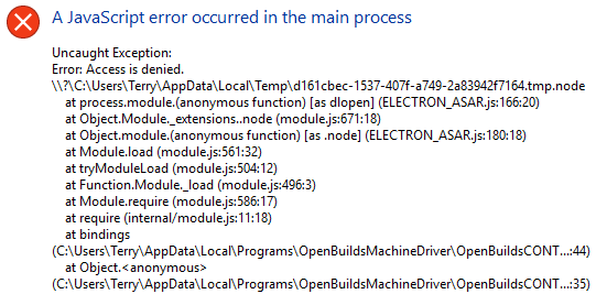

    At a loss, I've tried searching the forums but wasn't able to come across anything for this issue:
  2. Xlcacer
    Xlcacer New
    Oct 31, 2017
    I am just trying to access Open Builds Control from Windows 10
  3. Peter Van Der Walt
    14,571
    4,230
    Some local firewall, antivirus, antimalware or similar appears to be interfering. Bypass or allow by adding an exception to in whatever firewall/antivirus/antimalware you are running

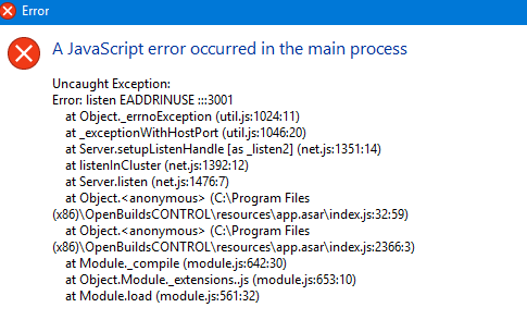

  9. Xlcacer
    Xlcacer New
    Oct 31, 2017
    Using Windows Defender- turned off Anti Virus and Firewall with same results. When I run as admin, i get his error:
    UGS worked but I would prefer to use this. Java is up to date. ???? Help
  10. Peter Van Der Walt
    14,571
    4,230
    Error now says Address in use. As you are trying to run two instances, one as regular user. One as admin. Quit the running instance first.
