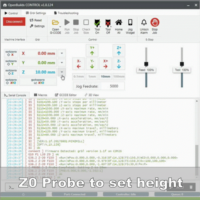

  14. Peter Van Der Walt
    12,575
    3,820
    As we have a built-in probe tool, it already catches certain messages from grbl, so when you manually probe, the [PRB:] is intercepted as an expected result to our Z-probe module.
    Thats not entirely correct, so I will gladly open an issue for you and work on getting that fixed so we only intercept after sending the Z probe from the wizard. (And as it wasnt sent using the wizard, the feedrate isnt stored in the backend, thus NaN (Not a Number) Interesting find thanks!
    It may take a couple days before I get it fixed for you though, for now, dont click Retract (as you didnt send it with the wizard, you shouldn't retract either) so at least you can continue :) - just don't click Yes.
    If you want to probe Z use the Wizard (dropdown next to Z DRO -> Z0 Probe) - no need for a Macro
    Click here to view a GIF of the Built in one:
    #14 Peter Van Der Walt, Feb 25, 2019
    Award likes this.

  16. Award
    Award Well-Known
    Nov 12, 2018
    60
    34
    Thank you very much for the response Peter.
    I hadn't realised that there was a wizard in the Open Builds Control. I will use that and stop messing around with macros and breaking things!
    Cheers

    Code:
    <button id="macro0" onclick="sendGcode('G0X0
    G0Y0');" class="shortcut outline rounded no-caption m-1 ">
    If I edit the html using chrome inspector and add "\n", the buttons works.
    Code:
    <button id="macro0" onclick="sendGcode('G0X0\nG0Y0');" class="shortcut outline rounded no-caption m-1 ">
    #30 sharmstr, Mar 29, 2019
