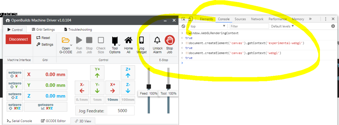

    I am also getting the webgl error, so no preview of what I'm cutting. I get true for !!window.WebGLRenderingContext, but false for the next two. I am running an older Dell Inspiron E1505 laptop with windows 7, 32 bit and intel 945gm graphics.
    14,038
    4,122
    Either graphics card, or drivers.
    Sometimes you just need a little newer hardware, WebGL needs a little oomph

    I am having trouble getting it to run correctly on 2 different laptops which should be a little more powerful than an rpi. One is running windows 7 and the other running windows 10 and Ubuntu. The windows 7 laptop has WebGL error and also keeps crashing on the com port/ USB port. <---- So, not good enough graphics to run the webgl, and maybe a bad driver for the usb. The windows 10/ Ubuntu laptap runs the software fine until any gcode is loaded. It crashes the software every time with a white screen where the software was running. I guess the shared 3gb of system ram is not enough to run it with integrated graphics. Is the rpi able to render the preview screen of the gcode when loaded?
    I should mention the software crashes the same way running Windows 10 or Ubuntu. So, that tells me it's hardware related, I would assume.

    Yes, if you search a few posts back, I explain how to get the preview to work on rpi.
    You can try debugging by hitting F12 and bringing up the inspector. Check the console. There's info on how to do this early on in this thread.

    By nature yes, WebGL can get memory hungry with large files (lots of small moves)
    OpenBuilds CONTROL is meant for that "Something easy to get you started" - so as you outgrow it with more advanced needs (work coordinates, advanced setups, rotary work, massive files etc) - we almost hope as you grow, so too does your need for better software. Making software to fit both beginner and adanvanced users, always ends up sacrificing something for both. As our dream is to make CNCing easier for everyone, we also have to compromise on some things.
    Running on the machine without WebGL - will run just fine, without the preview. If we detect the that the machine doesnt have webgl, we also dont enable gcode parsing, 3d viewing and all other functions requiring webgl. So it speeds things up a lot.

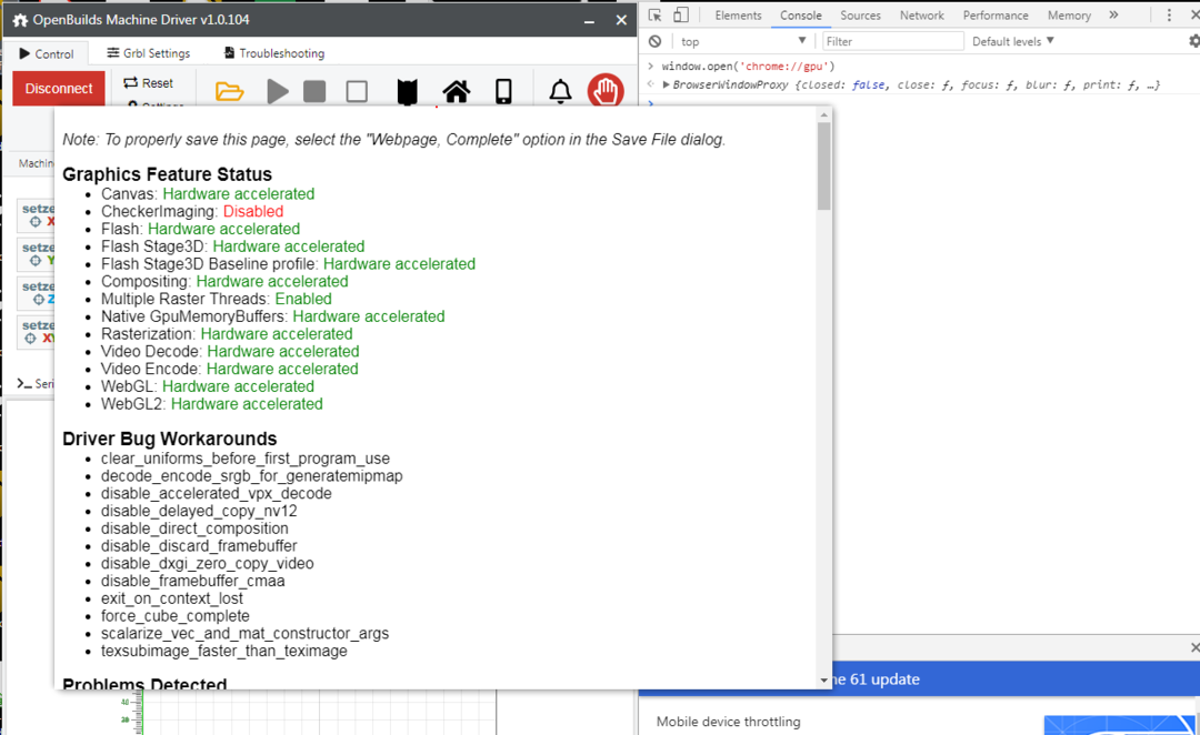

    As for why the machine doesnt support webgl: we simply check what chromium says the machine can or cannot do. Its always a case of drivers, hardware or OS configuration:
    All we do is check if the machine has a WebGLRenderingContext and can create an experimental-webgl canvas:
    var webgl = (function() {
    try {
    return !!window.WebGLRenderingContext && !!document.createElement('canvas').getContext('experimental-webgl');
    } catch (e) {
    return false;
