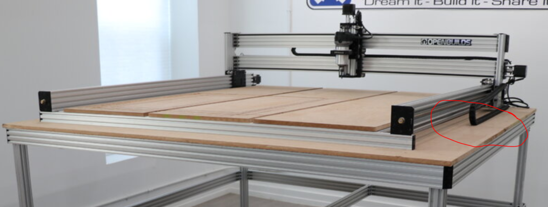

    Any idea where one can get mdf at this size? I can only find 4’x8’.
  3. Peter Van Der Walt
    14,571
    4,230
    Use two smaller pieces, and use the L-brackets on the beam through the middle, to hold them together (feel free to add extra joints using biscuits, overlapping thinner sheets, etc)
    See, for example, you can make out the joint where the two sheets meet in this photo: (Circled in red)

    As usual, a prompt and helpful reply. Thanks!
