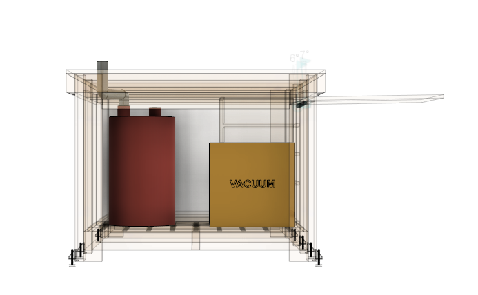

    Am I looking for trouble by putting the vacuum under the back of the machine?
    The controller will be at the front which is a good 4 feet away.

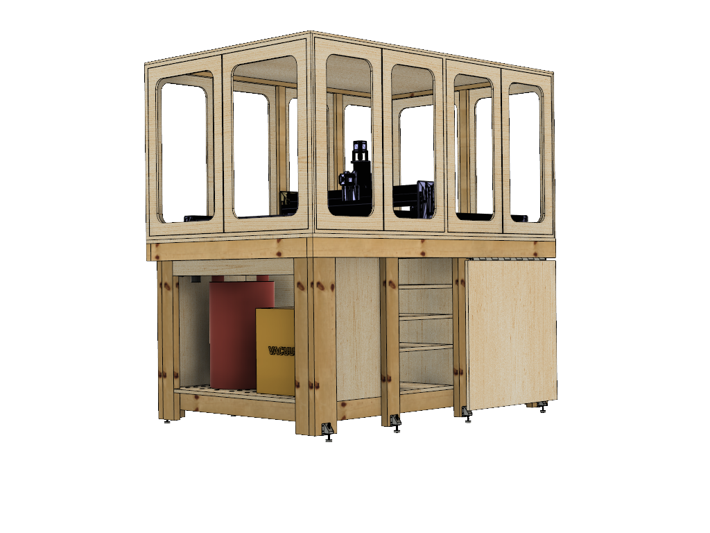

    That's a pretty impressive cabinet you have drawn there. :thumbsup:
    As you haven't mentioned noise, although it would help some, I assume it is solely for containing dust.
    If, however, you have a good extraction system, and you are not going to be using it in your lounge, I don't know that you need to go to all that trouble. :rolleyes:
    I've used my old machine with a shop vac sitting right next to it, and had no problem, other than having to earth the vacuum pipe for static. :)
    You will need to consider how you will
    get the pipe from the vac to above the machine. Perhaps the table would need to be longer at the back so the pipe can rise up through the table and make its way to the Router/Spindle from there.
    As a thought, I would put a great table like that, on adjustable wheels, so making it easy to move and make all areas around it accessible.
    In fact I think I might use a few ideas from your drawing for my next CNC table. :D
    Good job.

    Hey GrayUK,
    Glad to meet you and thank you. Seems we have the same thoughts.
    I have a few possible reasons for the enclosure.
    1 - Dust, though the dust collection might be enough
    2 - The machine will reside in a dirty environment. Though a tarp thrown over it while not in use will work.
    3 - Noise. I didnt buy a router with it. I have a dewalt that I will try out first, though I might end up with a spindle. From what I read, due to the length of the X axis, weight of a spindle is a concern, but I havent really done too much research on that yet.
    For the dust collection part, I already have the pipe coming up through the table top. You just couldnt see it in the picture. Heres one showing it better.
    The reason for wanting the dust collection under the table was to hopefully cut down on vacuum noise and (to your other point) make the whole thing mobile. For the noise part, I ended up buying a Fein Turbo I. Its only 66 db and works great. The floor of the dust collection cabinet will be perforated and the sides will have a few fans. This should help with the heat generated by the vacuum. (The cabinet has doors, but I didnt show them in the pics)

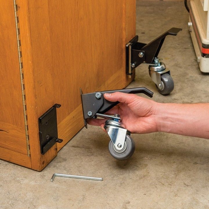

    For the mobile part, I have castors, they just arent modeled. I bought these removable ones from Rockler

    Hi Shawn, yes that looks like a great cabinet, so congratulations on thinking ahead because dust collection can be an issue. Like GrayUK I haven't done much yet regarding dust, so I will be keen to see how you go. I've built a c-beam XL with extra Z height, but when I get time I should do something about dust collection.Images

    Impressive cabinet. This should really help reduce noise.
