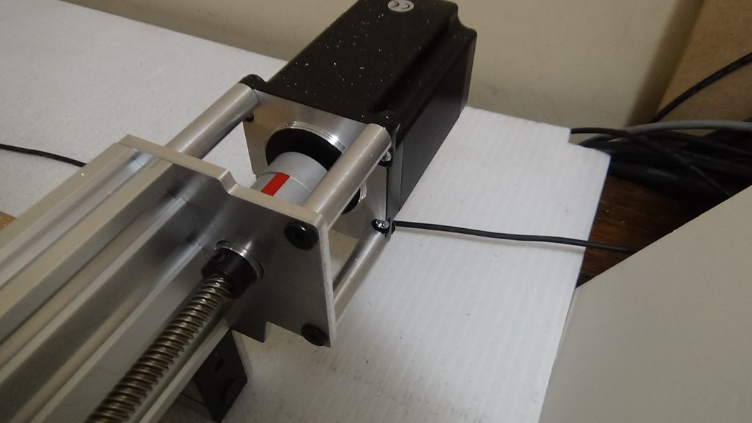

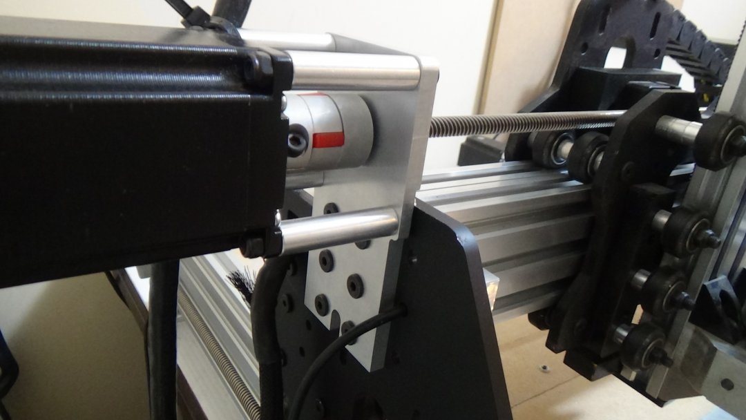

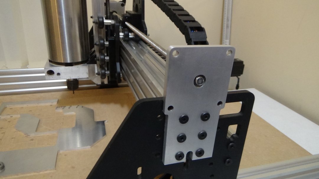

    I'm assuming your using NEMA 23 stepper motors? What spacers (specifically) did you use between the stepper motor and the brackets? Thanks
    #3 Trevor Farnum, Feb 22, 2017
  4. DazTheGas
    DazTheGas Journeyman
    Jan 27, 2015
    75
    142
    These are 40mm spacers available from the parts store.

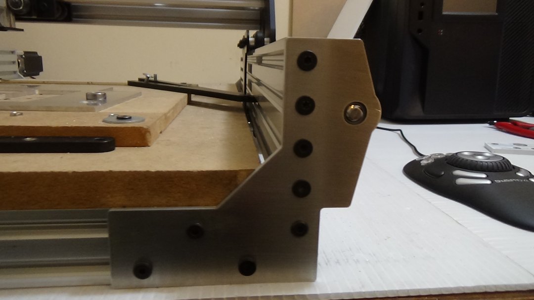

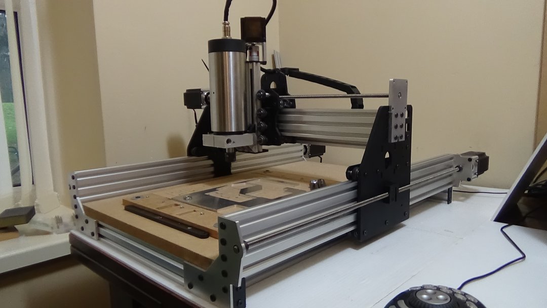

    I've been thinking about converting the Ox to lead screws and **** if you didn't pull it off! I'll chime in and would be happy to buy the plates you designed to make this happen. I'm also thinking of extending my Z axis up 2" with one of the gantry sets I've seen up on eBay, but I don't think your design would effect that, no?
    I'm new to CNC and trying to configure the perfect dual purpose machine for hardwood/soft metal purposes and think the Ox with your enhancements seems to be the ticket, but I haven't yet worked up the total cost. Any thoughts? I'm trying to pull off a machine on a tight budget, $1500 max. I may go for a smaller footprint as well. Anyway, let me know if you have plans to sell these things or, if not I'll buy you a bottle.

    What kind of speed are you able to get for fast movement, for screws versus belts? I'd miss being able to move the gantry about by hand.
    Slippery slope of upgrade-itis though. Note you have stronger motors than ooznest stock kit...which would need new drivers, which seem in short supply in UK for something based on GRBL.

  17. Gerta
    Gerta New
    Jan 16, 2017
    This is fantastic. I need the performance of lead screws but really want to take advantage of the large support community for the OX. This is the best of both worlds.
    I'm trying to compile a complete list of parts for this upgrade, and I'm hoping someone can clarify certain aspects of the build.
    For the stepper plates, how exactly are the motors mounted? Based on what I can figure, the motor would mount through 3 holes: the 2 outside holes (unique to the stepper plates), plus the uppermost hole on the inside that also mounts into the end of the topmost v-slot rail. Is that accurate? I'm wondering whether drilling for the fourth motor mount point would make sense? It would require a countersunk hole to accommodate a screw while keeping the plate flush with the v-slot, and it might also mean eliminating the nearby hole (1 of 4) for screwing the plate into the v-slot end.

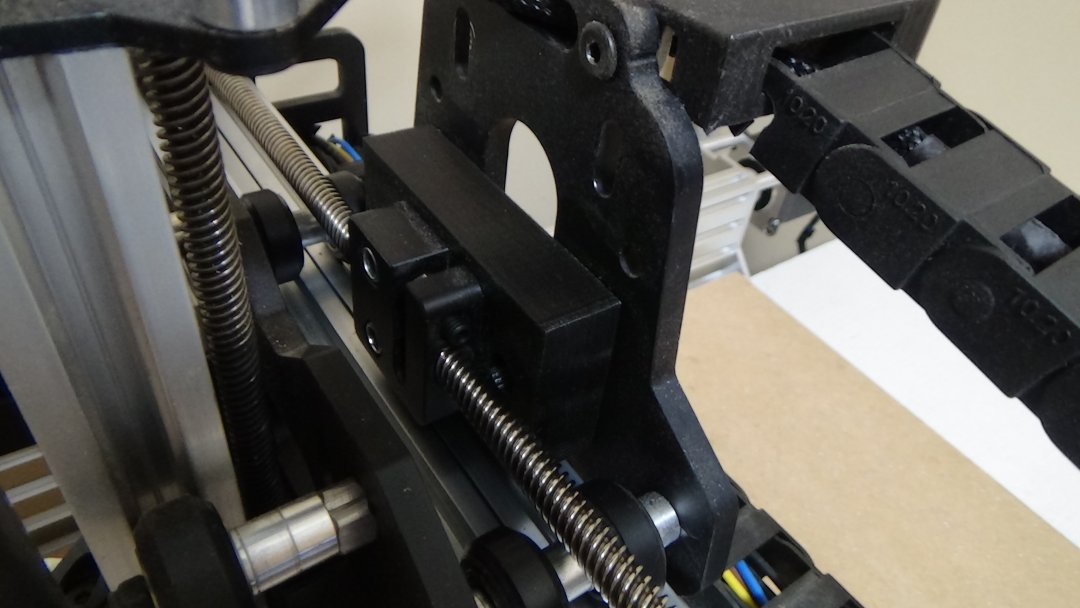

    My other question pertains to how the anti-backlash nut mounts on the OX gantry plates. It looks like the standard OX y axis plates need to be drilled. Is there a specific pattern for doing so?
    Thanks a million for providing this resource. It's a huge help.

    I will see if I can pull some for docs to help the community see things more clearly.

    I just incorporated a 12mm thick piece of UHMW Plastic to take up the space between the Flat Anti-Backlash Nut and the rearmost plate. Works perfectly and as an added bonus it's extremely slippery and supplies added support.

    This is the gap in the x/z assembly, yes? Did you find the gap was creating problems?
  24. Ronald4418
    Ronald4418 Well-Known
    Nov 4, 2015
    218
    33
    It's the gap that was created when I replaced the Belt Drive with a Leadscrew and the Flat Anti-Backlash Nut. And no, I was just too lazy to order a new spacer from the Openbuilds Store as I wanted to get my machine finished for a second time. And hopefully for the better now that I've replaced all of the belts with leadscrews.

    Thanks, Gaz, the 3d printed X mount is a useful clarification. For a couple of beers I can get that made. I have a similar question about the Y mounts - an adapter plate makes sense to me, to give some room for adjustment and avoid the need to accurately drill the existing plate manually.

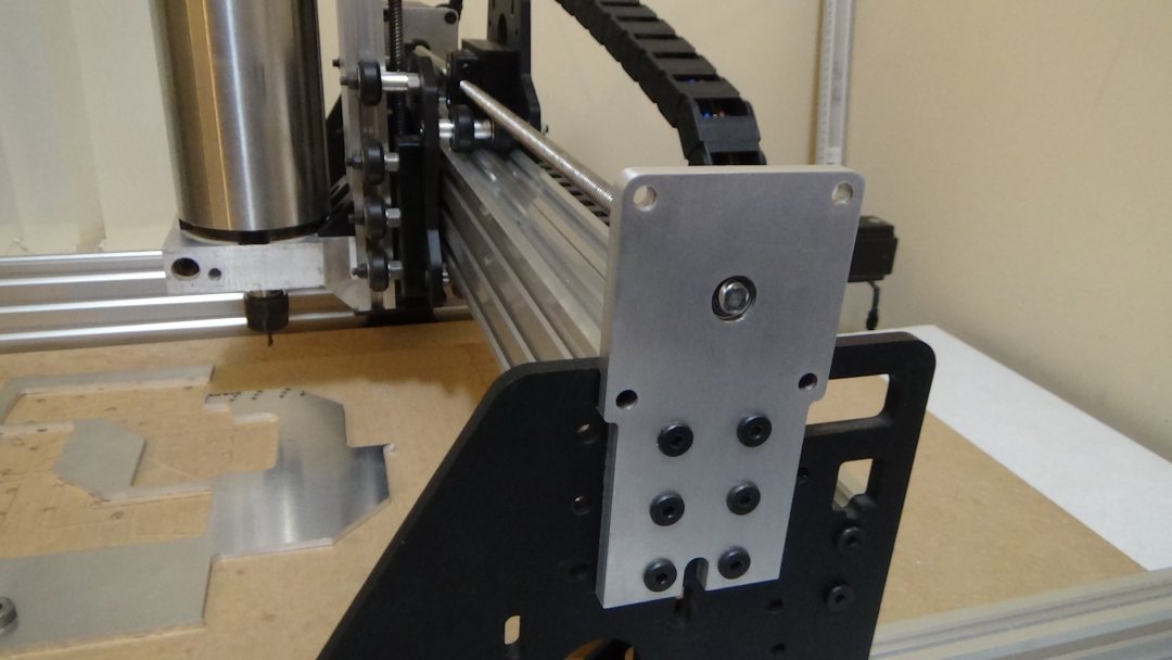

    I hav`nt listed these on Ebay as of yet but will do at some point. At some point today I should be uploading a new file as I have changed all plates to 6mm and will be cutting a new set for myself so I can work out how much a full set etc costs to make and create an assemby video.

    X nut carrier for milling from 10mm acrylic or similar:
    A360
    A little acrylic weld and you're done. Yet to see if I've got the thickness quite right.
    DazTheGas likes this.
  30. Duncan Smith
    Mar 31, 2017
    Upgraded my X axis to acme. I've cut the plates from 10mm acrylic, which will have to do until the machine is in a better state.
    For these I've added little more meat over Daz's design (because acrylic, not aluminium) and slotted the holes to allow for adjustment.
    X plate design here:
    A360
    All worked out very well.
