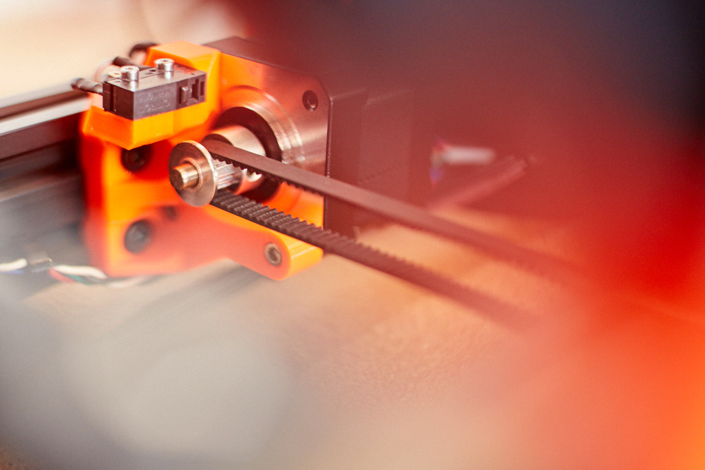

    Here is the evolution of my Prusa i3 Bear Half Upgrade V1.0. As you can see it is now split into two versions depending your needs (HALF and FULL upgrade). There is also 3 different versions of the Full upgrade : one for MK2(s), one for MK2.5 and one for MK3.
    Because of all these versions, it is much more easier to store files and arrange everything in my GitHub than here (let me know if this is an issue). For now it is still in the DEV branch, will be moved soon ;)
    As there is several versions there is a different status for each of them.
    Half Upgrade : Build complete, manual and assembly instructions finished, currently waiting feedback from first users
    Full Upgrade MK2(s) : Build ongoing, will be finished before end of February. Assembly instructions will be ready soon after the build.
    Full Upgrade MK2.5 : I am waiting for my MK2.5 upgrade but it will be very very close to MK2s, only the RAMBo cover hinges are different. Assembly instructions will be ready soon after the build.
    Full Upgrade MK3 : No build as been tried yet but parts have been tested individually. Everything is ready except assembly instructions. I do not have the privilege to own a MK3, if someone would like to try the adventure that would be awesome!
    Big THANK YOU for all of you that support me in V1.0 and try the build as well !

    Some new pics of the building...
    I found one little issue for now, the top RAMBo base mount is a bit backward from the v-slot (this part is not visible in these pictures). I will have to double check why because in my Fusion 360 project using it fits perfectly using the original RAMBo cover from Prusa github.
    SteverJ likes this.

    Okay so some bad news from this afternoon :
    • I have to increase a bit height of Z motor because I could not insert the motor otherwise
    • Bottom of Z axis is larger than top which is really weird and I do not understand where it come from. I have first mounted the "n" of the Z axis and then used it to define the larger of the Y base so it should be good. My printed parts and design looks good. I will go deeper in this.
    • I can do some small improvement on the RAMBo cover mounts to ease build and increase rigidity
    Y axis works fine, but I see some very little improvements I can do...
  10. pek
    pek Journeyman
    Apr 17, 2017
    196
    130
    I found the problem! The Y axis is larger than the top by 0.9mm (the extrusion positions, not the printed parts). I will try another way to have top and bottom perfectly aligned.
  11. pek
    pek Journeyman
    Apr 17, 2017
    196
    130
    I finish the build with a successful calibration \o/ . I have to apply several fixes, specially on Z axis, so wait before trying this V2 Full upgrade or you will be in trouble :D
