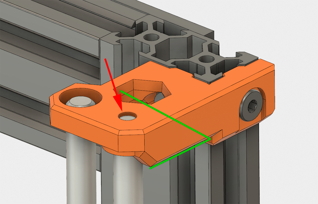

  13. pek
    pek Journeyman
    Apr 17, 2017
    196
    129
    Yes I am thinking about this (and much more) ;)
    Moving the horizontal vslot on top does not solve this problem. The vertical extrusion can be cut with a slightly different length (or not a perfect 90° angle) and depending how well the build is done you might have unequal small spaces on top and bottom of vertical vslots. The advantage of the small top vslot is that you can use it to set same distance in bottom than in top.

    Precise cut does not mean perfect assembly, it depends how good you will square your frame (which depends on lots of factors). You also have to take in account that t-nuts are not centered in a hole like the screws on the prusa frame, they have a bit of play to help you square your build.
    Something else that is not perfect with the Prusa method and screws is that the plastic part are going to be deformed by the screws. Plus, they slightly twisting the X axis (specially on the side of the X motor).
    What I am doing to make a good alignment :
    • Z motor mounts are touching the bottom vslots
    • There is a smaller diameter on top of Z top smooth rod holes, if you push the smooth rod correctly you will get the perfect dimension. There is a hole to view that the smooth rod is correctly inserted
    • Flat surface in bottom of Z stop to stop the X motor and X idler without twisting them
    What do you think?

    1. Z motor touching vslot/extrusion may (not sure yet) generate vibration, I would decuple it, also not touching metal
    2. I'm not sure if I understand what it is, is it the square through-hole as in the original X Axis carige ?
    3. Bottom can't be really used as stop for X axis alignment, only top
    I think this will be not easy task to make perfect X axis stop on top for extrusion/vslot frame.

    Sorry I was not clear, quite hard to explain without an image...
    1. For now printer is quieter than original and maybe a bit quieter than Half Upgrade. If you prefer, you can add a piece of 1mm under the Z motor mount during the build (remove it when finished) and 1mm longer vslot. Bonus, you should win 1mm in Z axis (never tested this)
    2. Corresponds to red arrow. During the build, the smooth rod has to be fully inserted until touching on top. Their is a little hole in center to see it is correctly inserted. Rod will then define the Z height precisely. (this will be explained in the manual)
    3. Corresponds to green lines. When X idler (or X motor mount) will go up, it will touch the parts marked in green. For me it is way better than "half" of two screws head (as explained in my previous post)
    Is it better explained now? Does it make sense?

    now I understand what you mean, ein Bild sagt mehr als 1000 worte :)
    The Z endstop where the green line ist, wont this bend if the X carriage will push/hit it?
    I see one problem with the 3D printed parts, as they are they wont work with Misumi extrusion, if you can send me the IGES/STEP file, I can design for missumi or you can send you the Misumi dimensions

    Even more with my bad english. Ich verstehe ein wenig Deutsch aber ich bin from French part of Schweiz (yep we are speaking 3 languages in Switzerland + one for advance speaker :-D )
    No it will not bend (hard to show you on this pic without the X idler), the x idler/motor mount will touch a L shape on the Z tops.
