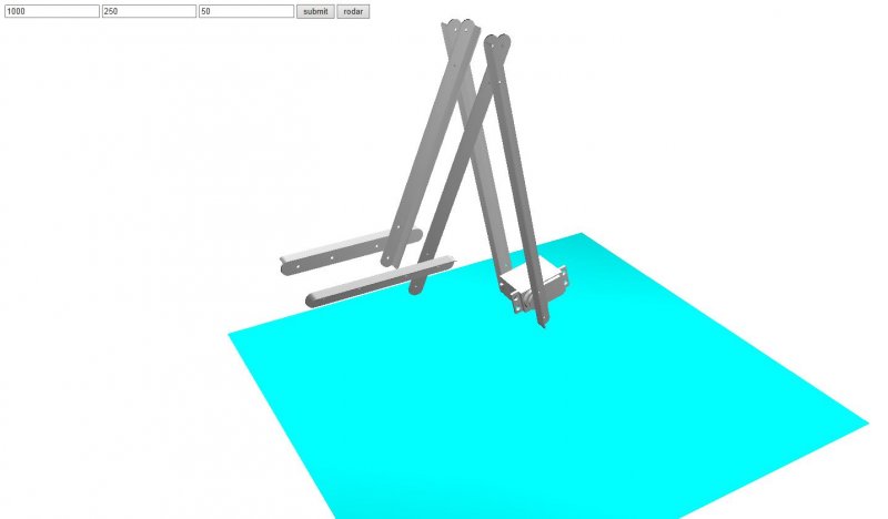

  7. cooldan
    cooldan New
    Mar 7, 2014
    hi, and thanks.. well it should work in chrome.. i think the animation only work in chrome.. try to update it...
    its some robot arm, i make the code for arduino control 3 servos (180º) so the robot "hand" move as a CNC... with XYZ coordinates...
    im sorry for the bad english :p if anyone is interested i can share the code and the concept :p

  9. cooldan
    cooldan New
    Mar 7, 2014
    well were is the "real" arm :p its my first prototype xD
    it work in my chrome, it must have WEBGL activated, it should look like this... [​IMG]
    and move after hit submit...
    last try, check this website: http://threejs.org/ if any of the samples work, my site should work too..
    thanks for the replys :)
  10. Mark Carew
    2,750
    2,423
    Ok it's working now (needed hardware acceleration turned on in Chrome settings) very cool the way it moves nice job!
