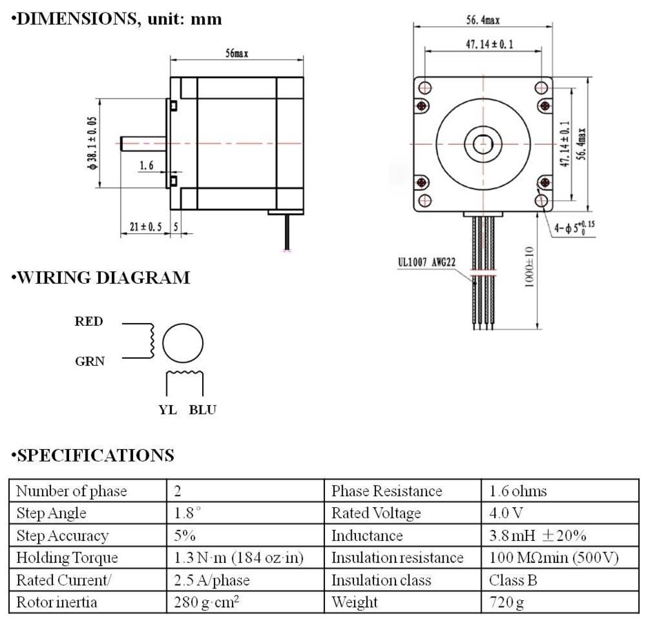

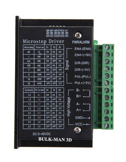

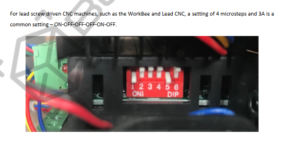

    Hello guys.
    Sorry for my bad eng.
    Please help me.
    I'm already confused.
    I bought ooznest ox cnc on aliexpress (SPAM 3d store).
    1000 * 1000
    And also bought a set of Lolette NVUM V2 and drivers TB6600.
    I collected all the mechanics. And stretched all the wires.
    But with the tuning microstep and "motor tuning"(mach3) - does not work right.
    My machine:
    Belting.
    Belt - GT3.
    GT3 Pulley - 6.35 / 20T
    Motors - 23hd56001y-21b
    Chinese drivers TB6600
    I need to properly set up Microstep on drivers.
    And in MACH3 adjust motor tuning set up.
    the seller has a setup guide.
    But there only for lead-screws version.
    I have the version - belting machine.
    155386161214737378[1].png 1553861839151932081[1].png 61jwFq+OXHL._SL1003_[1].jpg
  5. Rick 2.0
    2,899
    1,557
    Please contact the vendor for support. What you purchased was neither an Openbuilds nor an Ooznest product and is not supported here and there is a strong probability that the copy of Mach3 you received it not legitimate either. While we strongly believe in open source we do not support fraudulent activity.

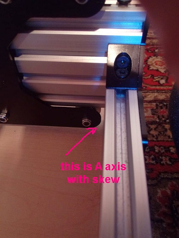

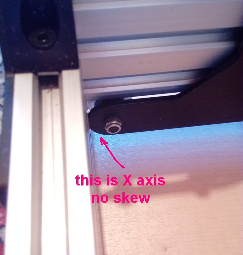

    Have (belt version) OXCnC 1000*1000.
    And have skew Y+A axis.
    In the extreme forward position, from the side of the axis "A" there is a bias. As in the photo.
    In the extreme rear position (slid all the way in), there is no such bias.
    p.s. sorry for my english i use Google for translate. :(
    Addition:
    I connected wire the motors to driver like this:
    Y Axis - ABCD
    A Axis - DCBA
    Addition2:
    If you raise the edge of the axis A.
    The distortion disappears...
    WhatsApp Image 2019-05-05 at 09.30.53.jpeg WhatsApp Image 2019-05-05 at 09.30.54(1).jpg
    #3578 Azamat O, May 4, 2019
  9. Giarc
    3,044
    1,703
    Are your extrusions on both side the exact same length? Or is one slightly longer causing it to be out of square?
  10. Azamat O
    Azamat O New
    Dec 9, 2015
    They are absolutely the same.
    This is a set, I did not produce anything myself.
  11. Hector Beltran
    Hector Beltran Well-Known
    Oct 14, 2017
    61
    26
    Your build is not squared. I had a similar issue with my Workbee which you can search for in this forum. Do this simple test: find a perfectly flat surface, and try to stand your extrusions on either end. You’ll probably notice a slight wobble with respect to the flat surface. This is caused by the threading done to the holes at the ends of the extrusions; it literally bulges the extrusion around the hole ever so slightly. If your extrusions don’t have any threads tapped, then check for square (flat surface against long side of the extrusion). A slight angle will throw off you build. YouTube has a few videos of people that have run different tests on this issue and how to check for square.
    I had mine extrusions recut with a perfectly square miter saw (just a 1 mm or 2 mm) to square it. Other people have used bench top sanders, and others have used shimmies to square their builds.
    Since you bought your kit off of China, you are stuck; you have to fix in which ever way you can. If you have access to a precision metal machine shop, you can ask them (pay them) to square them for you. Do not try filing them by hand as you’ll make them worse.

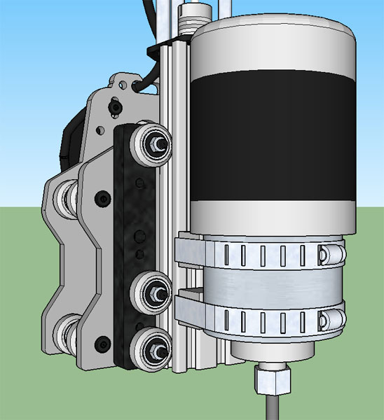

    Guys i need some help . I am trying to find an easy way to strengthen my z-axis on the cheap . I do have a lot of flexibility and when it comes to drillling aluminum it can't center itself. Did anyone come over this and solve it ? If so, how ?
  25. Rick 2.0
    2,899
    1,557
    We need some really good photos of what you have in order to offer suggestions on modifications. Also can you identify the specific point of weakness? Is it just the Z or does flex in the X-axis play into the problem.
  26. Gaou²
    Gaou² New
    Nov 17, 2014
    20
    i haven't did anything in z axis . it is stock ox 1500x1000 . i have some flex on the whole carriage that runs on the double 60x20 profile but i dont mind . What is bother me is the flex on the z axis. When it comes to drill then it is flexing along y axis. i mean instead of going down vertically ( z-axis) when it touch the part then it flexs a little on the y axis.
    [​IMG][​IMG]
  27. Rick 2.0
    2,899
    1,557
    The easiest solution is just to extend the spacer blocks. Looks like you could easily add 60mm to them. The additional leverage adds a fair amount of rigidity.
    Gaou² likes this.
  28. Gary Caruso
    May 19, 2016
    1,198
    536
    Yes, this or do the C-Beam upgrade (Ox HD)
  29. Gaou²
    Gaou² New
    Nov 17, 2014
    20
    the c-beam upgrade needs internal mini wheels, or it is just the outside wheels ?
  30. Gary Caruso
    May 19, 2016
    1,198
    536
    At first I was using the standard Ox HD that Chrisclub cuts (no inside wheels), but have since designed my own plates (the ones in the pic) that do have the inside wheels as well.
    see pics
    Cheers
