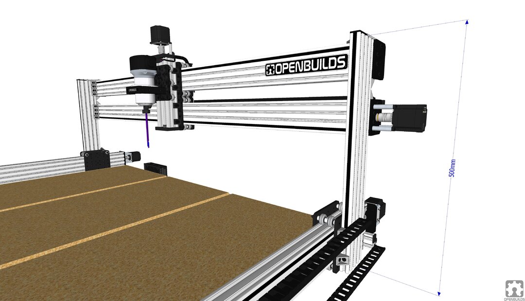

    My kit should be here tomorrow. Super excited to start this build! Does anyone know the total height of the machine? I'm wanting to build a table similar to this but am unsure how much clearance I need for the height. I plan on getting the table built while I work on the smaller cnc assemblies.
    Thank you!

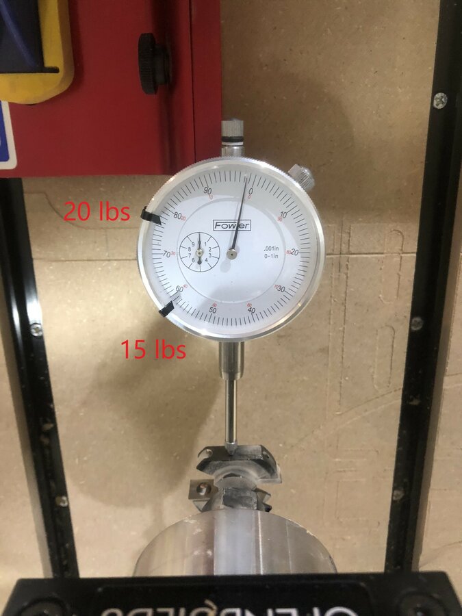

    I got everything setup and did my first test cut. It seems that I am gaining steps over the course of travel on both the X and Y axis. I ran a program that should have drilled the last holes at 1146mm from the origin and it ended up at about 1150mm. The setting for $100 and $101 are the default for the 1515 profile:
    $100=198.109 ; X-axis steps per millimeter
    $101=198.109 ; Y-axis steps per millimeter
    When using the calculator it puts the steps at 200. I tested at 200 and the DRO reads about 1132mm when I should be at 1146mm. I am using the high torque motors so I am not sure if there is something unique there. I am new to this so there has to be some simple math here I am missing. AlmostComplete.jpeg
    #103 cnc0014, Jan 21, 2021
  14. Peter Van Der Walt
    14,400
    4,194
    Wizards and Tools > Calibration
    The amount of tension in the screws can affect the steps-per-mm values

    Thank you!! After calibrating I am in sub-1mm off. May need to work on tweaking it a bit but MUCH better now. As it wears in I will revisit it.
    Are there plans to release a double C beam Y axis plate? I am getting a decent amount of flex/deflection at the center of the Y axis. It would be easy to just add another XL carriage/C beam with a taller plate drilled for it. I know I could make one and others are doing so but it would be very simple to just have a kit as an upgrade. Basically a replica of the X axis/gantry.

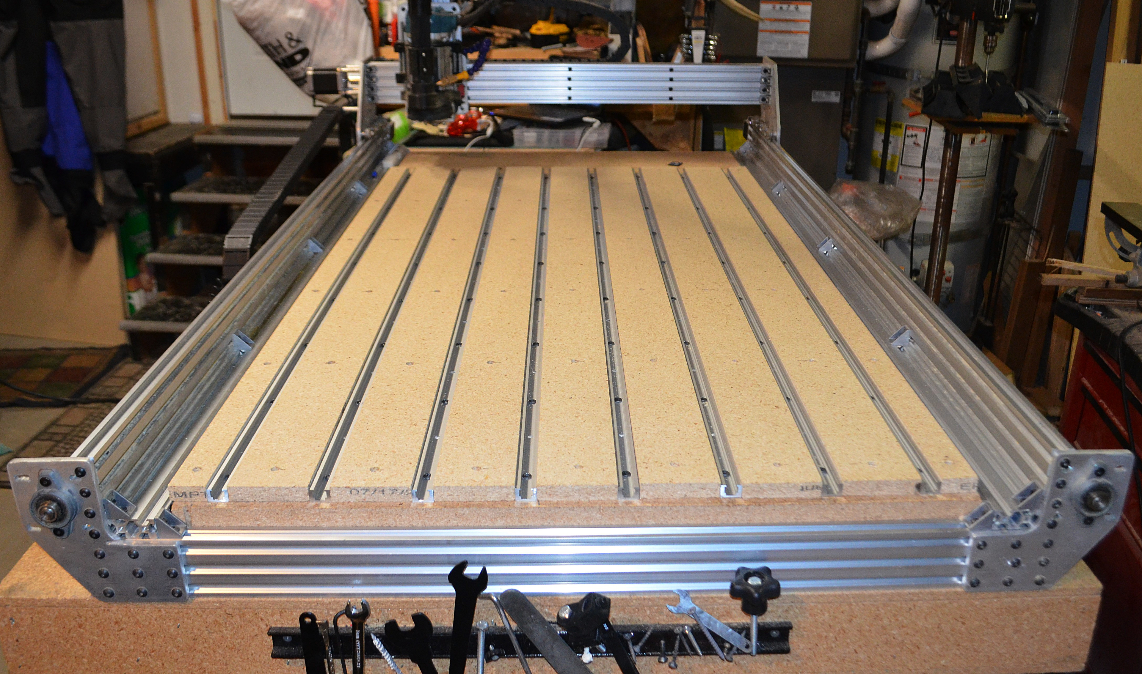

    I've just completed the the lead 1515 high Z build and finally have it cutting. I wasn't keen on the way the plans call for the spoil boards to be mounted from underneath the machine. Doing it that way will be a major hassle when it comes to replacing the spoil boards. To allow the spoil boards to be attached from the top I put 19x19 pine rails around the edges as shown in the photos. The spoil boards are screwed to that (in deeply recessed holes). Taking them off no longer requires access to the underside of the machine. You could always face off the rails which should mean that the spoil would be nearly perfectly true (assuming they're flat to begin with).
    I've drilled a grid pattern which has M8 tee nuts underneath so I can use an M8 clamping kit. The spacing of the holes is 100mm apart in the first 700x600mm, then 150mm apart for the rest.
    I trammed it by facing off a small piece of MDF (300x300mm) to see how much the 25mm face off bit if not flat. The biggest issue was the Z uprights weren't perfectly square to Y. This as easy to fix. After facing off the small piece of MDF again it's now perfectly flat in the X and the Y.
    The last job is to face off the entire bed. For this I'll by running the spindle at 7000rpm with feeds of 2800mm/min and a depth of cut of 0.2mm (this worked well with the test face off).
    I hope this information helps someone.
