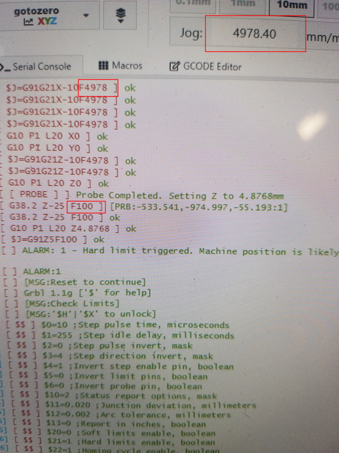

    @Peter Van Der Walt We got a problem. I cant reproduce, but I have a screenshot for you. The other day, @Blake Barr contacted me asking why the Z probe wizard would switch to inches per min on the feed rate. I told him he was crazy and to quit drinking in the shop. .180 had just came out so I tested both .179 and .180 and couldnt reproduce. I explained to him again that he was crazy.
    Today I was setting up a new job. I manually set x and y 0 using the set buttons (something he had done as well). Then I used the Probe Z wizard. I have never changed my feed rate in the wizard so its set to 100mm per min. I clicked the probe button and my bit slammed into my probe plate. In the screen shot you can see that it used my jog feed rate, not the feed rate in the wizard. Then when I retracted it slammed into my Z limit switch (which is a good 40+mm from where Z0 is after probing) as you can see below.
    I've since run it again like 4 times without issue. Good luck :)

    For my own education, what are all the $J=G9121X-10F4978 that are issued after I pressed the probe button (in my screen shot)? I could understand why they would be there before I probe since I do jog the bit down close to the plate before probing.

    nm. I was reading it wrong. I thought you were using G28 commands and that those jog lines were happening during the probe routine. :oops:

    so I have now ruined another bit because of Probe Z. Probe Z has now cost me nearly $75 dollars and put me even further behind on getting projects completed. Getting pissed about this problem is now becoming a search for better software. And this is NOT an EMI problem.
    here is the gcode:
    X0, Y0 were set manually prior to probe Z. Yesterday I did this same thing and the first time it probed, had the same problem. retracted and ran probe again and it worked as it should. I did not look at the console to see if when it retracted it set coding to G21 but I bet you it did which is why probe Z worked the 2nd time.
    Notice G20 yet it set Z to 19.72mm (my touch plate thickness). I read and operate in inches and it probed (or attempted) 19.72" at 100ipm. Z callout was set to 19.72" (not the mm counterpart) after it broke the bit and completed the command.
    Why is this a difficult fix? Seeing G20 there sticks out like a sore thumb. Since your probing featuring are set to run in metric regardless whether you operate the software in inches, why cant you just change the code for probing to always be set to G21? Am I missing something here or why does this sound like a really simple fix? Or just dont let people use inches if you know its a problem.

    Now that im not so pissed, i am looking this over and i am going to explain in depth what i am doing:
    I am manually setting X0, Y0 and then manually inputting half the cutting diameter into X and Y, then setting that position to 0 to get true zero. that is where G20 is coming from. then i jog 5ish inches in X+ and Y+ to get into position for the probe. You can see G21 in the jogging commands but it makes me wonder if G20 is still overriding G21 since its a callout for a G21 jog to position vs a solid G20 or G21 command like at the top of the Gcode i have listed.

  24. Peter Van Der Walt
    14,871
    4,283
    :) As you know its broken, do not use it! Jog Z down manually, click Setzero. Not too hard, and surely cheaper and less frustrating. When the bug is fixed you'll see a notice in the Changelog on the troubleshooting tab, or also hosted here: OpenBuilds/OpenBuilds-CONTROL
    See OpenBuilds CONTROL Software and the other related ones around it - we don't say its EMI. We were still discussing the root cause
    a) there is a long todo list: Build software better, together is just the CONTROL/CAM one - and priorities just like any other organisation
    b) So far I've had two users reporting the issue, you'd be the third. Relatively low priority for a bug thats not really reproducable yet (up to the last discussion at least, sounds like you have a pattern of how to make it fail, so can now try again) and
    c) it was first reported on 20 July. Just 11 days ago :) - so hold your horses :)
    Well, thats putting a bandaid on it but sure, checkout v1.0.183 (compiling now - test it later) . There's a quick way, and a right way. The right way will be when I have the probing wizard switch to Inch too when the user is in inches (; - of course thats more work too so will stay on the todo for now
    Of course, @sharmstr works exclusively in mm mode and had it happen to her too
    So... still up for debate if G21 fixes it

    Is there a difference in the background between a standalone G20/G21 code (like the G20 listed at the top of the code i posted) vs a G21 Jog code? Does the G21 jog code reset the coding to G21 or is that jog code in G21 remain only for jogging?

    As per Grbl Wiki > Jogging gnea/grbl :
    We do use the override, which is active just for the jog command then

    OHHHHHH. Sorry for the wrong info Blake. I wasnt aware of that. Normally, as I mentioned in our chat its modal. But as I also said in our chat, I'll take Peters word over anything I say. LOL
    Peter, just to let you know, since Blake (and from the looks of it WJC) have run into this problem several times, I've suggested that he create a macro for Z0 probe that calls out a G21. I understand that it may be a bandaid, but would be interesting to see if in doing that the random problem goes away or happens again.
  29. Blake Barr
    Jun 2, 2019
    I will keep you updated. I made sure to make g20 active prior to probing and adding g21 prior to probe Z appears to have solved the problem.

    Good idea, but note that v1.0.183 will do:
    addQToEnd('G21');
    addQToEnd('G10 P1 L20 Z0');
    addQToEnd('G38.2 Z-' + data.dist + ' F' + data.feedrate);
