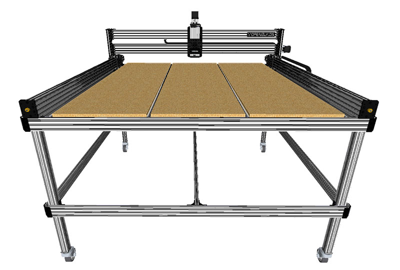

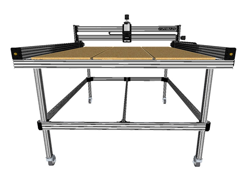

    Attached is a Sketchup mashup of the 1515 with the table. Really doesn't work directly. Saves about $72 in rail but the legs interfere with the Y-axis gantries which cuts about 90mm off the usable Y-axis working length.
    To truly make it work you would need to squeeze in the side rails on the table a bit more but I've taken it as far as I'm going with it. If I were to build the combination I'd just cut the table down to the size of the system. A lot less wasted floor space that way.

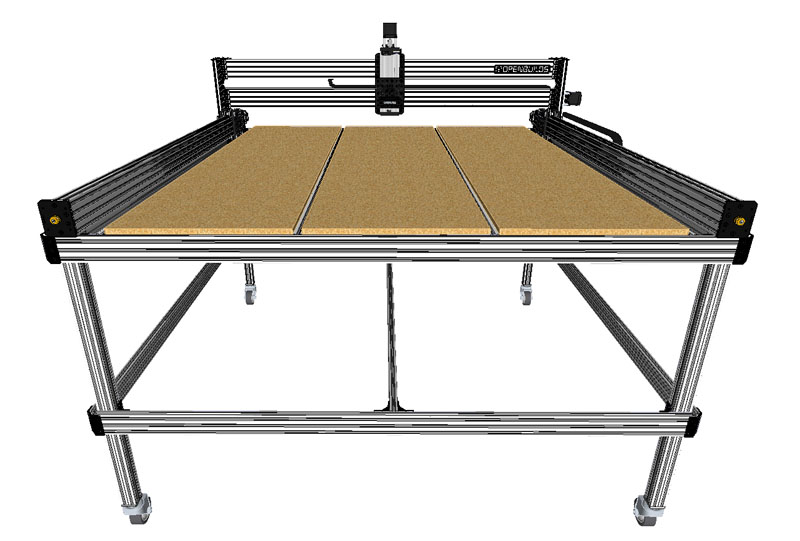

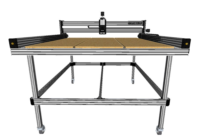

    Got some sleep and decided to give it another go. This revision resolves the Y-axis issues.
    Actually turned out rather nicely. Still needs a 20x20 rail to support the drag chain on Y2.
    Please remember, this is only a conceptual design. No actual build or testing behind it. The Sketchup drawing is a mashup of drawings created by two different persons that did not mesh perfectly so dimensions may not be accurate.

    Best just to point you to the source of all things OpenBuilds | 3D Warehouse (sketchup.com)
    As far as the changes, the (6) 20x40 bed framing pieces on the LEAD were replaced with 20x60 members, 5 of which would have comprised the original top frame of the table.

    I think there is no magic to the exact location of those outer rails supporting the edges of the spoil board. Pick a number that works and carry it through. Make sure the rails clear the gantry plate and the connections fit in the corner. This will in turn determine the length of the lower front and back rails.
    I integrated the 20x60 framing into the base of the 1515 for a couple of reasons, some people have noted weakness in the 20x40 bed framing and having the 20x60s to connect the legs to meant a more rigid connection which will mean less wobble in the table.
    As far as leftovers you still need to budget in a side rail to support the drag chain alongside Y2. One of the original bed 20x40s laid flat and anchored to the front and back rails with a couple Black Angle Corner Connector - OpenBuilds Part Store will accomplish this nicely. If you don't like exposed ends you're also going to need several more End Cap - OpenBuilds Part Store to close off the extra holes on the 20x60s and the drag chain support.
    And finally the one item you're missing is the bottom plates on the legs that the castors fit into. I don't see them listed separately in the shop so you may need to make your own.
