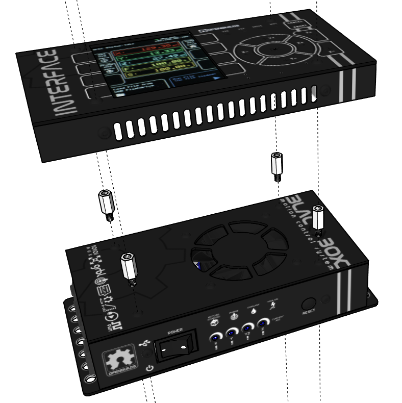

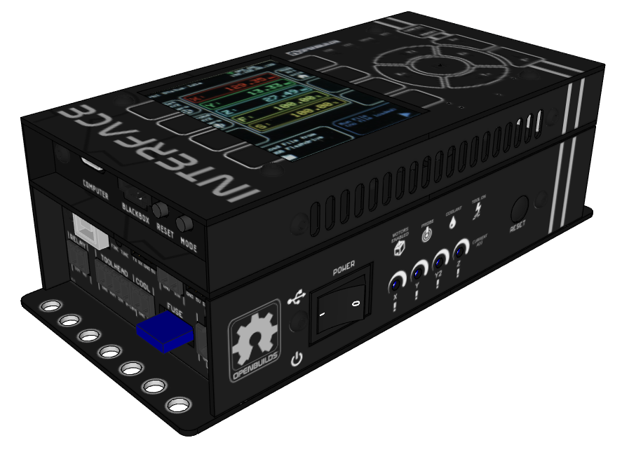

    I believe it was ingenious of OB to design the Interface in a similar (same?) footprint as the Blackbox. Now our significant others will have no idea we bought something new. I can just mount my Blackbox in a hidden spot and I'm set.
    Wife: Why are you always holding that black box thing now?
    Me: It's just easier this way.
  27. Peter Van Der Walt
    14,571
    4,230
    While we definitely support any kind of camouflage to keep spousal relations high, there's actually more to this than coincidence (;
    Not only, is it sized to be as you assumed, the "same" size as a BlackBox...
    We also took care to line up the mounting holes, and added ventilation holes, so that you can affix it to your BlackBox!
    Full documentation page will be added soon - briefly:
    1) Disassemble the Interface, set aside its bottom cover and 4x 12mm female-female hex spacers, they will not be needed it for the mated assembly
    2) Remove the 4 screws that hold the BlackBox's top cover in place
    3) Replace these with 4x Hex Standoff - M3 (4 Pack) (The 12mm Female x 6mm Male version) (remember to add to Cart if you plan on doing this)
    4) Reassemble the Interface onto these spacers as a reverse of the disassembly.
