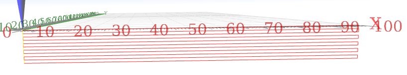

    14,042

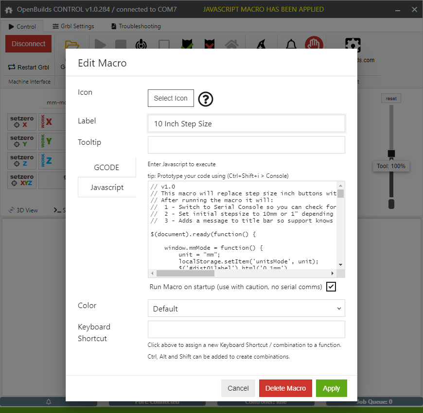

  7. sharmstr
    2,039
    1,434
    Updated hide Z buttons, now works with step size change via keyboard shortcuts. (though doesnt rebind if shortcuts are changed. needs a restart)

    Want to know how big a piece of stock to grab from the offcuts bin?
    Code:
    if (typeof object !== 'undefined') {
       var string = ""
       if (object.userData.inch) {
           string += "Width (X): " + (object.userData.bbbox2.max.x - object.userData.bbbox2.min.x) + "inch" + " / " + "Height (Y): " + (object.userData.bbbox2.max.y - object.userData.bbbox2.min.y) + "inch";
       } else {
           string += "Width (X): " + (object.userData.bbbox2.max.x - object.userData.bbbox2.min.x) + "mm" + " / " + "Height (Y): " + (object.userData.bbbox2.max.y - object.userData.bbbox2.min.y) + "mm";
       console.log(string)
       Metro.dialog.create({
           title: "Stock Size needed",
           clsDialog: "dark",
           content: `
              To run this job, you need a piece of stock:<hr>
              ` + string + `
           actions: [{
               caption: "Cancel",
               cls: "js-dialog-close alert",
    #8 Peter Van Der Walt, Jun 9, 2021
    BSmith and sharmstr like this.

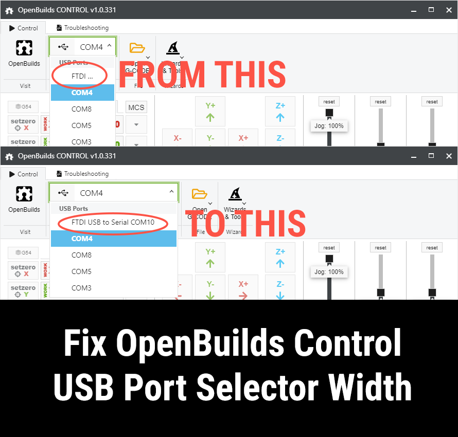

    Some of @sharmstr 's awesome Macros:
    Expand USB Port Selector in OpenBuilds Control
    ___________________________________________________________________________________________________________
    Set Work Zero Via Keyboard Shortcuts in OpenBuilds Control
    Initiate Probing via Keyboard Shortcuts in OpenBuilds Control
    Change OpenBuilds Control Jog Step Size
    OpenBuilds Control Automatically Launch at Startup
    See more of her awesome Macros here: Blog
    Soultie and sharmstr like this.

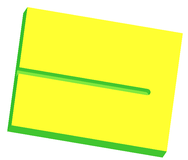

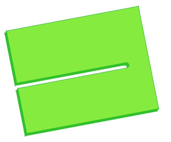

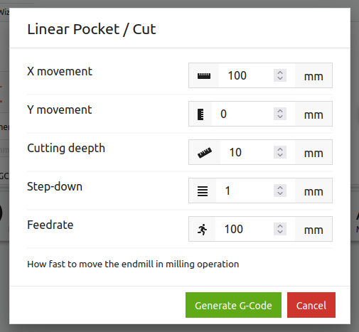

    I have created a small macro I'm using for my builds and want to share it with the community, hoping it might be useful for one or the other: milling a linear cut or pocket into some stock.

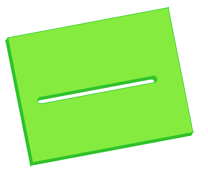

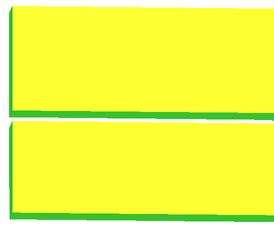

    Intention
    The initial requirement was to easily perform an exact cut of some stock. As I do not have a good sawing equipment, I simply cut the stock by a milling operation. The g-code was generated by some CAD program and converted to GRBL g-code. Instead of changing the parameters all the time in the CAD program, I created this macro.
    Description
    The purpose of this macro is to cut some stock by milling. It starts at 0/0/0 (x/y/z) and mills to x/y/z.
    In fact, depending on the placement of the stock relative to 0/0 and the x/y/z length, the macro can be used to
    • cut a stock
    • mill a slot into a stock[​IMG]
    • mill a long-hole into a stock[​IMG]
    • mill a pocket into a stock[​IMG]
    The macro generates a sequence of G-Codes with linear milling movements in layers. The generated code will replace the one in the G-Code editor, and triggers the parsing and visualization of the code in the 3D viewer.
    Installation
    To install the macro, copy the code from below, or from https://raw.githubusercontent.com/poWer4aiX/ob-linear-cut-macro/master/src/ob-linear-cut-macro.js into a new macro in OpenBuilds CONTROL.
    Source
    You can find all the sources in github repository GitHub - poWer4aiX/ob-linear-cut-macro: Macro for OpenBuilds CONTROL to mill a linear horizontal cut.
    Code:
      title: 'Linear Pocket / Cut',
      content:
       genInputHtml('X movement', 'xMovement', 100, 'fa-ruler-horizontal', '') +
       genInputHtml('Y movement', 'yMovement', 0, 'fa-ruler-vertical', '') +
       genInputHtml('Cutting deepth', 'zMovement', 10, 'fa-ruler', '') +
       genInputHtml('Step-down', 'stepDown', 1, 'fa-align-justify', '') +
       genInputHtml('Feedrate', 'feedrate', 100, 'fa-running', 'How fast to move the endmill in milling operation'),
      actions: [
         caption: "Generate G-Code",
         cls: "js-dialog-close success",
         onclick: function () {
           const xMovement = parseFloat($("#xMovement").val())
           const yMovement = parseFloat($("#yMovement").val())
           const zMovement = parseFloat($("#zMovement").val())
           const stepDown = parseFloat($("#stepDown").val())
           const feedrate = parseInt($("#feedrate").val())
           generateGCode(xMovement, yMovement, zMovement, stepDown, feedrate)
         caption: "Cancel",
    // required for jest test
    if (process.env.JEST_WORKER_ID !== undefined)
      module.exports = generateGCode;

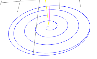

    I have created another small macro...

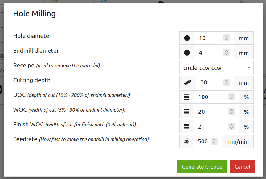

    Description
    This macro generates a sequence of G-Codes to mill a (vertical) hole into some stock at 0/0/0 (x/y/z). The generated code will replace the one in the G-Code editor, and triggers the parsing and visualization of the code in the 3D viewer.
    Usage
    When starting the macro it opens up a dialog to enter the milling parameters:
    Hole and Endmill diameter
    You need to specify the diameter of the endmill being used, as well as the hole diameter.
    Note: If the hole diameter is smaller than the endmill diameter, then the macro will not generate / update any G-Code!
    If the hole diameter is equal to the endmill diameter, then the operation is equal to a drilling operation (i.e. moving the endmill vertical in z direction only). Otherwise, the complete hole body will be milled.
    Note: Depending on your machine setup and material, the resulting hole might be smaller or even larger than the target. In this case adjust the target diameter by the messured difference.

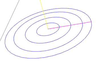

    Receipe
    There are two base receipe implemented by which the area is being milled:
    • circle: by milling in concentric growing circles.
    • spiral: by milling in a (approximated) spiral.
    Each has two additional options which steers the milling direction:
    • cw: clock-wise milling (usually against the rotation of the endmill), aka conventional milling
    • ccw: counter-clock-wise milling (usually towards the endmill rotation), aha climb milling
    The milling direction can be defined for the rough cutting, as well for the finishing process if not disabled. As a result the receipes are following the following naming convention:
    <milling method>-<rough cut direction>-<finishing direction>
    e.g.
    spiral-ccw-cw
    Cutting depth
    Defines how deep to mill the pocket / hole into the material. Usually, this is being dome in multiple layers (see DOC).
    DOC (depth of cut)
    Milling is being done in layers. The DOC defines how deep the endmill mills in each layer (might be lower for the final layer). This depth is expressed as a percentage of the endmill diameter. U
    WOC (width of cut)
    The layers being milled will cut the material based on the receipe selected. The WOC defined how deep the endmill mills into the material on the current depth layer. Again, this value is given as a percentage to the endmill diameter.
    Finish WOC
    If you prefer to split the milling operation into a rough cutting and finishing part, you cen defined the WOC used for the very last circle being milled. A value of 0 disbles the finishing loop.
    Feedrate
    The maximum feedrate used during the milling operation.
    Installation
    The latest source can be found on gitbub: https://raw.githubusercontent.com/p...ing-macro/master/src/ob-hole-milling-macro.js
    Code:

      g(`; GCODE Generated by ob-hole-milling-macro on ${new Date().toISOString()}`)
      g(`; ${holeDiam}mm hole milling at 0/0/0 downto ${zMovement}`)
      g(`; endmill diameter=${endmillDiam}mm, DOC=${doc}%/${stepDown}mm, WOC=${woc}%/${xStep}mm`)
      g('G21; mm-mode')
      g('G54; Work Coordinates')
      g('G90; Absolute Positioning')
      g('M3 S1000; Spindle On')
      g('')
      g('; Begin of hole milling loop')
      g(`; Endmill Diameter: ${endmillDiam}`)
      g(`G0 Z${z0 + zSafe}; move to z-safe height`)
      g(`G0 F1000 X${x} Y${y}; move to x/y startpoint`)
      g('')
      // rough cut
      while (z > -zMovement) {
       z -= stepDown
       if (z < -zMovement) z = -zMovement
       g(`; layer ${z}`)
       g(`G1 F${zFeed} Z${z}; step down on current position`)
       if (xMax > 0) {
         if (/^circle/.test(receipe)) {
           millCircles(xMax, ccw, xStep, g, xyFeed)
         } else if (/^spiral/.test(receipe)) {
           millSpiral(xMax, ccw, xStep, g, xyFeed)
         } else {
           console.log(`unknown receipe:${receipe}`)
           return
         x = 0
         g(`G1 F${xyFeed} X${x} Y0; move back to center`)
      // if we are not only drilling and not having a wocFinish of 0, then add a finishing cut
      if (xMax2 > xMax) {
       g('')
       g(`;--- finishing cut with DOC=${docFinish}%, WOC=${wocFinish}%`)
       g(`G0 F1000 X0 Y0 Z0; move up to zeropoint`)
       z = z0
       stepDown = endmillDiam * docFinish / 100;
       const ccw = (() => {
         if (/^\w*-\w*-ccw/.test(receipe)) return 1
         else if (/^\w*-\w*-cw/.test(receipe)) return 0
         else if (/^\w*-ccw/.test(receipe)) return 1
         else if (/^\w*-cw/.test(receipe)) return 0
         else return 1
       //g(`G1 F${zFeed} Z${z}; go back to z0`)
         // step down
         z -= stepDown
         g(`; layer ${z}`)
         g(`G1 F${zFeed} Z${z}; step down current position`)
         millCircles(xMax2, ccw, xMax2, g, xyFeed / 2)
         g(`G1 F${xyFeed} X${x} Y0; move to center`)
      // move tool back to save z
      g('')
      g('; End of hole milling loop')
      if (x != x0 || y != y0)
       g(`G1 F${xyFeed} X${x0} Y${y0}; move to center of hole`)
      g(`G0 F1000 Z${z0 + zSafe}; retracting back to z-safe`)
      g('')
      g('M5 S0; Spindle Off')
      g('; Job complete')
      // replace code in G-Code editor
      editor.session.setValue(gCode);
      // refresh 3D view
      parseGcodeInWebWorker(editor.getValue())
      // not required for the macro but for testing
      return gCode;
    function genInputHtml(label, id, value, icon, descr, append = "") {
      const descrHtml = descr ? ` <small><i>(${descr})</i></small>` : ""
      var html = ''
      html += '<div class="row mb-1">\n'
      html += `  <label class= "cell-sm-8" > ${label}${descrHtml}</label >\n`
      html += '  <div class="cell-sm-4">\n'
      html += `    <input id="${id}" type="number" value="${value}" data-role="input" data-append="${append}" data-prepend="<i class='fas ${icon}'></i>" data-clear-button="false">\n`
      html += '  </div>\n'
      html += '</div>\n'
      return html
    function genSelectHtml(label, id, options, selected, descr = '', opt = '') {
      var html = ''
      html += `  <label class="cell-sm-8">${label}${descrHtml}</label>\n`
      html += `    <select id="${id}" data-role="select" ${opt}>\n`
      html += options.map(o => `      <option value="${o}"${o == selected ? ' selected="selected"' : ''}>${o}</option>\n`).join('')
      html += '    </select>\n'
      html += '  </div>\n'
      html += '</div>\n'
      return html
    var prefs = {
      holeDiam: 8,
      endmillDiam: 4,
      holeDepth: 1,
      doc: 100,
      woc: 20,
      wocFinish: 2,
      feedrate: 500,
      receipe: "spiral-ccw-ccw"
    function loadPrefs() { if (window.tmp_prefs_macro_hole_milling) prefs = window.tmp_prefs_macro_hole_milling }
    function savePrefs() { window.tmp_prefs_macro_hole_milling = prefs }
    loadPrefs();
    // Dialog creation
      title: 'Hole Milling',
      content:
       genInputHtml('Hole diameter', 'holeDiam', prefs.holeDiam, 'fa-circle', '', 'mm') +
       genInputHtml('Endmill diameter', 'endmillDiam', prefs.endmillDiam, 'fa-circle', '', 'mm') +
       genSelectHtml('Receipe', 'receipe', ['circle-cw-cw', 'circle-cw-ccw', 'circle-ccw-cw', 'circle-ccw-ccw',
         'spiral-cw-cw', 'spiral-cw-ccw', 'spiral-ccw-cw', 'spiral-ccw-ccw',], prefs.receipe, 'used to remove the material') +
       genInputHtml('Cutting depth', 'zMovement', prefs.holeDepth, 'fa-ruler', '', 'mm') +
       genInputHtml('DOC', 'doc', prefs.doc, 'fa-align-justify', 'depth of cut (10% - 200% of endmill diameter)', "%") +
       genInputHtml('WOC', 'woc', prefs.woc, 'fa-align-justify', 'width of cut (5% - 30% of endmill diameter)', "%") +
       genInputHtml('Finish WOC', 'wocFinish', prefs.wocFinish, 'fa-align-justify', 'width of cut for finish path (0 disables it)', "%") +
       genInputHtml('Feedrate', 'feedrate', prefs.feedrate, 'fa-running', 'How fast to move the endmill in milling operation', 'mm/min') +
      width: 700,
      actions: [
           prefs.holeDiam = parseFloat($("#holeDiam").val())
           prefs.endmillDiam = parseFloat($("#endmillDiam").val())
           prefs.holeDepth = parseFloat($("#zMovement").val())
           prefs.doc = parseFloat($("#doc").val())
           prefs.woc = parseFloat($("#woc").val())
           prefs.wocFinish = parseFloat($("#wocFinish").val())
           prefs.feedrate = parseInt($("#feedrate").val())
           prefs.receipe = $('#receipe').val();
           const gCode = generateGCode(prefs.holeDiam, prefs.endmillDiam, prefs.holeDepth, prefs.doc, prefs.woc, prefs.wocFinish, prefs.feedrate, prefs.receipe)
           if (gCode)
             savePrefs();
         caption: "Cancel",
    try { module.exports = generateGCode; } catch (e) { }

    LASER engraving test pattern generator
    I have recently acquired a diode LASER to fit to my CNC router. I couldn't find anything like this easily available (outside Lightburn).
    Running the macro generates the GCode to produce a matrix of test patches with a range of power and feed rate settings to determine the optimum parameters for LASER marking.
    Each row has a different power level, and each column has a different feed rate.
    The parameters can be changed by editing the first few lines of the macro:
    Resolution (number of lines per mm);
    Maximum and minimum feed rates and power levels;
    Number of rows / columns;
    The height and width of each patch, and the size of the gap between them;
    Machine acceleration.
    Power settings use splindle speed units (grbl default is 0-1000, I think). The value in $30 for the maximum speed is what you need to put into the macro to get 100% power.
    The labels are engraved at the half way point of both power and speed settings.
    The label text is fixed at 3mm high which will mean that the labels overwrite each other at patch sizes less than about 3mm.
    Acceleration is used to compute the over-travel needed to maintain a constant speed over the engraved patches. Set x_acceleration to zero to disable this, but this will make the speeds on the right hand columns inaccurate unless speeds are very slow / accelerations are very fast.
    Hopefully this will be self explanatory :)
    When the macro is run, any loaded GCode will be replaced by the output of the macro. The GCode can be run or saved as required.
    The code uses 'M4' to control the LASER which requires Laser Mode to be enabled in grbl ($32=1).
    I've tested this with my machine and my LASER, but please use with caution, and at your own risk.
    Any problems, please reply to my post on the support thread:
    Tech support for Javascript Macros in CONTROL
    (Feedback also appreciated :) ).

    Focus / Depth Of Field Test Pattern Generator
    This macro generates the GCode for a test pattern that varies in Z height around the current Z0 to act as an aid in checking / setting LASER focus
    (For example, the best focus in the image above is at about Z= +0.5.)
    Parameters can be changed by altering the variables at the start of the macro:
    The range of movement from the current Z0 - note that this is +/- , so a value of 3(say) gives a range of Z-3 to Z+3;
    The power and speed for the pattern (power is a percentage of the spindle units);
    The number and spacing of the line pattern - playing with the spacing can really highlight the linewidth broadening when the beam is out of focus.
    The GCode generates travel that extends beyond the edge of the pattern to allow the machine to accelerate to the programmed speed. By default, this means that the head will move into negative X coordinates (to the left of X0) to start the pattern at X0. If this causes a problem, set 'xplus_Only' to "yes" - the pattern will be shifted to the right to allow enough travel for the machine to accelerate.
    Set 'x_acceleration' to the actual machine X acceleration ($120) for the best results, or to zero to disable the over-travel.
    As ever, use at your own risk.
