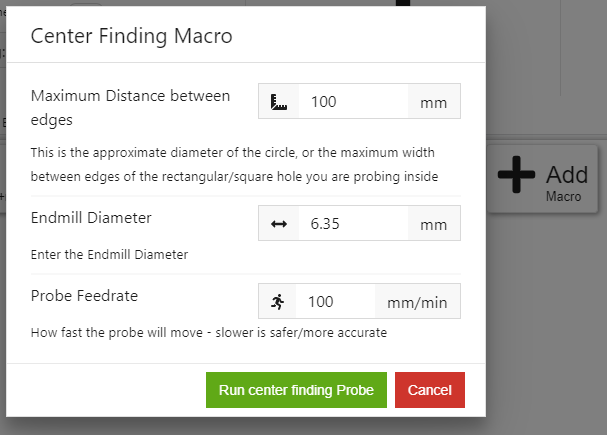

    Hi Guys
    Im sure i have already posted this but i cant find the original post.
    I am still searching for macro code for my blackox controller to probe center of a hole.
    does anyone have any code i can use?
    thanks

  7. Rob Taylor
    Rob Taylor Master
    Dec 15, 2013
    1,470
    746
    Depending on the precision required, you also need to be sure that the probe itself is both actually round (or oval, or otherwise of radial symmetry, I suppose, assuming it can't rotate freely) within some reasonable tolerance and of zero runout. Usually tasters/probes have runout adjustment screws to make sure.
    The probing routine itself is fairly simple:
    1) User sets approximate center of hole and appropriate Z height (ie. inside the hole)
    2) grbl probes one direction, say -X, CONTROL records the coordinate returned
    3) grbl probes the opposite direction, +X in this case, CONTROL records that number
    4) CONTROL does X/2 (or rather ((+X) - (-X))/2 + (-X)) and centers itself in X
    5) Repeat 2), 3) and 4) for Y.
    6) With a more reliable center and therefore less tangential force on the probe on the X walls, now re-probe X
    7) If that's significantly different (say, more than 0.1 or 0.2mm away), re-probe Y too.
    8) Done
    Not hard to write in JavaScript if you can get up to speed with the language or know someone who is.

  21. Peter Van Der Walt
    14,037
    4,122
    Finally got to it :)
    1) Go to Macros tab
    2) Click ADD
    3) Click the Javascript tab, paste the code below:
    4) Give it a name and an icon of your preference, and color, keyboard shortcut, etc if you so wish
    To use, jog endmill into the hole, approx in the center, down into the hole deep enough to make contact with the sides
    - NB NB ensure the sides of the hole are conductive and magnet is on the endmill/collet, the usual
    Can be used for circle, square or rectangular holes, after probing endmill will be in the center of whatever XY edges it found
    Code:

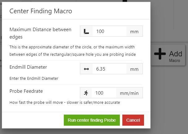

  22. Rommell1787
    Nov 9, 2020
    excellent Peter.
    how do I change the endmill diameter for the script? i don't have the same window above as you. my endmill is 3mm.
    thanks
  23. Peter Van Der Walt
    14,037
    4,122
    Finish setting up the macro button, then run it to get the window :)
