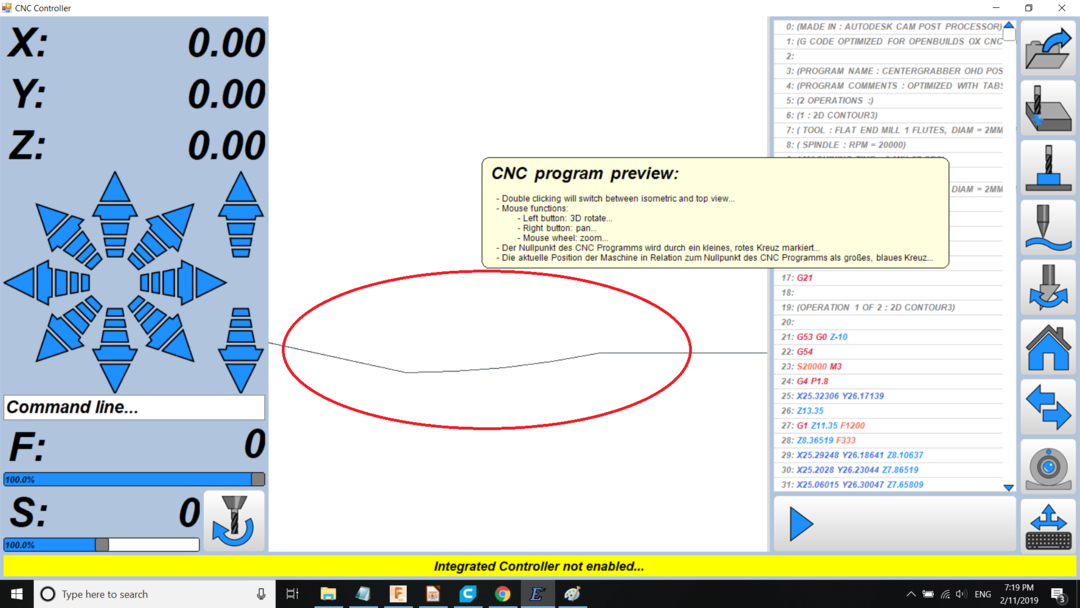

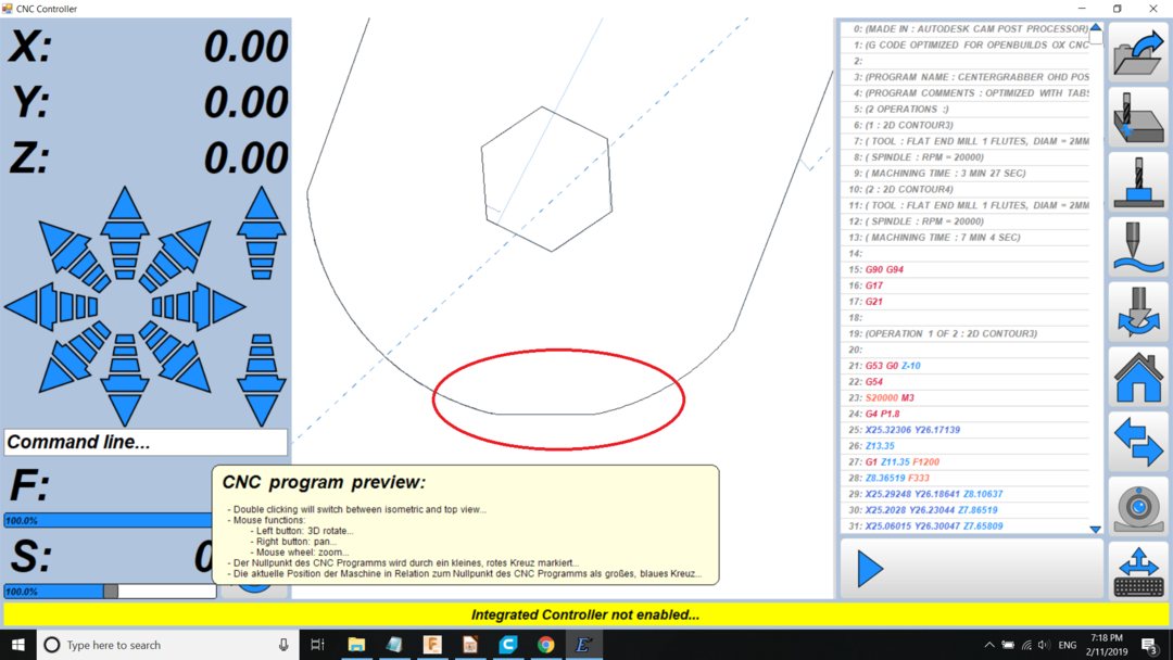

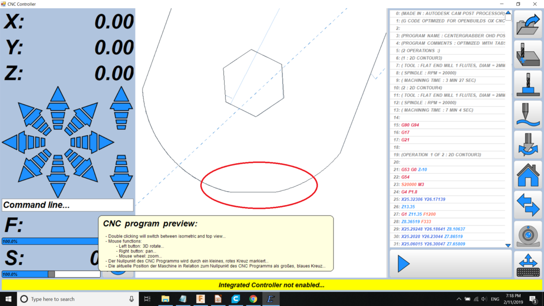

    Hello all - I'm having some very strange behavior on the Workbee 1510. The behavior is confirmed within the Openbuilds controller software as well. Basically it's not handling the circular motion well at all. It's cutting off circles and generally behaving badly. Why? I'm using the swarfer post processor from the location posted above. Attached is the example .nc file that verifies poorly in the controller software and behaves badly at the machine as well. I suspect it may have to do with ramping motion so I will try generating the path without any ramping approaches. I program machines for a living but this is all new to me with the arduino controller, etc.
    Can someone please try replaying the tool path in whatever way you typically use? For me, circles are not circles and it cuts off oval slots at the circular motion. What's happening here?

    14,571

    OK well that's somewhat of a relief. I will be testing some tool path at the machine today (unfortunately not located at my place - this is for a robotics club application)
    I had some similar issues with actual tool path though where it was not completing circles and producing some very strange results. I need to do some mechanical troubleshooting also though to be sure it's not a hardware issue such as a slipping belt pulley or something like that.
    The funky tool path was with the generic post in Fusion though. I will be testing the tool path I attached that was made with the swarfer post.

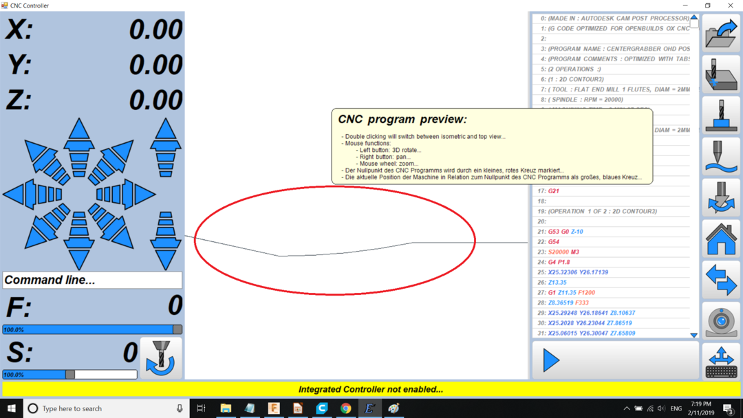

    Out of curiosity, I loaded your file in Estlcam to look at it. I noticed a couple things, but maybe they were intentional. First picture - in the red oval I made - there appears to be a flat spot.
    When I zoomed way in, there was another smaller change in direction. This may be nothing, and it has been awhile since I have used the CAM portion of F360, but in Estlcam I get errors if my lines aren't closed when I generate CAM from a .dxf file. Zoomed way in:
    CRCassell likes this.

    I have just run that file through bCNC to an UNO with GRBL 1.1 without any issues at all. Note this was not check mode, but actual cut mode, just without any motors attached. So there is nothing wrong with this Gcode.
    However....
    You will want to change your entrance methods. I am not sure how thick your material is, maybe 7mm? and Z zero is the bottom of the material? Anyhow, it looks like the tool may be entering the material outside the cutline as though there is no material there.
    If there is no previous operation clearing material away this will almost certainly break your 2mm bit instantly (-:
    I suggest strongly that you run this code on a piece of insulation foam before attempting metal.
    My post that you are using is a response to Fusion generating entrance arcs that are a fraction of the bit diameter in radius. This causes 'error 33' from GRBL from the default post since there are not enough decimal digits. My post increases the digits AND linearizes very small arcs to avoid these errors. Of course, GUI's like UGS can then break it again by reducing the number of digits before sending the code to gRBL, so make sure that is turned off.
    Now running in Openbuilds control 1...143 .....no errors, and display look sgood to me too.
