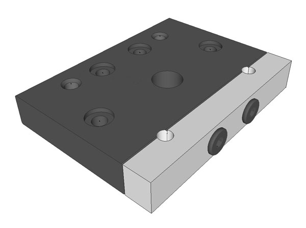

    I absolutely hate the Nema 23 only being held by 2 screws. Eventually I’ll do something about it. I’m actually considering hybrid closed loop steppers and even better steeper controllers. If I do that i’ll probably make the mounts a little more proper and secure.

    An alternative to the 2-screw mount (not that its an issue, works fine. If you are twisting it so hard that those are not sufficient you are doing something wrong hehe) checkout MiniMill Z Axis Upgrade with Offset Motor (ignore MiniMill, plate works on almost all C-beam setups

    While it's not a terribly attractive solution, additional mounting holes can easily be added by adding some 12mm deep bar stock to the front using the existing cover plate mounting holes and then drilling the required stepper mount holes.
    To make it a bit more stable I'd also probably be inclined to drill in another screw hole into the face near each end.

    I am just going to do this is solid aluminum plate I think to remake the bracket eventually.
    I need to 3D print the drill guide for the hole pattern

    I wound up going for a 3D printed version to accommodate 4 screws. I made 1 adjustment to the design after the fact to recess the nuts that will be used for the additional 2 holes. I figure this should get me by for awhile and should be better than 2 holes.
    Like Peter suggested for the Mini Mill, I am inverting the Z axis motor to save some height.
