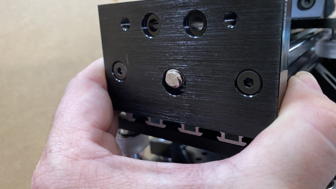

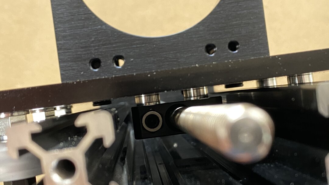

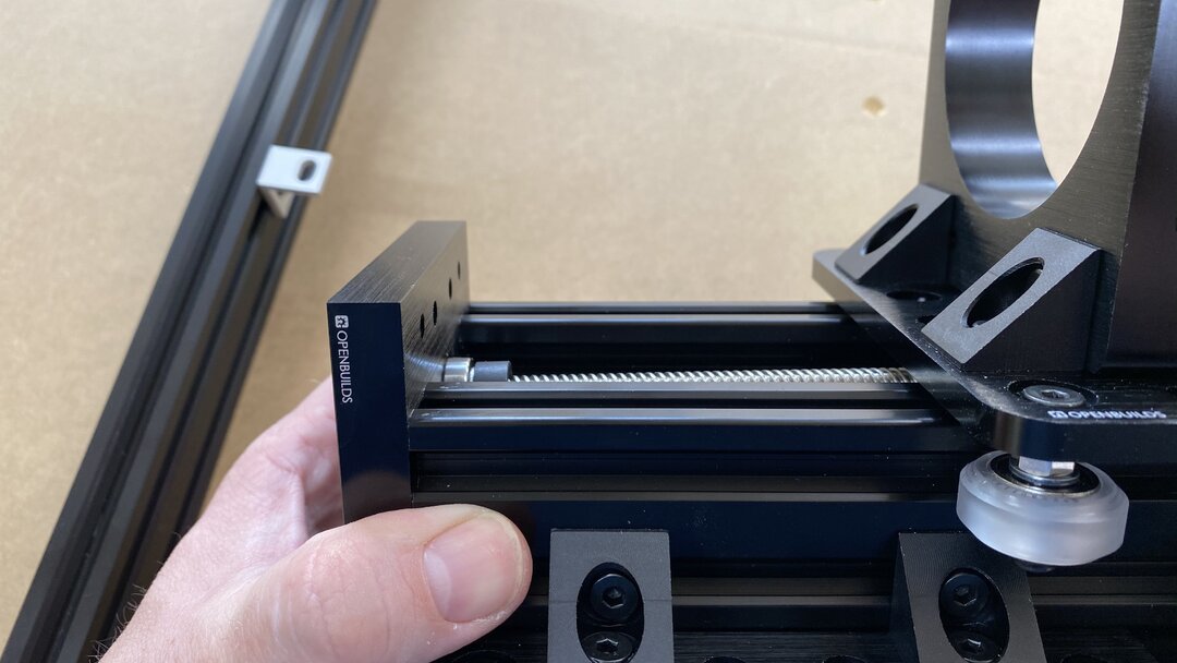

  25. Mark Mcleod
    Oct 13, 2020
    23
    Solved - Had the plate upside down. Leaving this here in case someone else does it too.
    Am I doing something wrong on the z axis assembly? The lead screw will have to be bent on both ends to make the bearing go into the slot. It seems like I need an additional space on the anti backlash nut to push that section away from the z plate. That would align the rod better. 9FF5A1CB-2054-4D37-9ACF-84FF068F46DB.jpeg BB71D24F-CF22-4676-B7C1-69683459FF03.jpeg 233670DC-F4DB-497B-9783-C4248B5E82C7.jpeg
  26. Metalguru
    Metalguru Veteran
    Dec 29, 2015
    752
    547
    You also should have only one precision shim on each screw of the nut block, not two...
    MG
  27. Mark Mcleod
    Oct 13, 2020
    23
    I just have one shim...the other is a reflection. I had to go outside and double check.
  28. Mark Mcleod
    Oct 13, 2020
    23
    Any thoughts on the gantry bowing out at the top?
  29. Metalguru
    Metalguru Veteran
    Dec 29, 2015
    752
    547
    It's never a good idea to force something to fit. The key to this whole thing is that if you have to force something into place using clamps, you have made a mistake somewhere and need to fix it, not cover it up by forcing the parts.
    The front and rear members of the base need to be the right length. The base needs to be perfectly square as well. Pre measure and check all pieces for length. The front and back need to be exactly the same length, all rails running from the front to back in the base need to be exactly the same length, and all the c-beams need to be the same. You also need to check the ends of the beams to make sure the cuts are perfectly square in both directions. I have found that most kits have at least some of the cuts out of square. This is less critical on a machine like this than on a machine with plates, like the Workbee.
    You have to check the length of the two X beams. They need to be EXACTLY the same length. Assemble the gantry first, making sure the verticals are exactly square (both directions) with the horizontal c-beams. Use a trusted framing square to check during assembly. Once you have it assembled and square, then insert the two c-beams (so it looks like a large "H" from above) into the Y carriages, space them evenly, and measure across each end of the Y beams. (make sure wheels are preset to have no play) The measurements on the front should be exactly the same as on the back of the "H" and in the center next to the carriages. You may need to adjust these until they are perfectly parallel by squeezing the wide side or adjusting some hardware. You also need to make sure the upright is perpendicular to the y axis c-beams, measure from the same points on the top corner to the end of the c-beam front and back.
    Gantry
    /__ |_ _\
    C-beam
    Once you have all this square, assemble and square up the base. Measure from corner to corner to establish square. Then set the Xaxis assembly with the Y c-beams on top of the base, and align the 4 corners to have the same offset, and tighten the angle brackets to hold them. There should be no "forcing" required.
    Your front 20x40 beam may be bent, extrusions are sometimes bent or warped due to the extrusion process. Check it against a 5 foot framers level, or other known perfectly straight edge. If it is bent, have OB replace that beam. It may be that the ends of the front to back beams were not cut square or the same length, and are pulling it out of line.
    It is imperative that you have a perfectly flat surface to assemble the base on, or you will have issues with flatness of the bed.
    This is one of the down sides of this design, there are too many angles and corners that need to be perfectly aligned to get the machine to track properly, and the extremely long extrusions are more prone to being bent or twisted.
    MG
