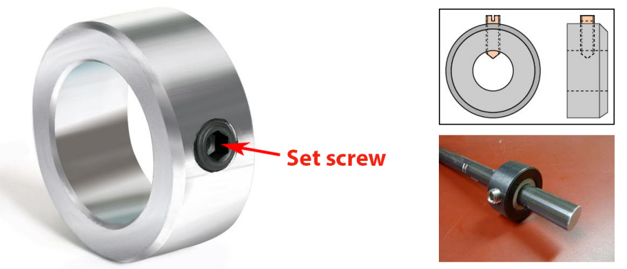

  13. Bilrob
    Bilrob New
    Aug 12, 2020
    Sorry to ask, I can speak and write english but my native language is french. What are grubscrews? I looked on the Openbuilds part but they don't list that.
  14. Rob Taylor
    Rob Taylor Master
    Dec 15, 2013
    1,470
    746
