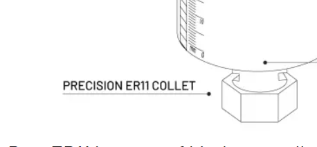

    The description on the website for the RoütER11 is pretty basic. What advantages does it have to the Dewalt or Makita? Is their anything I would gain from pulling the dewalt (and using as a trim router) and replacing it with this?

    Well I am thinking the ER11 collet is the prize. I have a whole gaggle of ER11 collets that came with my 500 watt spindle that would be great to use.

    Seems like primarily it's a CNC-oriented trim router. The ER11 collets and the 6003 bearings (plural... Nice) seem to be the major features. Proper spindle bearings is a big deal for a router like this for low runout and rigidity, especially on aluminum. Anyone who wants to mainly work metals, this is the way to go if you don't want to go VFD.
    Would be interesting to know why there isn't a direct hookup to the ESC for computer speed control, that seems like a bit of an oversight at this point but maybe it's slated for a V2, or maybe there's a simple DIY method of tapping into the potentiometer (if the dial actually is) and replacing it with PWM or analogue.

    Sweet! I have a suspicion - judging by the looks of the RoütER11 - that the ER11 thingy may fit my Makita! Please say this is true. :) Also, does this mean there will eventually be an OpenBuilds 65mm spindle mount rather than the sleeve?

    Sorry man but this shaft was made for the ER11 collets and collet nut :) I am seeing one of these mounts from OpenBuilds in the future but I have to say it's really nice to just get it and put it in place with the sleeve and get back to making.
