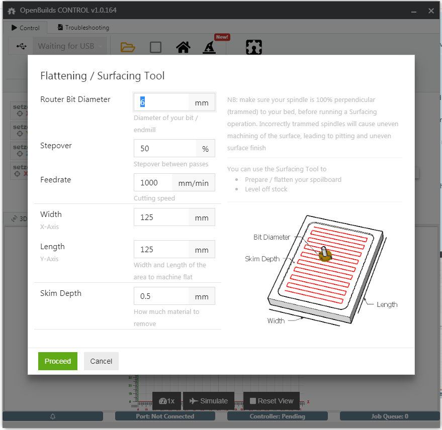

    I am trying to set up the surfacing wizard for my table, Workbee 1510. The question I have is what location does the machine need to be in to start the job? The gcode references G54 pre set, but I have not preset that and want to be sure before running the job. Thanks!
  7. sharmstr
    2,059
    1,448
    When you launch the Surfacing wizard, there's an image in the lower right that shows you where 0,0,0 is which is the lower left. Technically the spindle can be anywhere when you start the job, but it will move to where you have set G54 X0, Y0, Z0. From there, as noted in the image, it will move X+ direction to whatever you put in the "Width" input (minus bit radius I believe). Then it will move in Y+ direction to whatever your put in "Stepover". Then it goes in X- direction, the Y+, then X+ etc until you've reached Y+ whatever you put in the "Length" input (minus bit radius I believe).

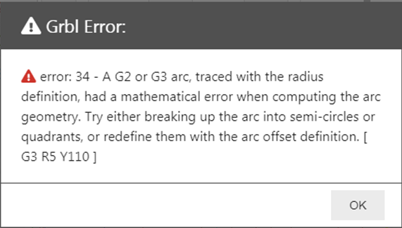

    Soy nuevo usando el programa y es mi primera maquina CNC que estoy construyendo, al usar este programa me salta un error el cual me dice que los codigos G2 Y G3 no los puedo usar, que hago en ese caso. No se si estoy utilizando mal este programa par realizar las figuras que tienen radio.
  10. Peter Van Der Walt
    14,701
    4,249
    Please use English.
    If i understand correctly from google translate, you are trying to use gcode from some other source than our software. And that gcode has invalid g2/3 moves in them. No screensshot of the error, so i am guessing its from Grbl not CONTROL and probably means your gcode was not obtained from Grbl compatible post processor or CAM software.
    Grbl understands a subset of GCODE, use a Grbl Compatible CAM/Post

    Hi thanks for answer me, I'm doing probes in my costume CNC but the problem is when I upload the GCODE, for example: a circule, the program showed me this error. And I want to know how can fix it.

    The problem, as Peter has explained, "means your gcode was not obtained from Grbl compatible post processor or CAM software."
    What software are you using to generate the gcode?

    Yip, thats Grbl not liking your GCODE:
    Read more here: gnea/grbl (Grbl generates the error, send it to the GUI and we just display it to you
    Grbl prefers "G2/3 IJK" format - not the R (Radius format) as you are trying to use (Refer G2 and G3 errors. · Issue #897 · grbl/grbl)

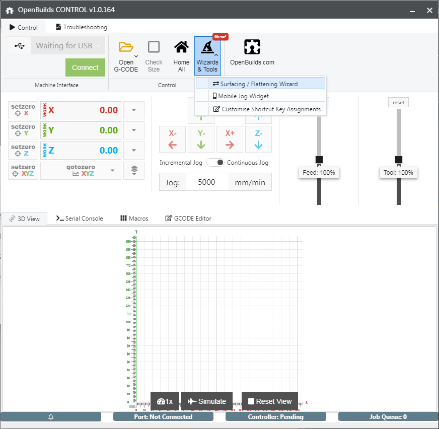

    Click Wizards and Tools > Customize Keyboard Shortcuts

    Wizards and tools > Mobile Jog Widget
