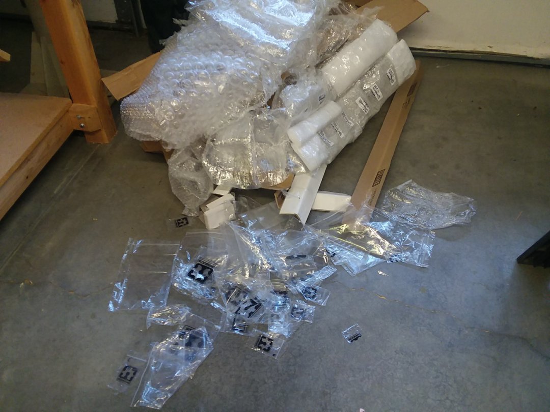

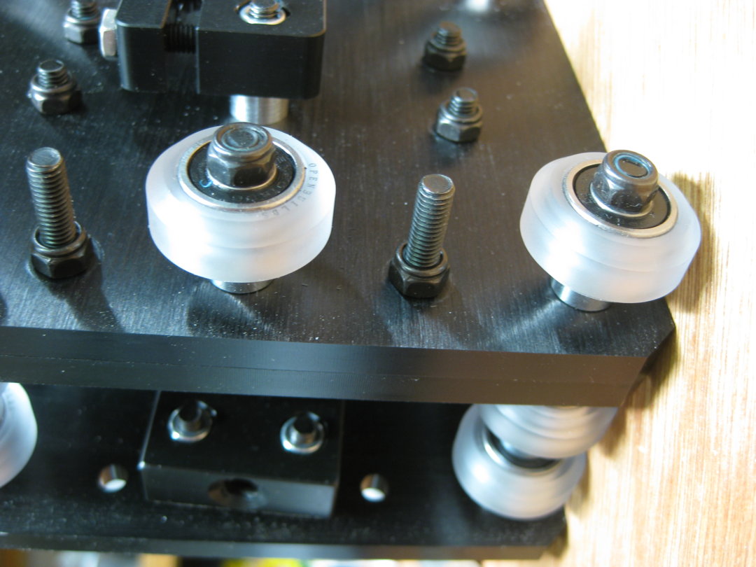

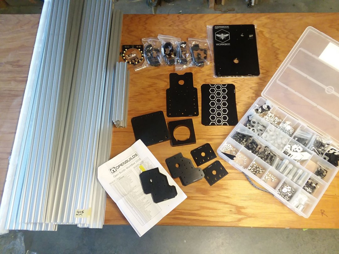

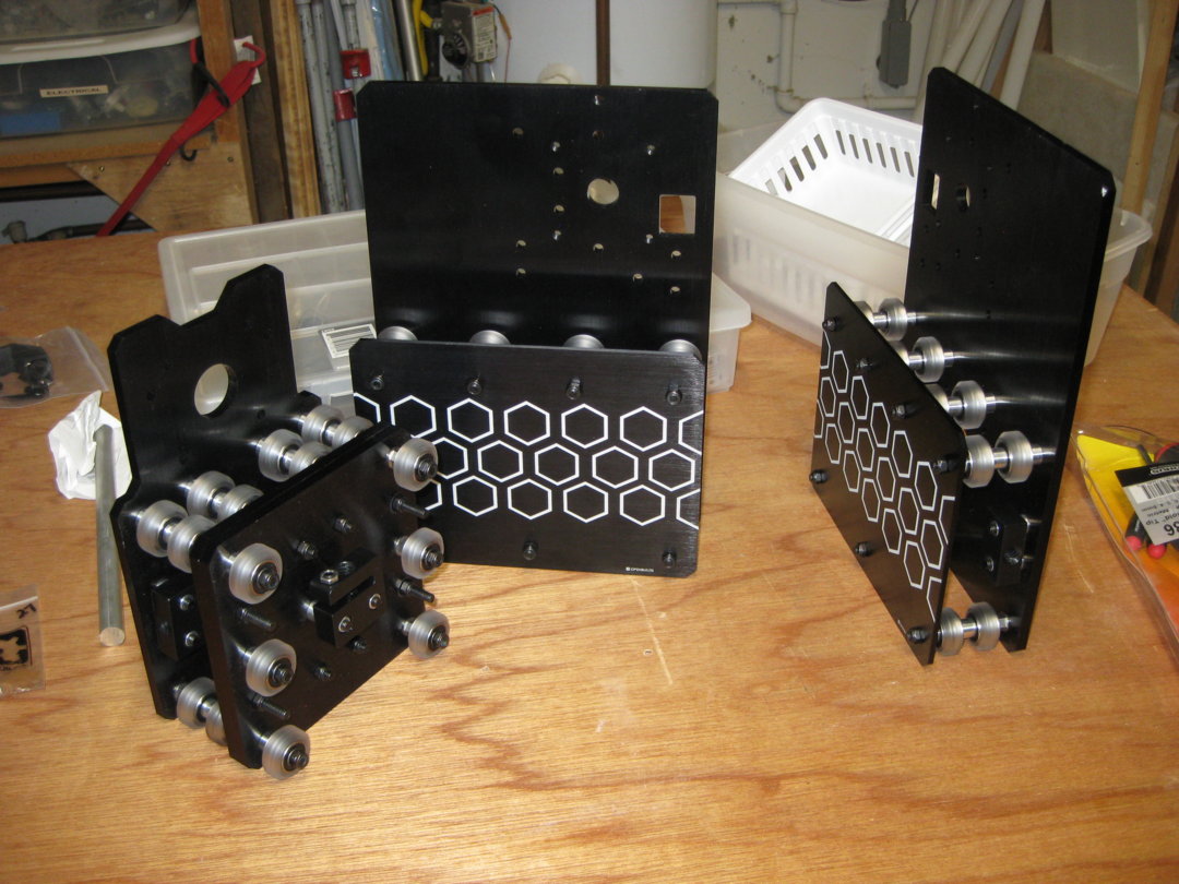

    Kit arrived Friday. Unpack Saturday afternoon and started with Y gantries like Matthew's build video. While building the X-Z combo I hit a snag, my kit is missing 2 6mm spacers. A friend tried to machine these today, but my Home Depot aluminium round bar stock was crap. He'll remake these spacers tomorrow with 6061.
    I discuss one build change at 27:30, I used 30mm M5 screws to mate the Z plate to the X plate.
    This will allow for a dust boot attachment that stays in 100% contact with the work piece, ie doesn't move up and down with Z.
