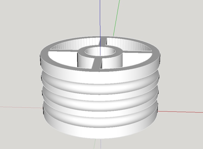

    Where did you get the friction wheels from ?
  6. pedrofernandez
    pedrofernandez Journeyman
    Builder Resident Builder
    May 14, 2017
    148
    221
    First wheels i got them from Randy Smith of HM laser he makes rotary devices, but it is super simple to make them, basic sketchup skills using the follow me tool will take you there, im not posting the wheel file yet until im 100% happy with it
  7. 3DPTR
    3DPTR New
    Jul 23, 2018
    Ok thanks. What size o-rings did you use?
  8. pedrofernandez
    May 14, 2017
    148
    221
    O-Rings Nitrile Rubber, 40mm Inner Diameter, 50mm OD, 5mm Width
  9. 3DPTR
    3DPTR New
    Jul 23, 2018
    Thanks. I will look into ordering some. Also where did you get the wheel hubs from for the 8mm shaft?
  10. pedrofernandez
    May 14, 2017
    148
    221
    those are 20 teeth 10m wide 8mm bore Gt2 pulleys , just remove the flange and press into the wheel
