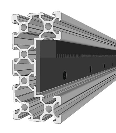

    I really would like to see more of how this low profile rack and pinion could be used with the C-beam and would like to see if Openbuilds would be interested in offering an affordable rack and pinion combo. Either way I would be interested in knowing who supplies the low profile rack and pinion as this is a direction that I would like to take. I think that a helical rack and pinion would be better but if I can at least get a link to the supplier that would be great. I am not an engineer but I know that a rack and pinion set up like this could easily provide a huge improvement to the linear drive mechanics of a DIY machine, not only will it improve cutting capability but it would also greatly reduce backlash

    I suggest moving the rack inside the C-beam. You don't need to add extensions on the wheel spacers that way. Also teeth facing down decreases the potential for debris collecting in them.

    To reduce debris you could also add some sort of brush set up or way covers of some sort.

    Here's the solidworks pack and go of the concept. Mmcaster p/n are located in the assembly tree. Keep in mind that this is just a concept design. Following my goliath upgrades, I'll design and cut a custom plate with 6mm 6061 AL. The current carriage uses a modified C-beam plate, with some cut extrudes for holding the nema23.

    I like the idea. Anything to decrease the moment load on the carriage is a win. Debris could be an issue as well, like you mentioned. The only annoyance is designing around the COTS gear rack and pinion. It gets tricky with the packaging/fasteners when you throw it on the inside. But its worth investigating..

    The eccentric nuts and squish from the wheels could cause misalignment, or non optimal gear meshing which would lead to inaccuracies in the steps/mm or backlash. This wouldnt really be a problem with a 3d printer since theres virtually no load, but its an issue with CNCs.

    I have no means open the file to check the McMaster PN's but I have yet to see a 4 foot (20 degree) section gear rack that is NOT $50 or more each.
    You mention a $20 gear rack - but how long is it or where is it purchased from?

    Based on this design, you are using a pinion with 16 teeth/20 Pitch and a pitch diameter of 0.8" so for each rotation the Axis would move 2.513" (63.83mm) if Stepper motor was set to full steps, 1/1 = 200steps
    machine positioning accuracy is 3.13 steps per mm, or 0.319mm /step
    Compared to current 8mm Tr8*8-2p 4 Start Acme screw used, an Axis moves 8mm per rotation, if Stepper motor was set to full steps, 1/1 = 200steps
    machine positioning accuracy is 25 steps per mm, or 0.04mm / step
    We basically need a 8:1 gear reduction for this rack/pinion to match current Acme system accuracy
    Compared to the CNCRouterParts R&P Pro system they are using a pinion with 20 teeth/20 Pitch and a pitch diameter of 1" so for each rotation the Axis would move 3.141" (79.796mm) if Stepper motor was set to full steps, 1/1 = 200steps on its current 3:1 Gear reduction (ie 600 steps/roation)
    machine positioning accuracy is 7.52 steps per mm, or 0.133mm /step
    perhaps the real question is how much position accuracy is really required.
