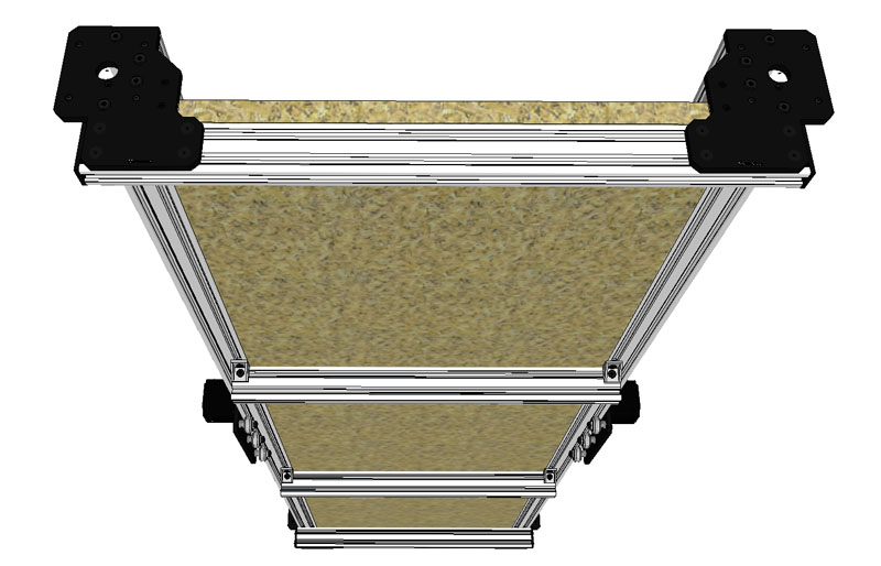

  17. Rick 2.0
    2,870
    1,533
    Really no 'risk' involved with cross bracing. It's actually very simple.
    Modified Sketchup file attached so you can better understand how simple what you're wanting to build actually is. Note, the file only shows a 1500mm version but you'll get the idea.
  18. mrpackethead
    May 17, 2020
    22
    Thankyou so much. thats really helpful! It helps me a lot to work out the exact parts list i need.

    Hi Rick, I started to draw up my machine, and was wondering if i'd be better to put diagonal bracing between the Y Axis rails? I think it woudl be an increadibly strong frame? I've not see joiners though that are intended for connecting at 45degrees? I'll finish the picture. I'm having to fight Sketechup.. never used it. I might bite the bullet and draw everthing in FUsion. since i know it.
  23. Rick 2.0
    2,870
    1,533
    Diagonals are not necessary. When you screw down the spoils board at all the cross members that provides all the rigidity you will ever need.
    BTW, diagonals are not difficult with the Adjustable V-Slot Hinge. (They're really not that good as hinges but make great angular connectors.)
