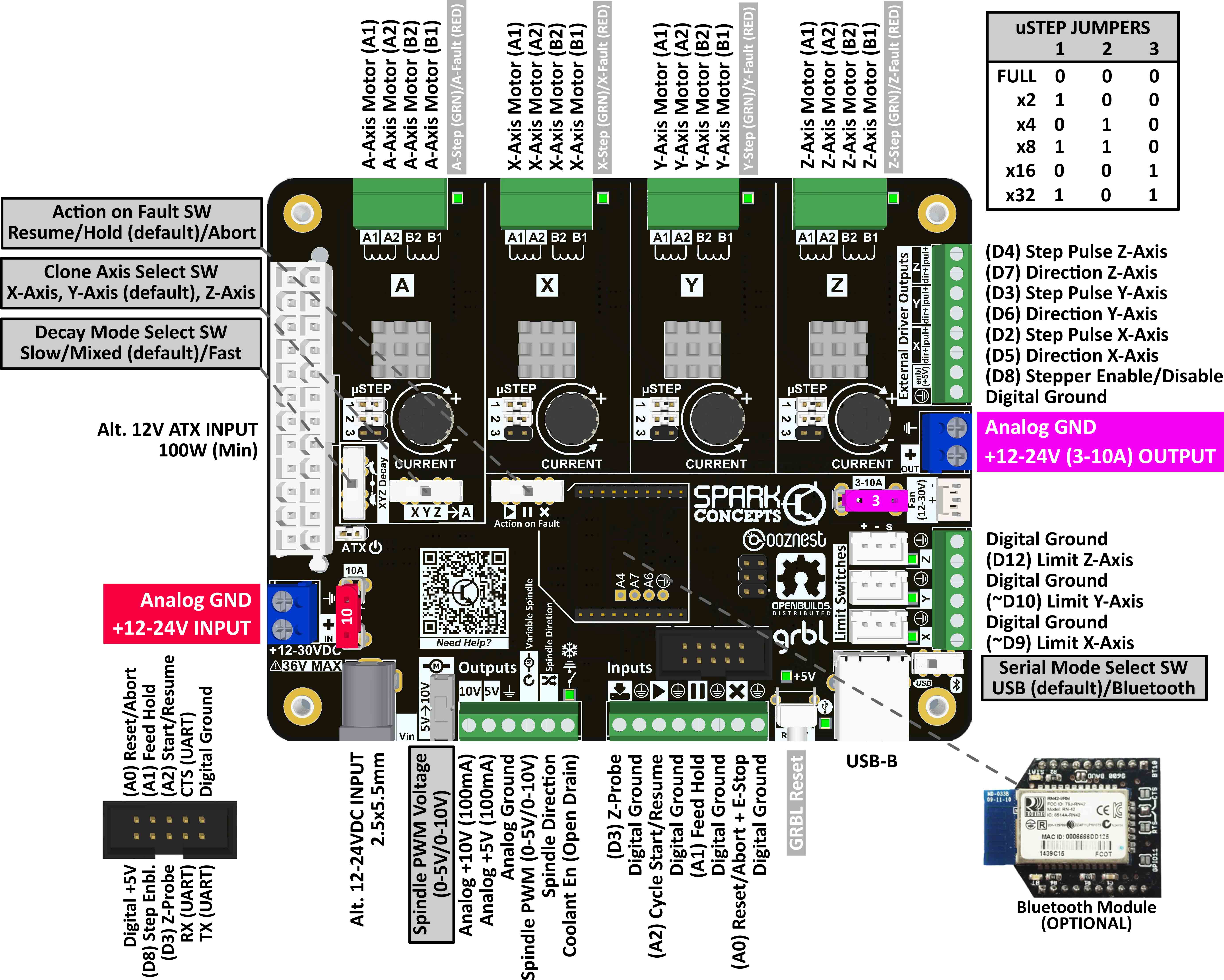

    Alright Bats, I’m lost. I’m to the wiring portion and realized that mark has the V3 in the video, and I’ve got the V4. I don’t have the slightest clue how to wire this thing up and don’t want to get it wrong. Is there a video or a write up on this controller? The diagram in the box doesn’t seem to match color wise to anything mark is doing on the V3 in the video. Attached is how I think the A motor is wired, but I’m not sure. Also, is this machine supposed to have feet? The nut on the L bracket for the drag chain digs into the table unless I flip the L bracket over. The machine in the video appears to sit above the table slightly, but I didn’t see a mention of feet. This thing is nice, but the instructions are about half a step up from going in blind.

    Unfortunately this is the point where my experience runs out. Not only do I have a V3 instead of the V4, mine still hasn't even been unwrapped, since I'm using the Gecko G540 from my previous machine. Hopefully someone with slightly more of a clue will jump in before I can do too much damage with my advice.
    The wiki at Spark-Concepts/xPro-V4 has at least a little more detail than the wiring diagrams on the parts store, and it looks like Spark Concepts also put up a build page for it on here, too - although I don't know how much overlap there is with the wiki: CNC xPRO V4 .
    I haven't seen much other discussion of the v4 around here yet, but I also haven't really been looking since deciding to stick with the Gecko.
    I have no idea how much the v3 & v4 differ, but I hope Mark won't be too offended if I say I strongly recommend following the wiring diagram any time the two disagree - just stick to using the video for mounting, wire routing, and making everything all pretty.
    When it comes to steppers, there are basically two accepted methods of identifying the right wires. One uses a multimeter to find the pairs of wires with the same resistance... and the other is to pretty much just just hook them up randomly, try it, and then swap them around until it works the way it's supposed to (powering everything down in between, naturally). Either way, the four-wire OB steppers make it pretty easy, compared to the six & eight wire ones I'd used before.
    This gives a brief summary of the two methods, and this is an archived copy of the dead link from the v4 wiki page, which goes into a little more detail.
    ...or you could be really clever and check the datasheet on the parts store page for the motors (which I didn't notice until just now):
    and combine it with the wiring diagram from the wiki and/or parts store:
    Going from the corner of the board, the A axis plug goes A1, A2, B2, B1 which I'm going to guess matches up with -A, A, B, -B (Yellow, Green, Red, Blue) on the stepper datasheet. If you try it and it turns the wrong direction, just swap yellow & green or red & blue and it should go the right way. Once you've got it working with one motor, it should be the same for all the rest. It's probably also possible to use software/firmware/jumper settings to change the direction, but I don't know enough about the board to be sure.

    @Dmhaes A couple of tips.
    1) For stepper wiring, to test which direction your steppers are turning be sure to avoid connecting the lead screw coupler to the motor shaft. This way you can test motor direction without worry about mis-direction especially with dual y-axis motors.
    2) No feet on the bed however to avoid the drag chain bracket from digging into the bed use the upper most end cap screw. This will give you another 10-20mm of spacing. This is what I did.
    3) I had the old V3 model, the V4 wiring should be the same. Don't worry about the order of the wiring connected to board connectors as long as you (a) make sure you have a pair that stops the motor from turning by fingers if you touch any two wires together and (b) follop tip #1 above.
    4) Once motors are connected and while following tip #1 you issue a move command to Z for instance another motor starts turning then simply swap that motor connector wiring... but I assume this was obvious.
    Don't worry, as long as you follow tip #1 you won't break anything. And if you hear the dreaded grinding sound from one of the motors it's probably because you have not identified the correct wire polarity pairs. In that case disconnect the motor and follow tip #3.

    Wanted to extend another thank you to everyone for the help, after a few head scratching moments, we’re up and running. Kudos to the Openbuilds team, this machine is top notch. On to figuring out the software end of things. Is anyone using f engrave or is fusion 360 the best free one?
