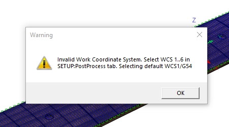

    Thanks for your help.... I generated a few tools paths and was able to run it on my machine in the control software and it operated no differently than when I run gcode generated out of Vcarve Pro.
    The one issue I had which I think is a user issue in Fusion but when I go to post process and save I get this pop up:
    Warning:
    Invalid Work Coordinate System. Select WCS 1..6in SETUP.PostProcess tab. selecting default WCS1/G54
    I know I am diverging into the Fusion 360 black hole.....

    That's just telling you that you didn't set which work co-ordinate system you wanted to use in the cam (manufacturing) section of Fusion, and it's going to use the default. If you want to stop that there is a setting in the first part of the setup in manufacture - post process - which gives you the option to set the wcs. I recommend setting it to 1 (the default anyway)

    Thanks Alex - is there a better place here to discuss this? I would like to know if when I go to post process do I always have to select the post processor for the OB Box the .cps file as well as this WCS?
  7. David the swarfer
    3,288
    1,837
    not whenever you do a post, whenever you do a 'setup' within fusion.
    yes you can just ignore this warning on the assumption that you will always use the G54 work coordinate system.
    However, I must advise you to get into the habit of setting the WCS in every setup because if you don't that one vital multi setup job that requires something other than G54 will waste a lot of time and material when G54 is assumed <-:
    it is 2 extra clicks.... create the setup then in edit select the 'post' tab and set the box to '1'. that is the only addition to the normal stuff you edit on a setup.

    In SETUP is this what your speaking about (first image or second or both )? I am a new born fusion 360 user.

    As per the message:
    Ie the Post Process tab, of Setup: :)
