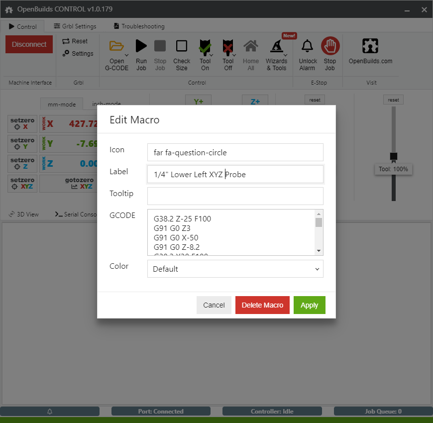

    On my way home today I was trying to figure out a good way to get a repeatable way to get Zero on a fixture I was going to make. Would it be possible to add probe X and probe Y Like how we have probe Z?
  18. sharmstr
    2,039
    1,434
    Yes. We do it with macros. I set up mine using the docs from Ooznest. The only thing you need to do is swap out all the semi colons with new lines and add G90 to a new line at the very bottom.
    Setup a XYZ Touch Probe with a CNC xPro Controller
    There are two docs at the bottom that will help you sort it out.

  19. mrp192
    mrp192 New
    Oct 15, 2018
    33
    Awesome, Well I kinda got it to work. But after it touches off I have to home again for it to goto Zero. and its off in X and Y.
    G38.2 Z-25 F100
    G91 G0 Z3
    G91 G0 X-25
    G91 G0 Z-8.2
    G38.2 X30 F100
    G91 G0 X-3
    G91 G0
    Z8.2
    G91 G0 Y-25
    G91 G0 X25
    G91 G0 Z-8.2
    G38.2 Y30 F100
    G91 G0 Y-3
    G91 G0 Z8.2
    G10 P0 L20 X34.236 Y-15.628 Z8.48
  20. sharmstr
    2,039
    1,434
    One other thing I forgot. Add G90 to a new line at the bottom.
    "But after it touches off I have to home again for it to goto Zero" I dont understand what you mean. Are you saying that you want the tool to move to Work 0 after the probe finishes? If so, add it on a new line after G90.

    If it's off in X and Y did you change the offsets in the G10 line to match your probe and bit dimensions?

  23. sharmstr
    2,039
    1,434
    Hmmm. Not sure why that would be. OB Control issues a G21 G90 to start the move so even missing the G90 at the end of your code should be ok.
    What does the serial console say?
  24. mrp192
    mrp192 New
    Oct 15, 2018
    33
    G90 did fix it. Now I just need to mess with the X offset. It is like 25mm away from where it should be.
  25. sharmstr
    2,039
    1,434
    Since we are straying from an OB Control convo, lets take this to a new thread or to DM.
    Edit. I see you changed the X and Y movements to 25mm instead of 50mm. But it doesnt look like you accounted for that in your G10 line.
