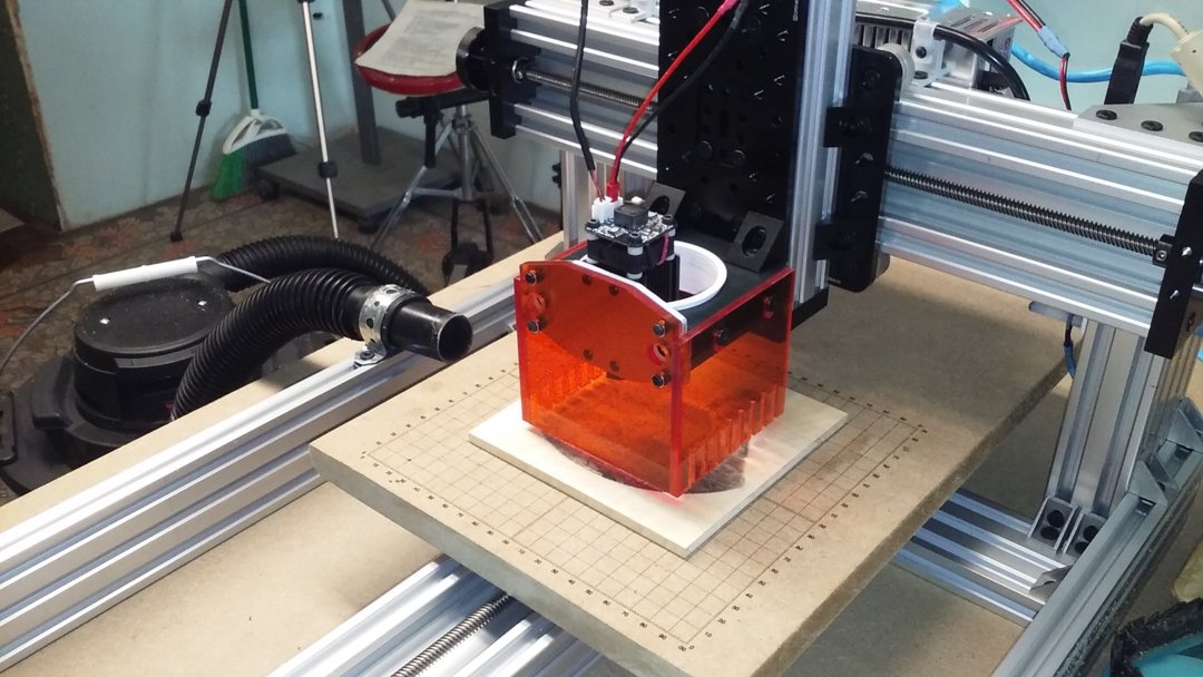

    It depends some on what spindle you are using. I am using a Makita router mounted in an OpenBuilds spindle mount. I cut out a plate to mount my laser on the spindle mount. No change in electronics except for setting laser mode on my controller. The swapout is pretty easy for me.
    Laser Adapter for OpenBuilds Spindle Mount
    Here is a picture of it with the shield attached:

    It won't be exactly the same. I do not use PWM speed control for the Makita, so I just leave the cord connection for PWM control of my laser plugged in to my controller (Gradus M1 Pro, but it's arduino based and runs grbl like many other boards). If you will be controlling your spindle speed with PWM, the laser will use the same pins, so you'll need to fix the cord to be swappable between the spindle and the laser.
    The only other thing I do is (in grbl) set $32=1 when using the laser and $32=0 when using the router. (Since I don't use speed control on the router, I'm not sure if there are other variables to set for that or not.)

    Should be able to use the same control board. Not sure about implementing a switch since you have a spindle with a VFD. From what I've read, sometimes the wiring for a VFD can become more complicated than simply plugging in to the D11 pin (spindle PWM).
    Also, not sure you mean "gcode" when swapping. (I doubt you would want to change over while executing a g-code file.) All I change is in the grbl configuration parameters (grbl settings). $32 enables/disables laser mode and that's the only configuration parameter I change when swapping. LaserWeb makes it easier by allowing you to define machine "profiles", but since I'm only changing that one setting, I don't bother with profiles.
