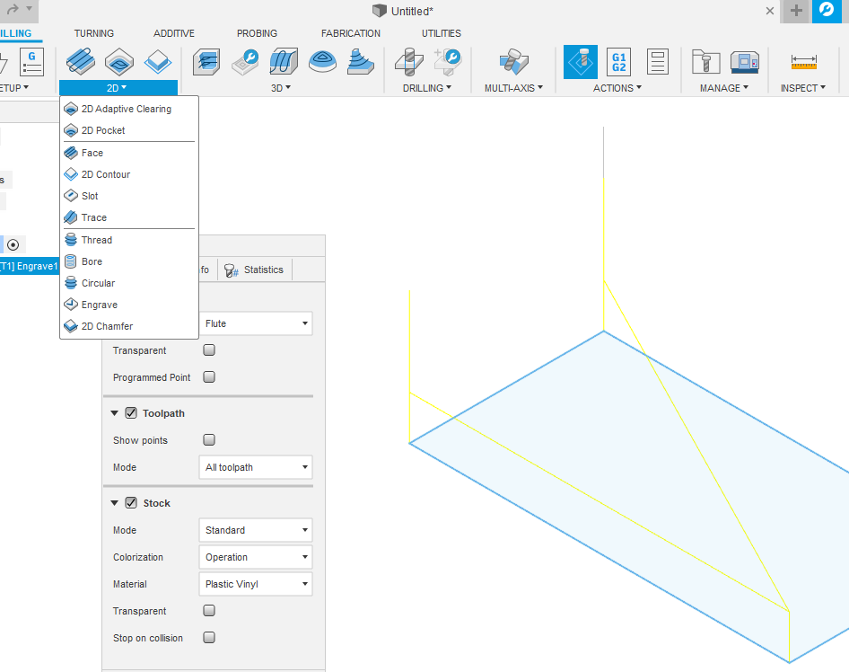

    Hello all!
    I'm quite new on this forum and am also new to building drawing machines, etc. I just finished building a drawing robot based on this design: Drawing Robot - Arduino Uno + CNC Shield + GRBL by henryarnold
    I'm using SourceRabbit Gcode sender to send the Gcode to the machine, but am a bit stuck on how to convert my .svg's, dxf's, .ai's, .eps's, etc to Gcode. I was hoping to use Illustrator but that seems to not work.
    I am also learning Fusion360 which I am loving and would love to know: would it be possible convert a sketch in Fusion to Gcode? I presume it's through the "manufacturing" workspace, but am having trouble going from there....
    Has anyone here had success in doing this? Or any other advice for best ways to turn vectors into Gcode?
    (I also know how to use Rhino...not sure if that could work?)
    So grateful for anyone that might have advice!

    I do not know how to do a simple engraving type tool path in Fusion. You could always export your drawing as a .dxf and open it in F-engrave (free opensource). I do a lot of drawings by attaching a pen to my CNC router and using an engraving tool path. I call the pen a 1mm endmill and use a 0.2mm depth of cut. I start with a .dxf. At the beginning of the video in this project you can see what I mean.

    Never tried it but;
    Giarc likes this.
  4. Giarc
    2,923
    1,620
    Brilliant. I don't know how I did not see that. :duh: It has been a long time since I generated gcode with Fusion. I am rusty.
