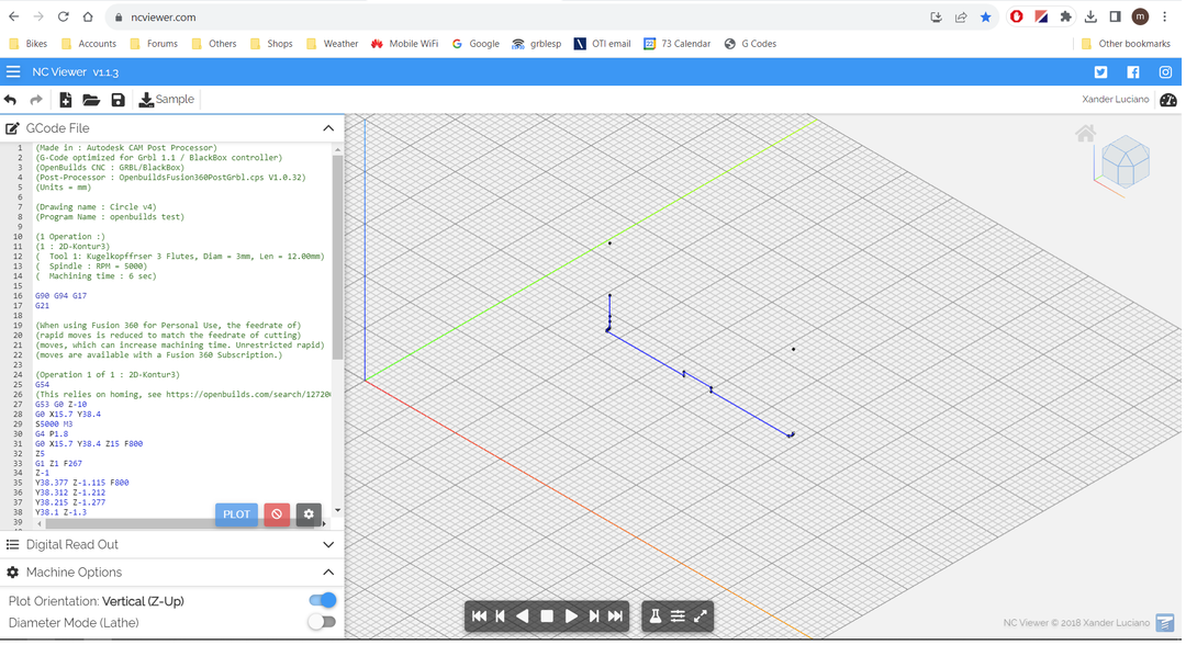

    i currently run in to problems post processing my CAM toolpaths from Fusion 360 in to Open builds.
    When i use grbl post processing it stops the operation somewhere in the path always at the same point.
    When i use Openbuilds post processing Fusion 360 puts out a error message and the code doesnt run at all.
    im Currently using a MKS DLC32 mainboard with MKSLaserTool Drivers and a Proxxon Spindle

    That is not an error message - it is telling you that you didn't set a workplace co-ordinate system in Fusion cam set up, so it is selecting the first one (G54) for you - the code should then run.
    To help us work out why the file won't run please upload your g-code files, telling us which was created with the grbl post processor and which with the Openbuilds one..
    Please clarify whether you are outputting code for your spindle or for a laser.

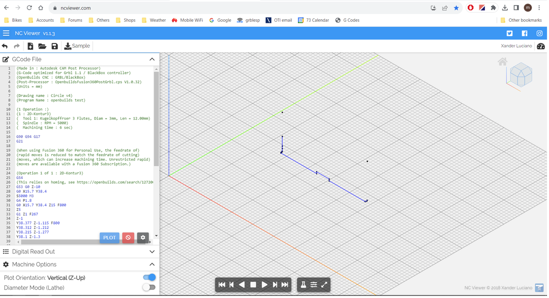

    Jun 4, 2023

    Both of those GCode files are OK, and either should run through without problems.
    If your machine is stopping, it may well be EMI
  6. Alex Chambers
    2,702
    1,329
    As @Misterg said, the only unusual thing I spotted in the file post processed with the grbl post was a couple of arcs in the YZ plane. I would recommend sticking with the Openbuilds post processor.

    The GCode you posted previously cuts a line with a step in it and then stops - about 6 seconds.
    What are you expecting it to do? - Post your F360 file and describe what you're trying to achieve if you wish.

    I can't see anything in that g-code that would cause that issue.
    One thing that puzzled me in your first post (I don't know anything about your control board apart from the fact that it is an ESP32 board) was that you mentioned that you were using "MKSLaserTool Drivers and a Proxxon Spindle" - why the Laser Tool Drivers?

    cannot see anything wrong with the Gcode, but I do see that the post version is 1.0.32, the latest is 1.0.36, please upgrade so we are all using the same post.
    docs:software:fusion360 [OpenBuilds Documentation]
    a little snippet of your Gcode
    Code:
    (Operation 1 of 1 : 2D-Kontur3)
    G54
    (This relies on homing, see https://openbuilds.com/search/127200199/?q=G53+fusion )
    G53 G0 Z-10
    G0 X15.7 Y38.4
    S5000 M3        <--------------------------- that is turning the spindle on at 5000 RPM
    G4 P1.8
    G0 X15.7 Y38.4 Z15 F800
    Z5
    G1 Z1 F267
    Z-1
    [/code
