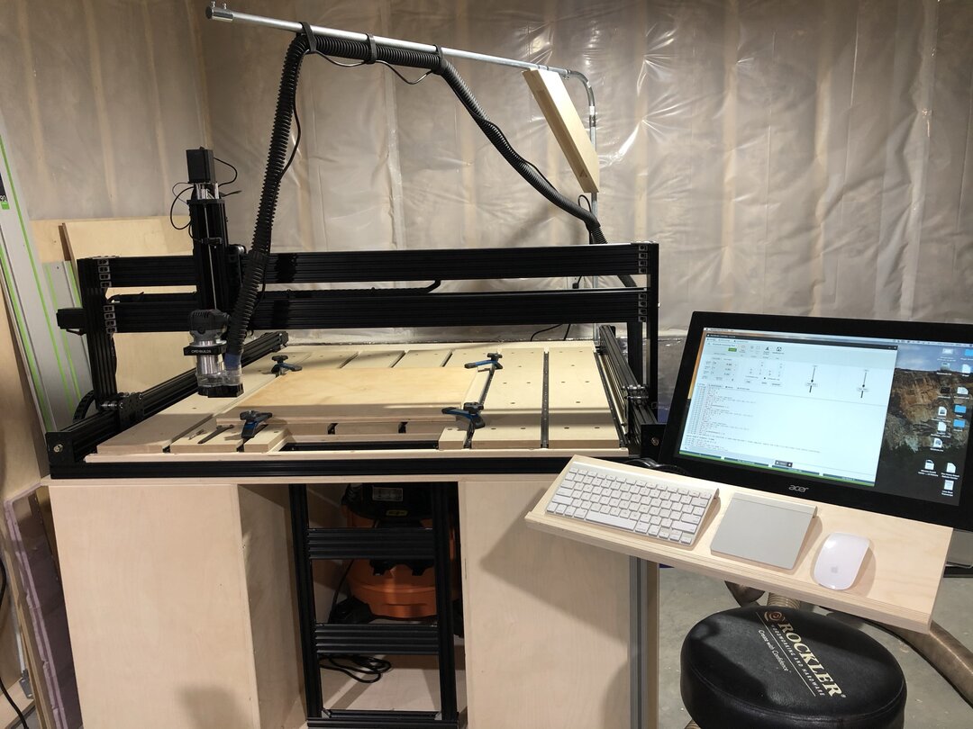

    New spoiler board going on. Adding t-rail between boards and 1/4” bolt down points through out.
    top layer will have a grid etched into the top for alignment.
    between layers of the spoiler board there will be t-nuts embedded into the board.

    Nice looking machine. I like the setup.
    Here it is completed. Will run the SB surfacing tomorrow.

    Was getting some wavy readings from the spoiler board. I have a 3/4” Baltic Birch screw through to the torsion box below the frame. With a 3/4” MDF middle, and a 1/2” MDF top. Was getting about .5-.8mm variation from end to middle. And then back to within .1 at the far end. So decided to beef up the spoiler board, since I beefed up the rest of the machine.
    solution? Let’s turn the machine base into a torsion box. So. Baltic birch torsion box on the bottom, an aluminum torsion box on the middle, and then the spoiler board on top. I’ll take measurements and report the results, but it’s gotta be better!
    Cross supports every 300mm along the length of the frame. 12 500mm 2040’s. And some angle connectors.

    Quick update. Where I was getting .6-.8mm prior to the supports, now it’s about .15-.2 after. So much better. Once I change the Z axis, I’ll surface the spoiler boards to take that all out. But, it is much stiffer now.
    Tonight, added a new dust collector system to the machine. Replaced the wet/dry vac with a 2hp 2 stage dust collector. Installed the dust collector in the garage, and ran a 4” line in to the cyclone I installed under the machine. And I’m adding a sweep port by the front of the machine to ease floor clean ups.
    Line ready for hook up tomorrow, as I ran out of 4” hose. Need another segment. All controlled by the coolant IoT’s.
    Tomorrow, starting to mill the side panels to finish up the machine. Also changing the ball screws to sfu1610’s from the 1604’s and having them custom machined so they will be fixed on both ends. (Thanks to @Rob Taylor for the assist with being a sounding board for ideas!). So, I have the ball screw now for the Lead Lathe I’m looking to build, based off of @Giarc design.
