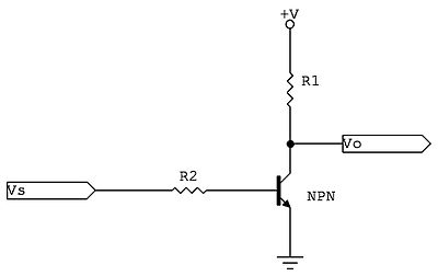

    So BlackBox GND to G
    BlackBox PWM to input of your self-built Inverter Circuit, output of Inverter to L on LPS

    Right now I have the G to G and 5v to 0-10v connected to the Blackbox. I found a diagram from Cohesion3d showing that only the Ground to Ground, and L to Laser Fire on their board needed to be connected. Assuming the same with Blackbox would only the Ground and 0-10v(brought down to 5v) be used? Does the DIR need to be connected too?

    The 0-10v is doe VFDs. What you have there can damage either the BlackBox or the LPS.
    DIR is not used.

    No no, the 0-10v output is +-10v, you cannot turn it down that far! See docs:blackbox:connect-vfd [OpenBuilds Documentation] - its for spindles, not lasers :) - please remove all your wiring from the 0-10v output right now before you damage the BlackBox or the Laser PSU.
    Just GND and PWM (via an Inverter circuit, not directly) - as explained above at post #4 K40 - BlackBox wiring!
    The 5V/IN/G outputs of the LPS goes to your Panel potentiometer for power fine tuning, usually a 10-turn potentiometer
    The controller DOES NOT connect to the 5V pin === that is a 5v power output - connecting that to the BlackBox's 10v output is 2 outputs fighting each other - one wins, the other gets destroyed (expensively)
