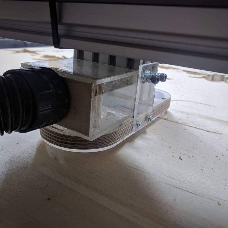

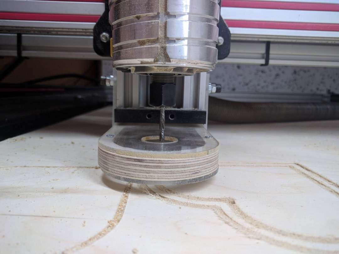

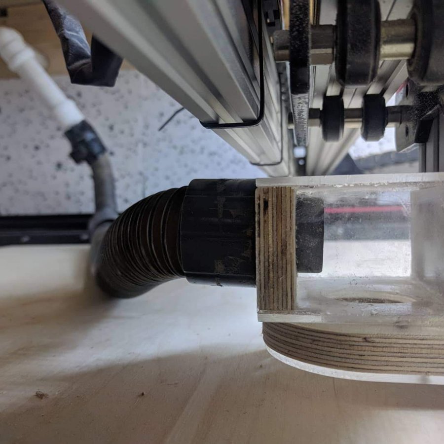

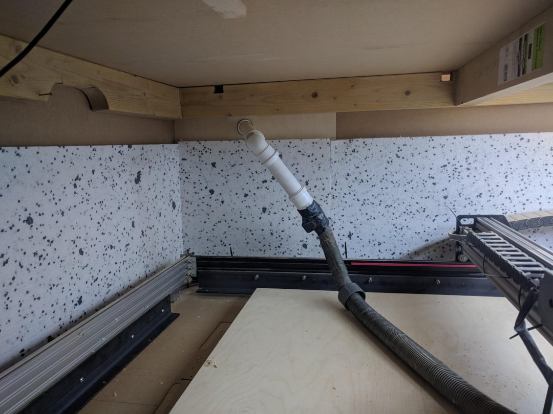

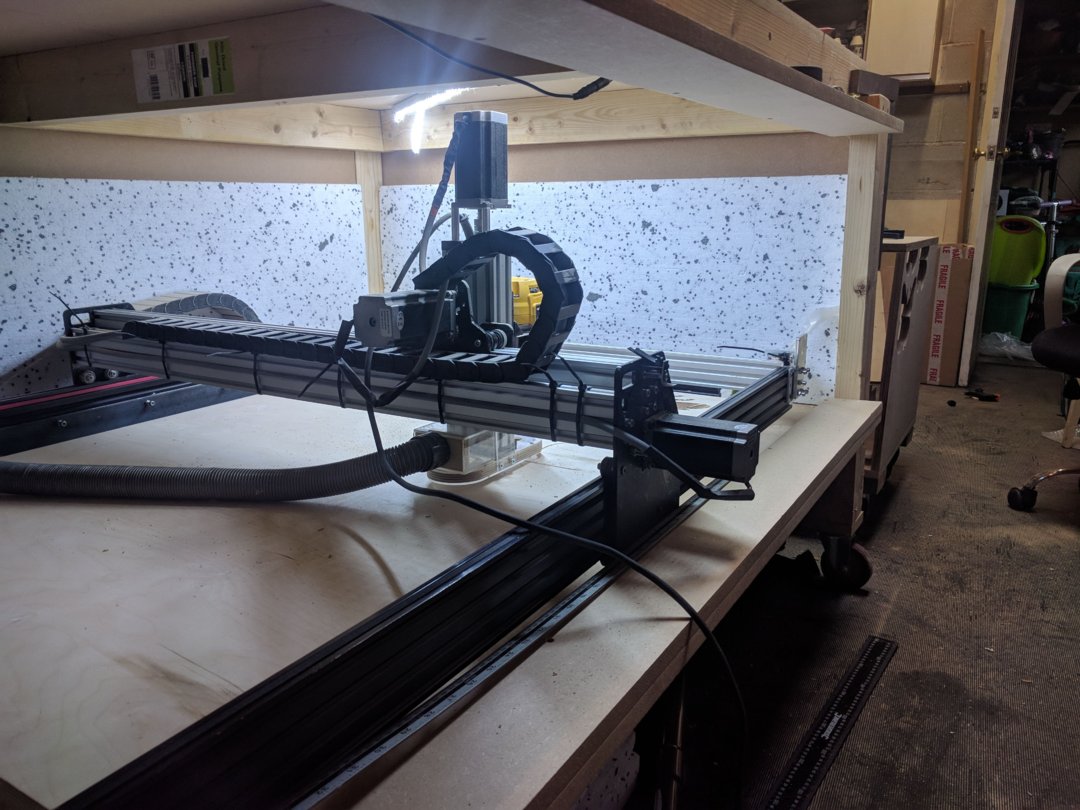

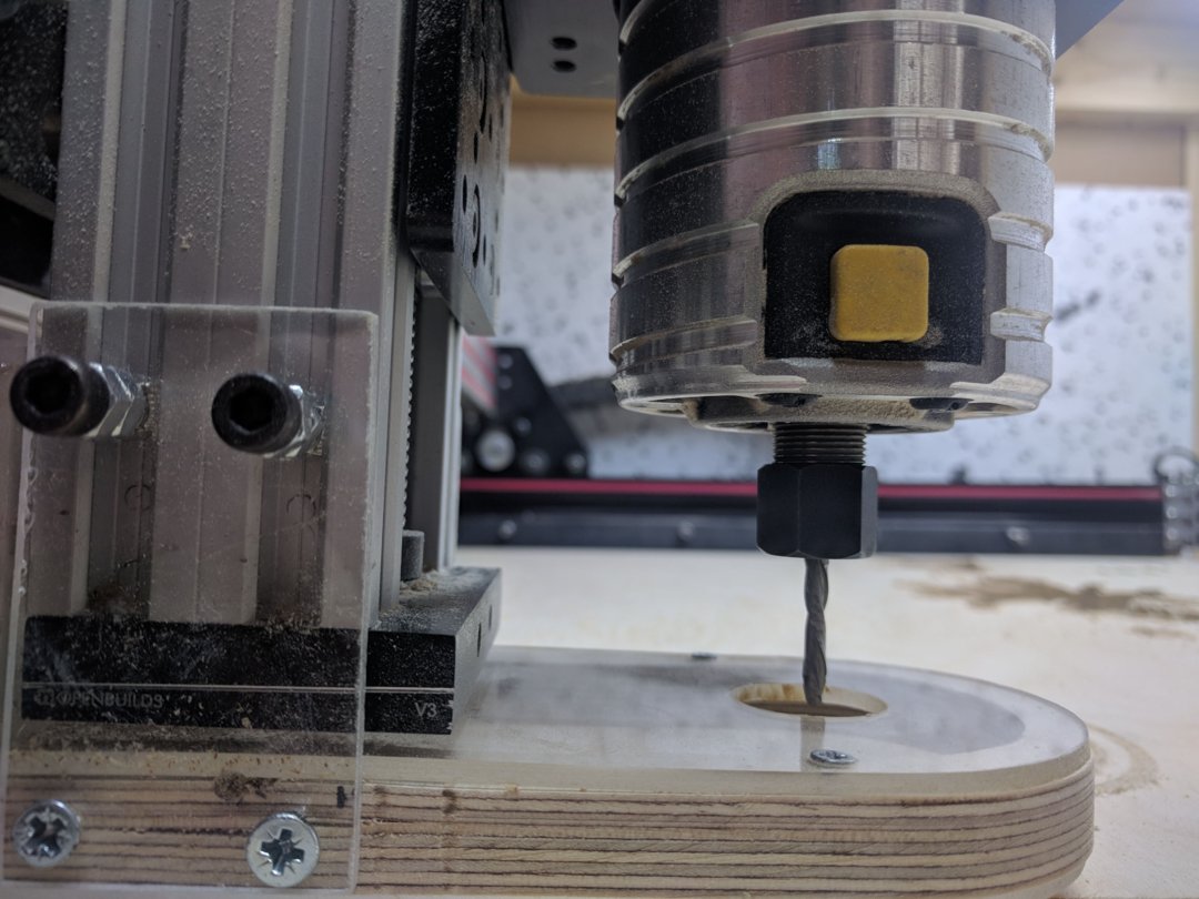

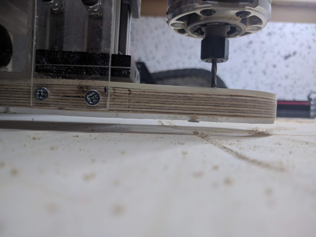

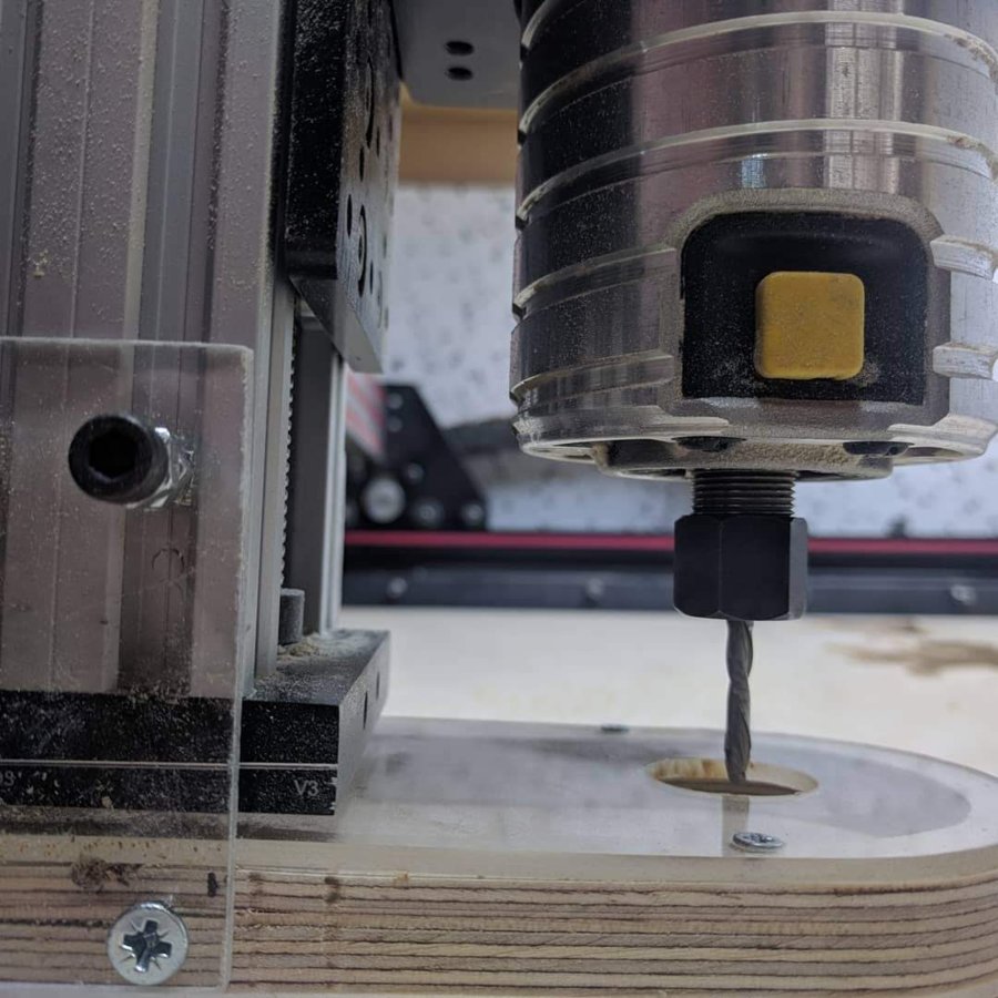

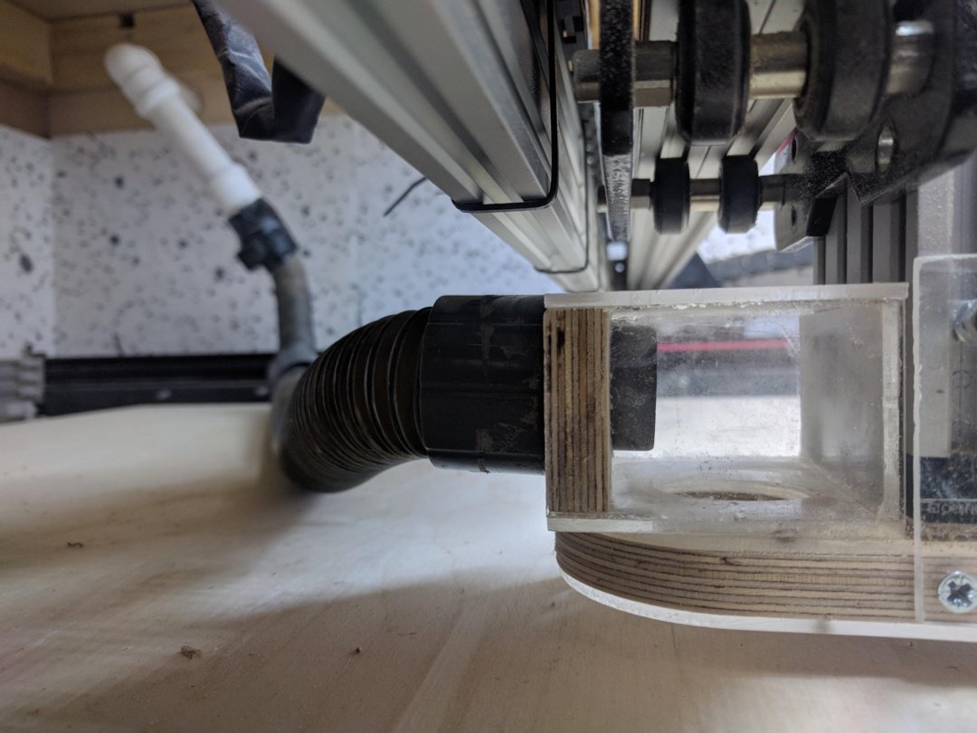

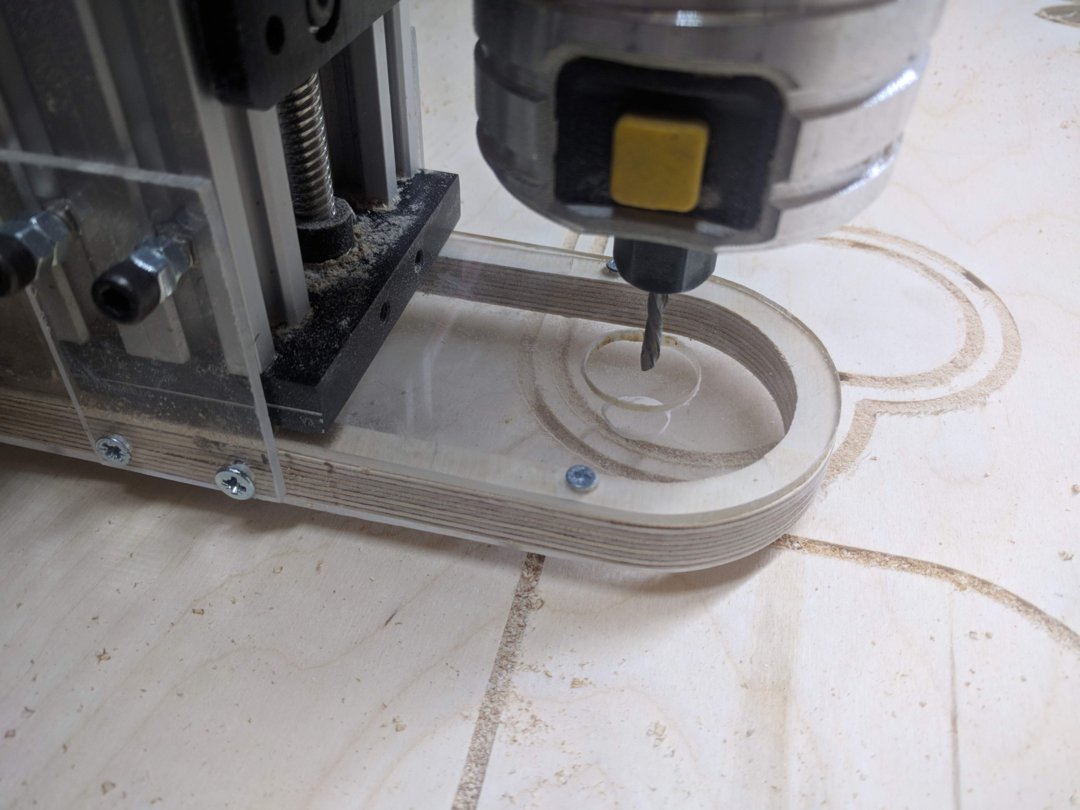

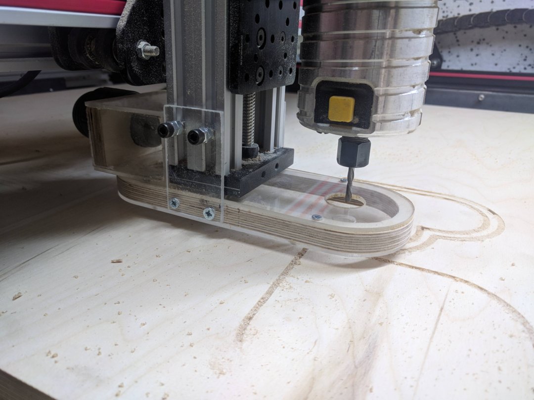

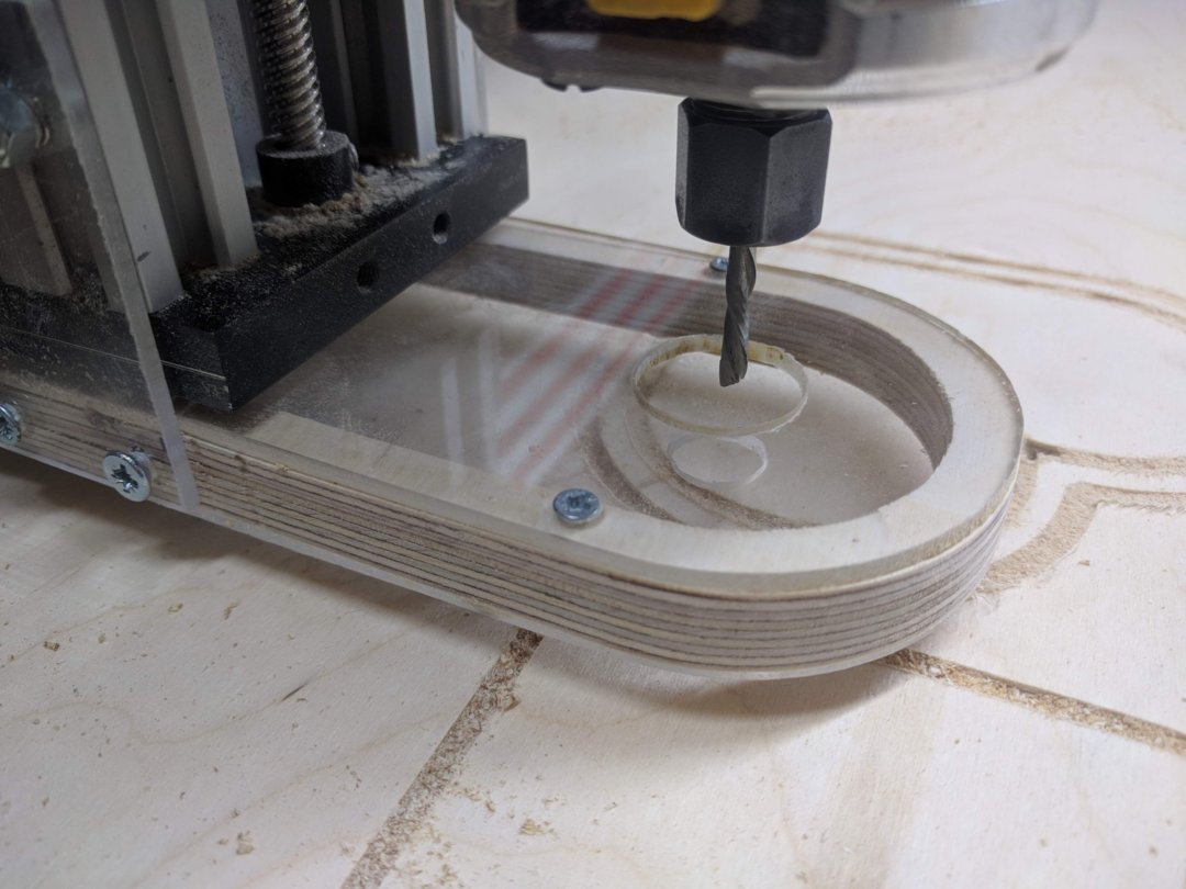

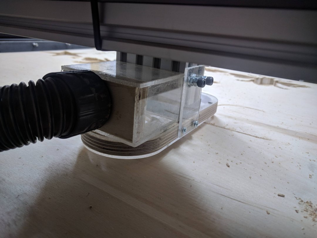

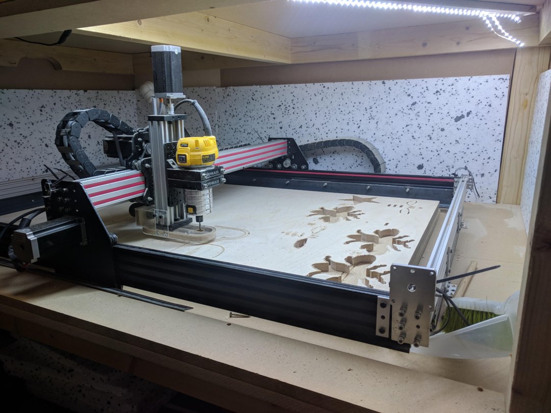

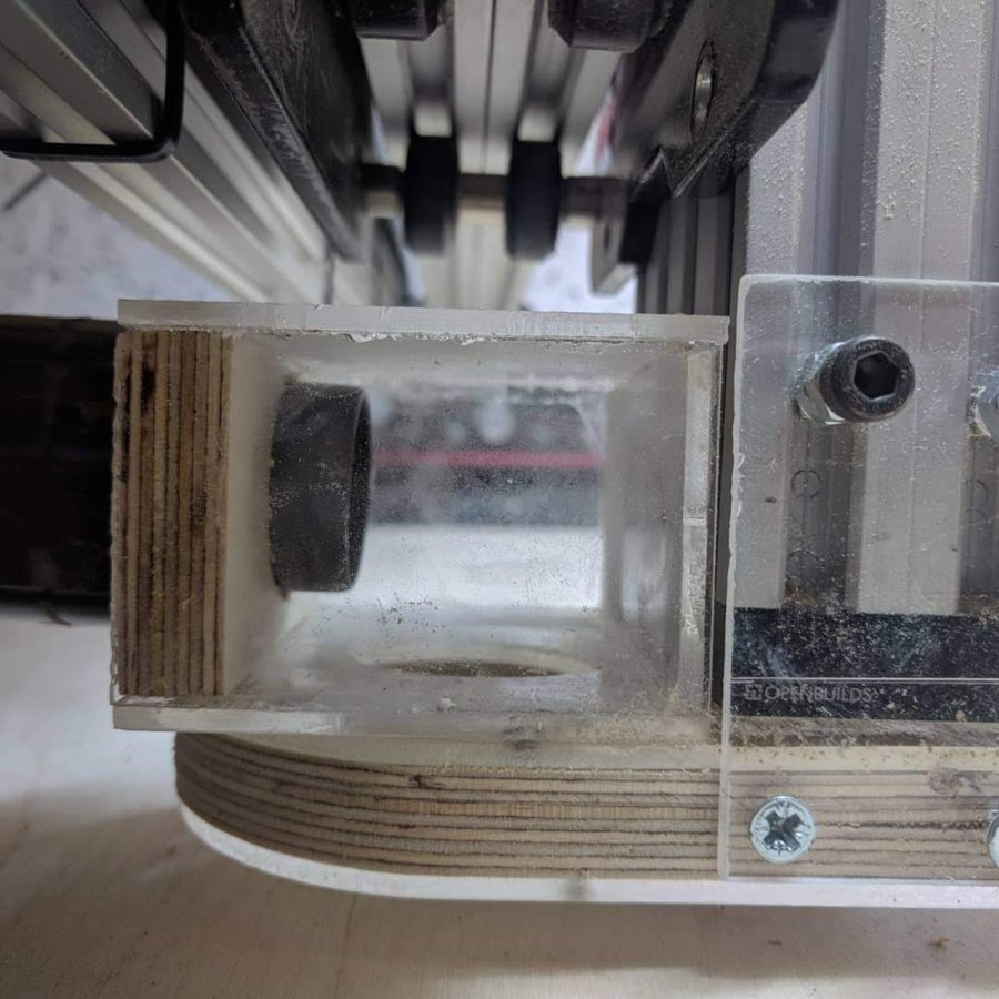

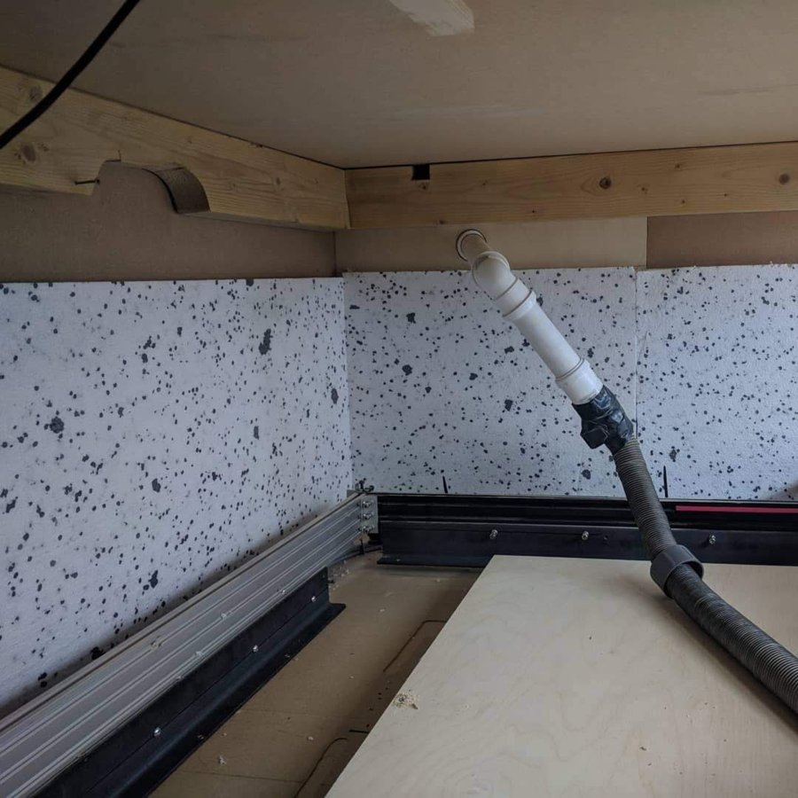

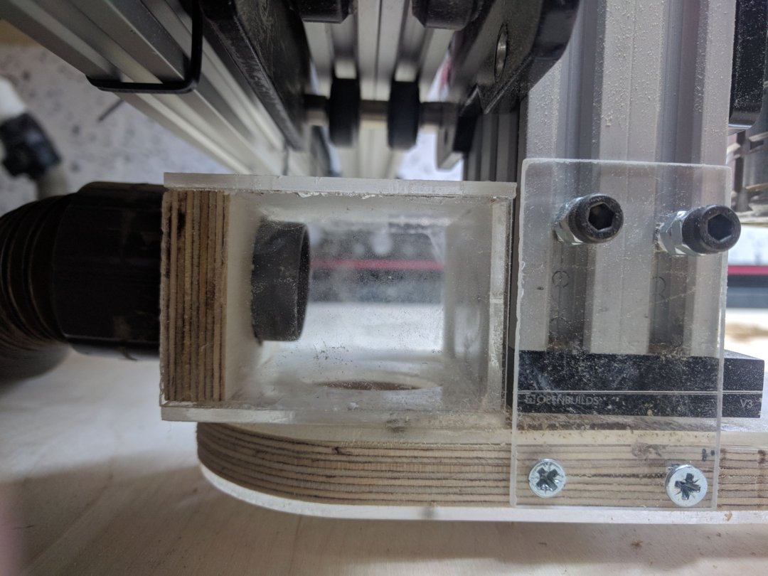

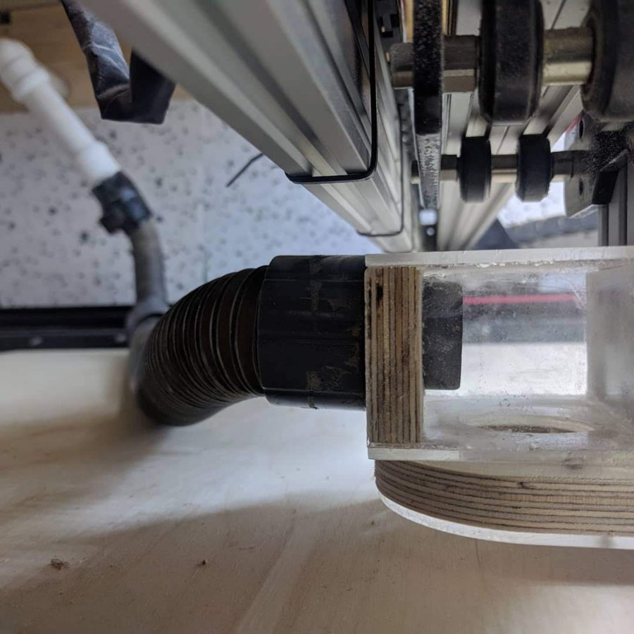

    I have a fixed.
    I mostly work with sheet material so it works for me, and I wanted something that didn't increase the footprint of the spindle. This is mostly because when I use 1200mm long sheets it takes my maximum Y travel to cut it. Same goes for X travel to a lesser extent as I have 800mm so a 3rd of a full sheet works but only with maximum reach.
    It was fairly straightforward to build - a ring of plywood sandwiched between acrylic and a box on top to take the hose. It was only a prototype as I have recently upgraded the Z axis to C-Beam (huge improvement) and it works far better than I expected.
    As the C-beam doesn't move ( i know some people have theirs mounted the other way round) the brackets on the side had a permanent location. Height can be adjusted with the t nuts.
    In another future version I'd changed these standard bolts for some hand knobs perhaps. I would also look at making the rear even smaller and make the whole thing more accurately (cutting acrylic is tricky, need more practice)

    Looks like a good, straigthforward design. Do you find that it works well even without a brush that acts as a physical barrier? Also with that small inlet hole?
    I've considered trying to duct something from the back but never found a solution I liked. It always seem to eat too much Z travel.

    Yes it works well enough without any brushes, surprisingly so. The full force of suction is concentrated directly above the cut at all times. One thing I was concerned about was whether the hole was too small but it doesn't seem to be. I only run this from a shop vac.
    As I said previously my Z c-beam is static, only the front plate moves, so the shoe doesn't move at all.
