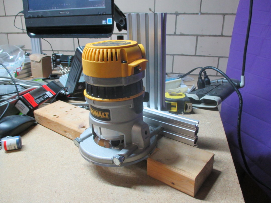

    I know first hand that the CNC bug is hard to shake!

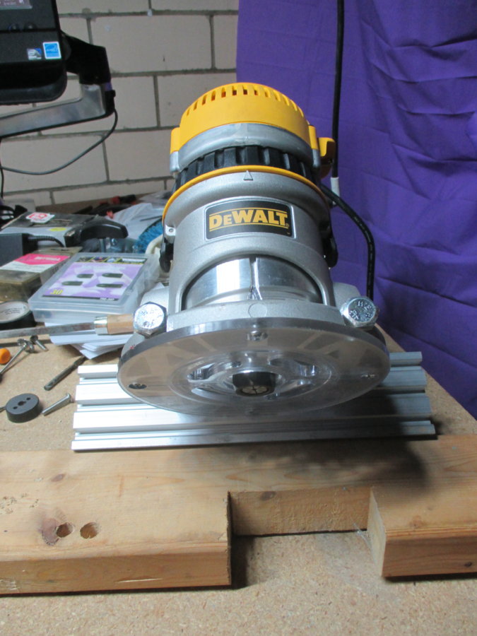

    If you don't mind me asking, why do you have such a tall Z-axis? It seems like you cut-depth will still be limited by the lower extrusion.
  3. Dave Pyatt
    Feb 3, 2017
    With 2-1/3HP Dewalt DW618 I plan on milling on 4x4's and logs. The router mount is going to be modified to allow as much Z-depth as possible... I know that I will hang up on the lower part of the router mounting...
    Chicken and egg dilemma... need mill to mill parts to improve mill... LOL :)
  4. Rick 2.0
    2,887
    1,543
    Nice design. I especially like the router mounting system. I would however suggest swapping the X-axis rails, moving the powered rail down closer to the cutter head. This will reduce the lateral leverage thus providing more power to the cutter and less sway on the vertical axis.
  5. Dave Pyatt
    Feb 3, 2017
    Only took me a few hours to figure out what you meant, Rick!
