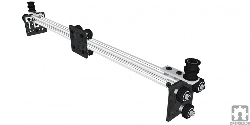

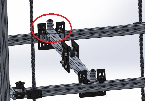

    The Notched Version keeps the idlers closer to the Vslot witch is preferable. otherwise you need to raise the other idlers higher to match with long spacers

    How long is the belt that you are using?

    Adam the rattling you were hearing was the shroud for the fan on my extruder. Also i am using a 1810mm belt. It is part 6R51M905060 from http://www.sdp-si.com

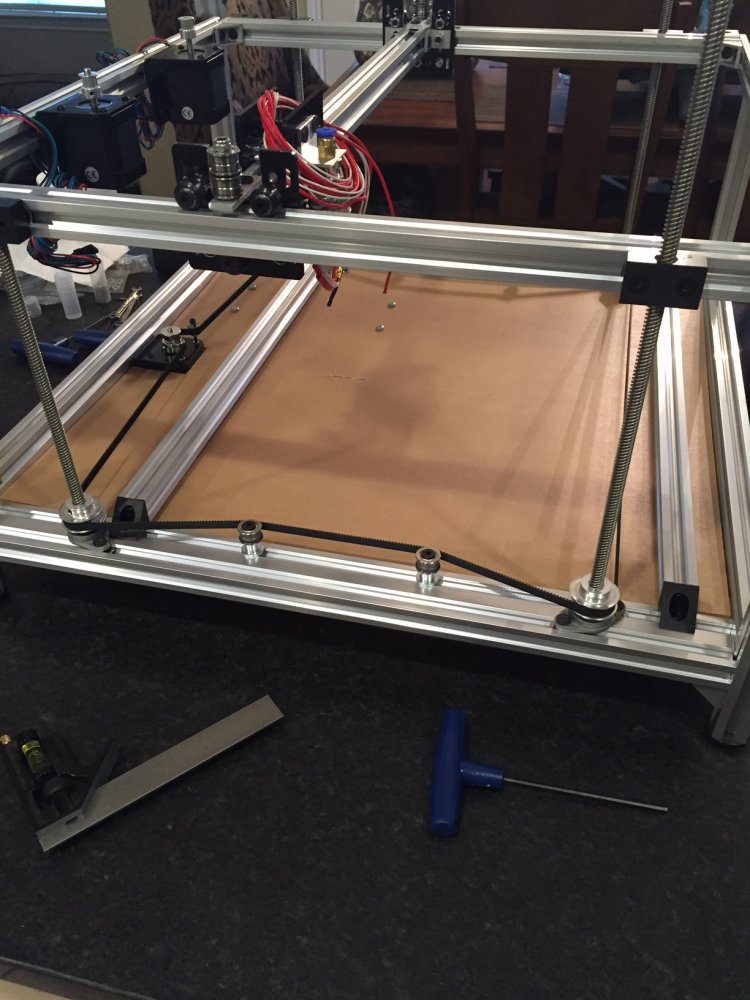

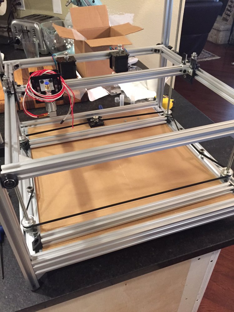

    Quite a few updates since my last post. I got it all working with off the shelf parts, but was not satisfied with the quality of prints that i was getting and the reliability of the machine. I have spent quite a bit of time designing and printing new parts to replace the bought ones. So it is possible and with enough tweaking i'm sure it would create great quality prints.
    I did not achieve my desired print volume for many reasons (knew during the design phase it was probably not going to happen). I am sitting at 330x310x350 currently. With a little more to tweak in X & Y with some new part designs eventually. But i am happy with it for now. I also decided to locate my spool inside the cube so that is a limiting factor now (could pick up 30mm with a change in that immediately) but i like it in there and it works well.
    I started with a bowden setup but was very disapointed with the leaking and over extrusion (had 700mm of tube). For this size of printer it just didn't work. I tried up to 10mm of retraction with not much gain in print quality. So i decided to sacrifice some speed for a better print quality and went direct drive. I am trying a couple different sizes of motors to find the happy medium between weight and torque. Using one that is only 20mm thick right now (13in/lb), it works most of the time but there are some skipped steps. Have a slightly larger one on the way.
    I also added some print bite and it is hands down the best modification i have made to the printer so far. ABS is now extremely easy to print with (with no warping).
    I have attached a zip file with all of the parts in solidworks along with the .igs that you requested sonya. Let me know if they don't work for some reason. One change i have made that is not reflected in the CAD files is there are 4 wheels on all of the gantry plates. I tried 3 on the Y gantry, but was getting some twisting in the gantry (some was caused by a bad tensioner design that has been redone). But, i did add 4 wheels before that and it fixed the problem.
    Added a few pictures below of its current state.
    Jezter, funny you bring that up. I did have my Z drive belt break a couple weeks back so i had to replace it. It was fairly simple, removed the front 2 bed bolts and like David said lift up the pillow blocks and slide it under. But after doing that, i will be designing some mounts for the lower pillow blocks so that the pulley will be located on the bottom. Making belt changes much easier by only having the remove the bolts on the front of the bed.
    Next is to add the plexi enclosure, i will be doing that soon. Otherwise i run it several hours most days and it works very well. Have put close to 3 rolls of filament through it so far.
