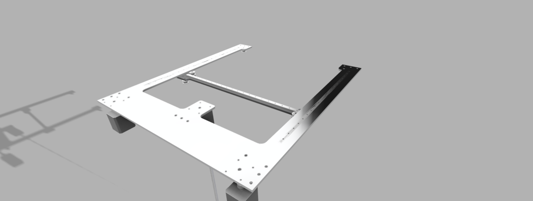

    I wanted to make things perfect so for past few weeks I have been waiting for parts from China, mainly being M3 screws and spacers, sourcing these things locally is hard and would cost a small fortune.
    Also I had to redesign both top and bottom plate, unfortunately I had not accounted correctly for the thickness of the Z axis rail, I could make compromises moving the Z extrusion further back but I then had to make even more compromises for print volume limiting the Y axis to about 270mm instead of the planned 300mm, not a huge deal but heck I have both the tools and aluminium to do it right the first time ;)
    Updates coming shortly when both top and bottom plates have been recut.
