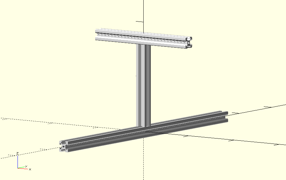

    I have been staring at it a few days now trying to decide how to mount the filament spools. Drawing a blank...
  8. Scotty Orr
    Scotty Orr Journeyman
    May 21, 2015
    315
    177
    I can't tell from your photos if the PTFE fittings on the top of the machine are fixed or moving. If they are fixed, I think mounting the spools on top, directly above and as close as possible would be clean and easily accessible. If they are moving, maybe on the back of the machine (if room) with plenty of travel length for the tubes? just thoughts. Great looking machine, BTW!!
    Here's a quick render of an idea if those are fixed (mount lower rail centered between fittings and front to back):
    #8 Scotty Orr, Nov 28, 2017

    Thank you for the idea, they are fixed at the top of the machine. The top of the machine is where I am most likely going to place them. I am just trying to get them to blend with the rest of the machine and not look like I just threw rolls on top of the machine.
