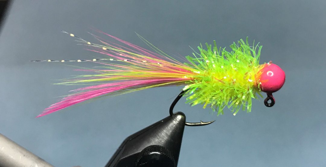

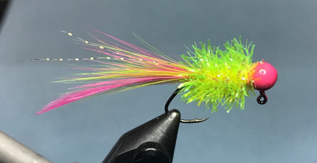

    Cool... I am assuming you have the Plate Maker. I already pour my own jig heads, but want to modify current molds and have ideas for new ones. This is example of my final product.
    Just need to place order.. doing a lot of reading right now before I pull plug. Will probably order everything Monday.
    -dan

    Cool. Looks like a steelhead jig. My cnc is my own design similar to the Ox but I used large leadscrews rather than belts. It works great on aluminum.
