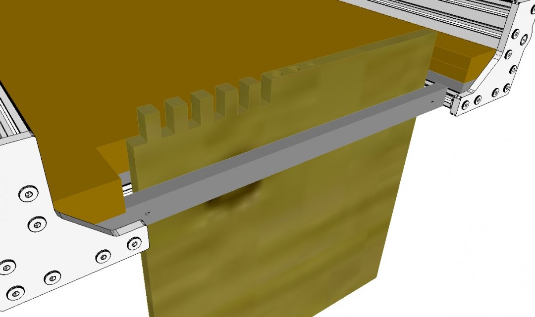

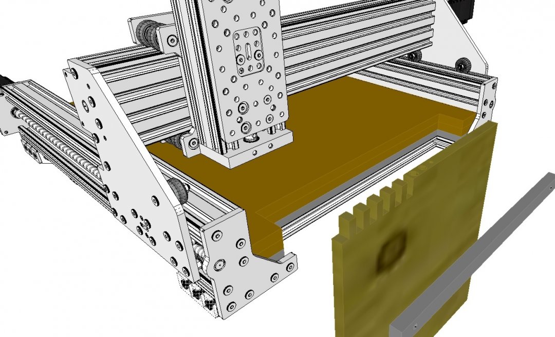

    Hi Kyo,
    Any chance you still have this drawing and can show the underside. I cant quite get my head around how you might do this.
