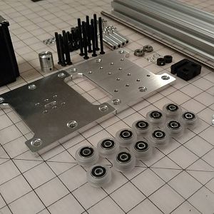

    For those who are already building this cnc; the current revision of cad files posted. There is a small mistake that prevents you from mounting the dual anti-backlash nuts on the y and x axis. I forgot to take into account the lead screw has a 8mm lead and space the mounting points accordingly. This became apparent once I started to film the assembly. You are still good to go with a single anti-backlash nut configuration. I am updating the plates to v2 that will fix this mistake.

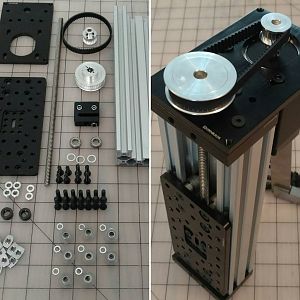

    Six Chapter build manual has been upload to the files tab. I find it really handy to load it on to a phone or tablet to keep on hand during the build. Build video has also been published. Check the "build" tab :thumbsup: I tired to keep it short without cutting out the details. I am not use to talking when building let alone to a camera lol

  22. UltiBots
    UltiBots Well-Known
    May 8, 2014
    54
    74
    @Kyo - great use of phone/tablet for build doc that follow the video. Impressive!
    Kyo likes this.
  23. MaryD
    MaryD OpenBuilds Team
    Apr 13, 2016
    649
    639
    This is a build that anyone could do thanks to your hard work on documentation. Bravo!
    Kyo likes this.

    New zip file added to "files and drawings" tab. This is revision two of the y and x axis plates to fix my error for dual nuts. Looks like I was out only by 1.5mm each nut. Not a lot but enough. The original files are still fine if you plan on running a single nut in each axis. Now that I have my machine together; One nut really does feel solid enough.
