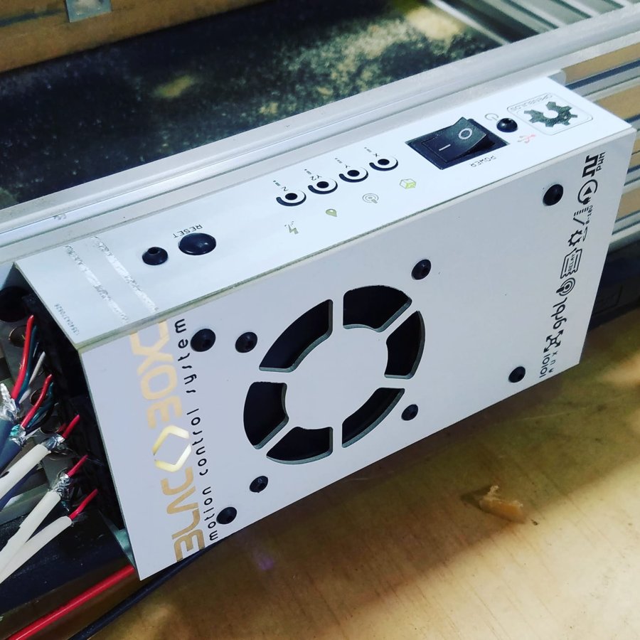

    The red light on the power supply should come on regardless of having the 24v side plugged into anything. So that tells me that the issue is with the powersupply not the BB. Double check your wiring. Make sure you have the side switch (110v - 220v) set correctly and use a multimeter to make sure you have 24v coming out of the supply. If not, adjust it.
    Once you have the power supply issue sorted, note that the 24v power LED on the two Blackboxes I've had my hands on didnt line up with the power icon on the case so it didnt look like the BB was as on. (pictures of this here: BlackBox)
