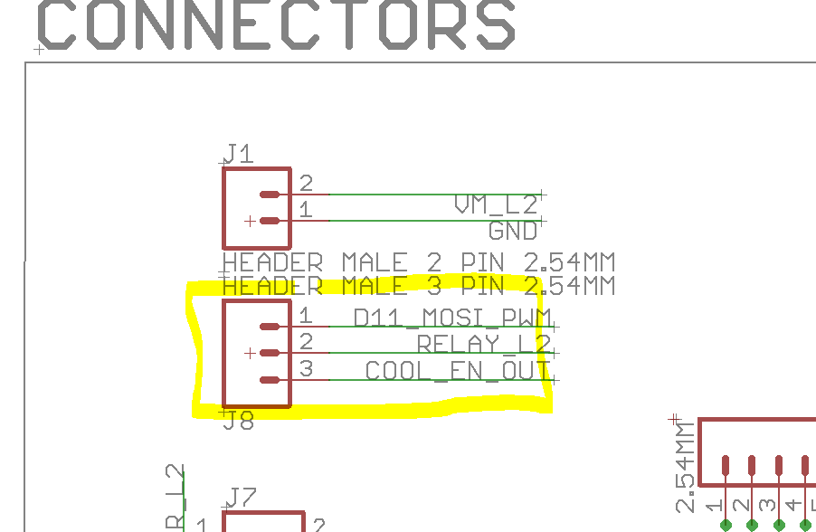

    Peter I am struggling to find the jumper for the relay output selection in the schematics.
    Am I just missing it or it really not there?
    Also, what are the relay output specs?

    no, there is a physical relay on the board that can be driven from either the spindle enable or the coolant enable pins (I did find the bit of circuit I was missing with the jumpers :).
    I have just watched the assembly video carefully and I see it is marked 10A 250VAC (the relay is blue) . I will have to check my vacuum ratings, IIRC it is 2000 watts which is over 9 amps at 220V, too close for comfort. I will have to look at an external relay and that 24v output is just perfect for that. I will use the relay for the Makita spindle instead.
    13,753
    4,070
    Checkout J8 under the Connectors section of the Brains schematic
    Relay specs: SRD-05VDC-SL-A
    See attached Datasheet. In terms of PCB layout, its not officially designed for Mains (clearances etc)
    I'd recommend taking the 24v output from the Coolant header (mosfet inside, 5A) and running that output to an IOT Relay (for folks in 110v land) or a SSR/Contactor (in 220v land) instead - SSR will help, optically isolated

    thanks Peter, I did eventually realize what I was looking at (-:
    thanks for the clarity. I think an SSR is just the thing for this. especially since I already have a few.

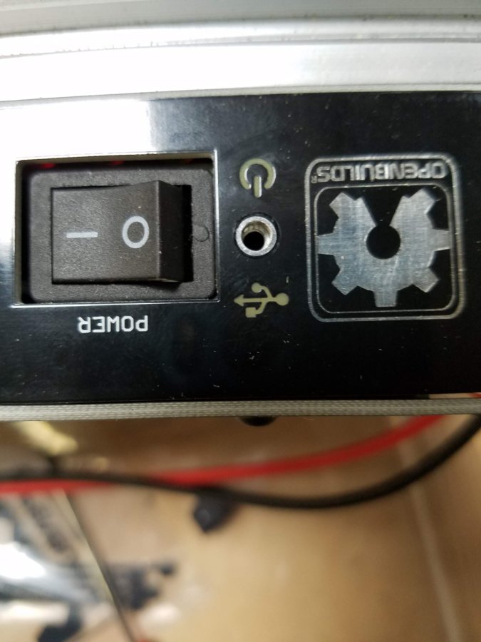

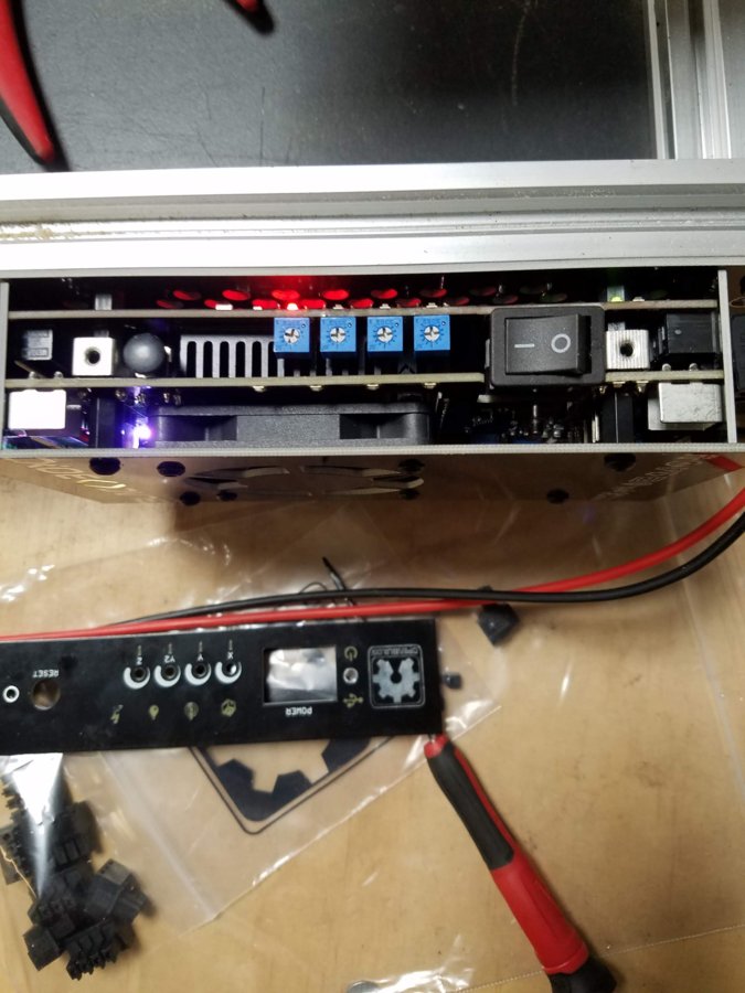

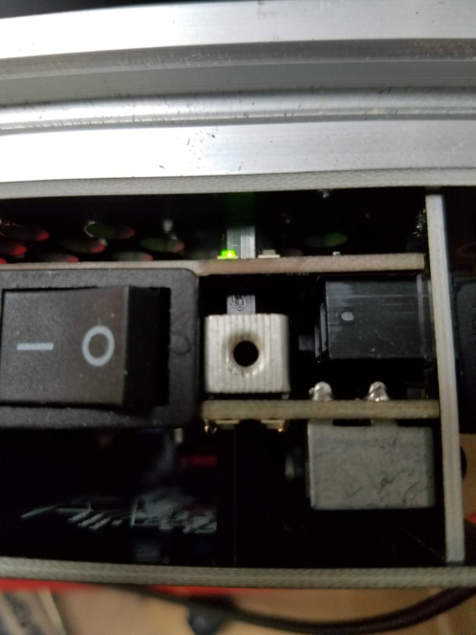

    Got mine yesterday. What do the status LEDs on the motors actually mean? I thought I saw it discussed recently but couldnt find the post. Nothing in the docs either.
    Anyhooo, I have one motor connected to X. The Z led is red. X, Y and Y2 arent lit. X motor isnt energized. I have double checked the connections with a volt meter. If I plug the motor back into my DQ542MA it works fine.
    I have verified 24v at the xconnector. Fan comes on. Power LED doesnt light up when the power is on. EDIT. I took the side panel off an one of the green LEDs for the power does light up. You just cant tell with the side panel on because its too dim (because there's only one lit?)
    What else should I check?

    Hey, that one red warrning is a potential problem reach out to http://support.openbuilds.com/support/home and they'll sort it out in no time
    Will add a icons page to the FAQ tomorrow for you
    Check that you have a machine profile loaded. If not, at least set $4=1

    I did forget to change $4=1. I had just copied my settings that I used with the arduino and dq542mas. So, after changing that, the Z led isnt red anymore, but now the Y2 one is. Still no power to the motor. I do now see a light for the stepper motor icon which I dont think was lit before.
