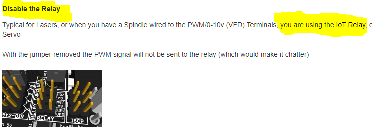

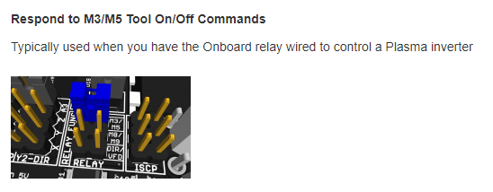

    So set the jumper as shown below and use w M3 & M5?
    Also - How do I access the jumpers? Just unscrew the cover?
  7. Tarquynn
    Tarquynn New
    Mar 27, 2019
    Popped off the cover, relay's already in the position above. I'll give it go and see what happens.

  16. Giarc
    2,923
    1,620
    I did nothing to the jumpers. There is nothing that I could see in the instructions I linked that mentions doing anything to the jumper. The 1 minute and 30 second long video shows everything you need to do.
