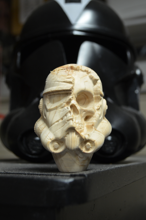

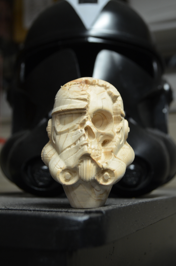

    I have tried other software and honestly, Vectric Vcarve Desktop is well worth the price. If you ever want to upgrade to VCarve Pro, you just pay the difference in price. I can import an .stl file into my work stock and have the tool paths generated in under 5 minutes now that I have done a few. Here is a recent one I did to make a beer tap from an .stl file I found here: 3D Printable Star Wars Death Trooper by Paul Braddock

    This looks great, @Giarc . Curious, do you use pro or desktop and why? For the storm trooper head how many toolpaths did you use for one side? I'm considering jumping ship from Fusion just for the simplicity.
  7. Giarc
    2,921
    1,620
    Desktop. I did not think I would need to cut larger than the 25" restriction. If I do need to, I can use tool path tiling. I figured I can upgrade if needed for the difference in price.
