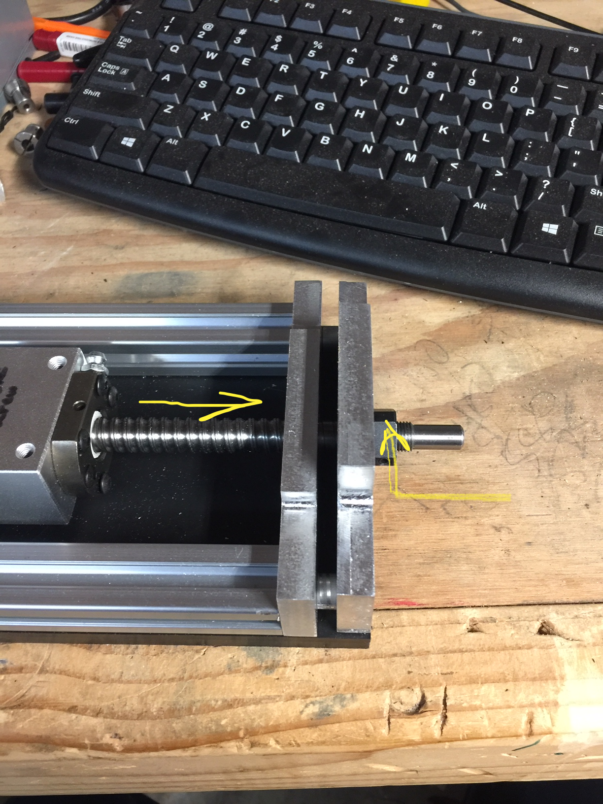

    Corey Corbin published a new build:

    Neatly done, noticed the sign on the mounting block, know all about loosing balls. The is a newer system that doesn't have that problem as well as covering flexible rubber boots to keep dust out.

    lol! YES! I did that cause of the kids. I had it sitting on the table and I was worried they would start messing around with it. Take things apart and see how it works. Newer system? Do you have a link?

    Looks really cool! Why the double plate on the motor side?

    Well so on the ball screw to that upper area has a 23mm of surface that the original bearing carrier had to cover. SO the top inner plate holds the screw tight against the bottom plate and the top plate holds the stepper motor with the nut with grub screw tight. So the thought was as i tighten the nut it would bring the screw in to the upper / bottom bearing holder and keep it from slopping around.. That's the goal.
