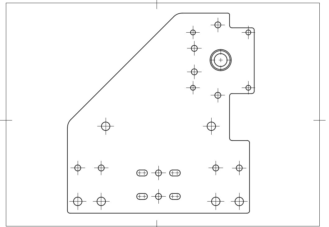

  22. Kyo
    Kyo Veteran
    Feb 27, 2014
    673
    700
    The Sphinx plates can be made from mdf, plywood, steel , 3d printed , aluminium , ect. with success. In fact we have had builds with all of the above.:thumbsup: Just use what you have, you can always use the machine to make new parts down the road.
    Rick is correct the external shape can be as simple or as complex as you want to make it. Bolt lengths may need changed if you differ from the 1/4" designed plate thickness. Using the hardware listed in my B.O.M here are the important measurements in addition to the wheel and nut block location holes taken care of when using a template.
    Plate Thickness: 1/4" / 6.35mm (all plates)
    Bolt Head Recesses: 1.6mm (front and rear x-axis plates using OB hardware)
    Bearing Pocket: 16.1mm dia x 5mm deep pocket with 18.1mm x 1mm deep flange (front, rear, side y-axis plates)
    To layout all the major holes (wheels, bearings, nut blocks ect.) I print off a pdf template and center punch each one before drilling. Here is a preview of my templates.
    Here is the link "Here" to the pdf files I posted for the sphinx plates. The pdf files are sized 1:1 printable on a4. You can export the plate outline for use with any printer size you have access to using the fusion files or export postscript files directly from the original sketchup file. See one of my old videos "Here" I go over the sketchup export option.
    One of the great things about sketchup is the measurement tool. You can use the circle center points to double check measurements on your printed templates vs the original cad file.

    ok on the pdf files do I just print them out or do I have to change something?
  28. Kyo
    Kyo Veteran
    Feb 27, 2014
    673
    700
    If you have a A4 printer, yeah just print them out. Make sure your printer is set to 1:1 or 100% ect. each printer might use different terminology but the pdf's are full size so any scaling can skew the dimensions. If you don't have a A4 printer most libraries or offices paper places should. A4 is larger then regular us letter (A4 = 210mm by 297mm US-Letter = 215.9mm by 279.4mm). The plates will fit on a household us letter printer as well but new pdf files would need created.
    If you need the pdf files for a us letter printer let me know and on my next free day I will draw them up for you :thumbsup:

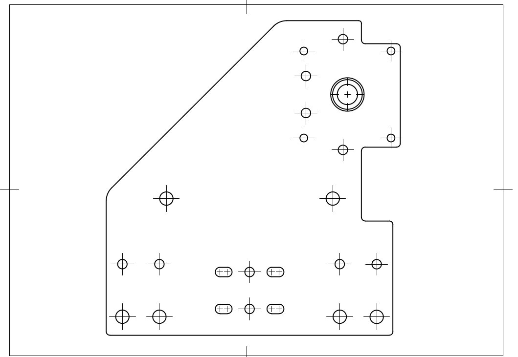

  30. Kyo
    Kyo Veteran
    Feb 27, 2014
    673
    700
    Here you go David. This should simplify things a bit. I have completely redrawn the Sphinx cnc plate printable template set for standard us-letter paper and printers. You no longer need to worry about having A4 sized paper or a machine capable of printing it. I am so used to A4 paper I did not consider the confusion it may cause.
    I also added in some center to center dimensions on each sheet so you can manually check that the pages printed off correctly and to scale without having to open any cad software (fusion / sketchup) I have confirmed dimensional accuracy and printability on several printers tonight. You should be good to go.
