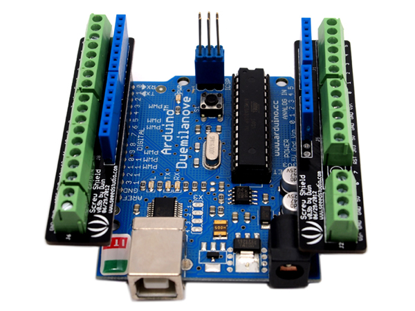

  3. David the swarfer
    3,288
    1,837
    snokid and billydl like this.
  4. Mark Carew
    2,746
    2,412
    Really nice job on this tutorial video @Kyo :thumbsup:
    You really hit the nail on the head with this as we have been needing a simple explanation style video that helps Builders to understand how to connect the drivers.
    Thank you so much for taking the time to create and share this.
    @David the swarfer these are really cool! I didn't know about them, thank you for the share.
    Mark
